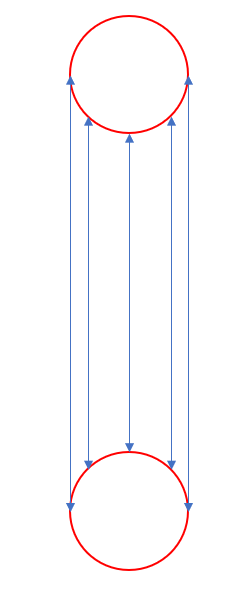

Alberta is neat, since Alberta is a straight line, so the cities generate way more traffic between them than if they were in a grid. From 2021:
There is some in the economic reports the province did in the late 2000s.
The main thing to visualize is most of the USA is in a grid. So urban-urban trips are generated in all directions between all centres.
4 cities in a grid, 1 million each. Think of each arrow as 4,000 trips each day, each direction.
In Alberta due to our relative isolation from other centres, our relative prosperity for a long time (running what may have been close to the densest air service on the planet in the 70s between the cores of each city, building a 4 lane highway decades before it was 'needed' to speed up travel significantly), and the development of specialization over time we have much stronger links.
Even if only 70% of trips are now taken due to a variety of factors, we have this instead:
I've heard this from time to time (not just from you), where Calgary-Edmonton have some crazy outlier of demand. And I've been wondering if this is one of those stories that people tell because they've heard it from other people, repeated from civic booster to politician, but there's not any actual underlying facts. So I decided to dig into it a little. The federal government does a survey of intercity travellers, called the TSRC. I happen to have some old data kicking around (2011,13 and 14). I looked at all of the trips in Canada that were between CMAs (bidirectionally, so I'm adding say Winnipeg to Thunder Bay and Thunder Bay to Winnipeg together for a single point).
It seems pretty logical that the travel from a city will scale relative to the population in that city; we'd expect a city of 1 million to produce half as many trips as a city of 2 million people, all else being considered.
And the attractiveness of a city as a destination might also be relative to the population in that city; again, as a naive assumption, let's assume it's related to the population, where if somewhere has two cities at equal distance and city A is half the size of city B, we'd expect city A to get half as many trips as city B.
With those, we can calculate the trips per capita in the origin per person in the destination (or to have a better scale, per million people in the destination). So a value of 1 here would suggest that if the destination had 2.5 million people, then we'd expect 2.5 trips per capita from the origin.
Basically here, I'm reinventing the classic gravity model from first principles; to top it off, let's plot the square root of the distance (i.e. 1/distance^2). Here it is:
There does seem to be a broad relationship, although it has a handful of big outliers. Most of the points are very close to 0, but the trend broadly continues as you get close to the x axis; here's the same thing with a log y scale

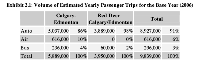

There is some divergence data wise, with the TSRC having 1.8, 1.9 million trips between Calgary and Edmonton.
Instead of a survey, the province installed license plate cameras to attempt to capture all auto trips for selected times (this was harder to do with the technology of the time), and then worked with schedules and surveys for bus companies and air travel. This was done to reduce fears that while AADT was high, trips that traveled between CMAs was low, and to compare available seats versus occupied seats.
Here is the model that the provincial data collection yielded for 2006:
Here is 2005 AADT, more just for interest sake.
It is quite something that no study used by Alberta transportation had demand anywhere close to as low as TSRC:
There's a lot of reasons for differences. The biggest one is that I was using a measure of household trips, not person trips. About 40% of the trips were by one person, about 30% by two people and about 30% by 3+ person parties, bringing it much closer to the numbers you have here. The TSRC is also a tourism focused survey, so it does not include regular work commuting and other routine trips like shopping, medical appointments, moving, religious observances, funerals and so on - this would affect Red Deer travel much more I suspect. I was interested in comparing between places within the survey, where these exceptions are all consistent; it's definitely different when comparing to external data.
A license plate survey on the other hand includes extra trips; someone driving from Calgary to Fort Mac or from Edmonton to Phoenix would be included in the count, even though they are not travelling from Calgary to Edmonton. (For that matter, someone from Okotoks or Strathmore to Edmonton - who would plausibly be in Calgary-Edmonton HSR market - are excluded from my TSRC numbers because of the CMA definition.) It could also include (depending on how it is done) trucks, buses, RVs, etc - about 20% of highway 2 traffic volume away from the cities.
I'm also not sure whether the air number in your table includes total passengers flying Calgary to Edmonton or actual Calgary to Edmonton air passengers; there's a lot of YEG flyers making connections here. In the late 00s YEG had ~5 million domestic passengers enplaned/deplaned; it seems a little surprising that over 10% were only flying to Calgary. Expanding the TSRC to person trips, I got 4.1M by car - 80% of the license plate count and 400K by bus; 1/3 higher but certainly a very similar order of magnitude. But the air passenger trips were 130K, only about 20% as much.
