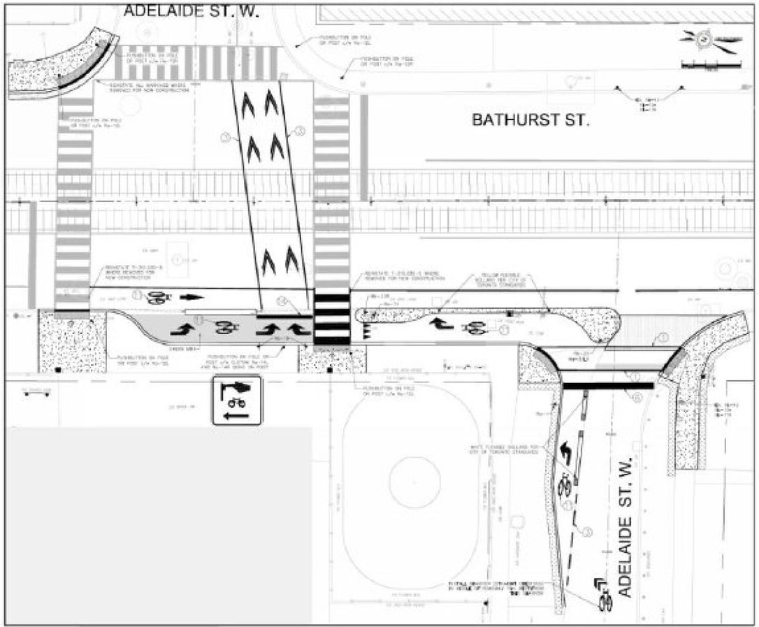

I wonder what that would mean for the Bathurst/Adelaide section, which just finished its reconfiguration to support the bike lane connection:
This design isn't going to accommodate southbound left-turning cyclists on Bathurst, who will either have to stop right in the bike lane or pull forward just to double back to the other side of Adelaide. Is the city going to tear this up and reconstruct it to move the bike waiting area north? I am annoyed that nobody thought about this a year ago!

I agree that it would have been nice if they thought of this sooner. However, looking at it I doubt they would have to tear any of it up, just extend it a bit further north to allow southbound turners to have a bit of queueing space. The northbound cyclists from the other Adelaide would just have to bike a bit further. The only other change may be to extend the curb in the intersection to close the opening cyclists currently use as an exit.
Excellent posts. Glad to see others asking questions, some of which should have been asked with the partly botched slip lane Adelaide/Bathurst. Discussing that in detail and reposting diagrams got me banned for two weeks from the forums. Torontonians with some exceptions (@smably was one who questioned the rationale at the time) are far too accepting of imposed dangers, and then ban others from pointing out the absurdities.
The concrete median was called for in the design, even the underpinnings are in place, but the median itself, which could have included a railing, was never built so as to (gist) "allow funeral vehicles to park in the slip".

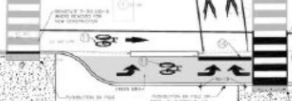

Moving the cycling lane on Adelaide to the north side may or may not be a better idea, that's open to the type of discussion we're having here, but it's *totally contingent* on protecting cyclists from all the downsides of contra-indicated traffic priority. Motorists are lax enough as it is when the cycle-lanes are on the 'right side'. God only knows how much the risk will skyrocket when they're on the 'wrong' side.
Could they botch this up? They certainly did with the slip path at Adelaide and Bathurst. Of course, they could always defend their logic by stating how safe we'll all be and how we'll have preference when we're dead.

This green area outside St. Mary's Church at Bathurst and Adelaide Sts. is supposed to offer both hearse parking and protection for cyclists. (EDUARDO LIMA / METRO NEWS)
The $550,000 project at Bathurst and Adelaide Sts. sits directly in front of St. Mary’s Church, which has hosted funerals for more than a century.
Consultations with the church and the cycling community led to the concession, in part to allow hearses to park out front.
