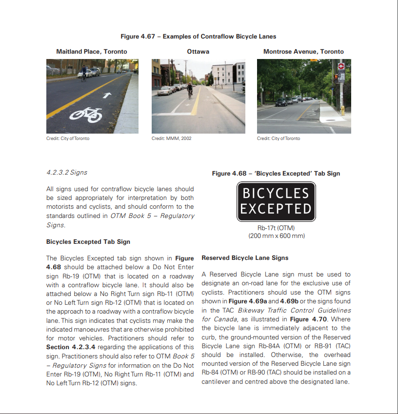

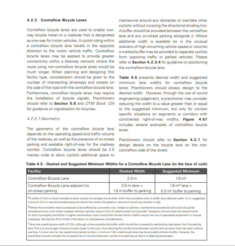

http://www.raqsb.mto.gov.on.ca/techpubs/eps.nsf/0/825810eb3ddd203385257d4a0063d934/$FILE/Ontario Traffic Manual - Book 18.pdf
