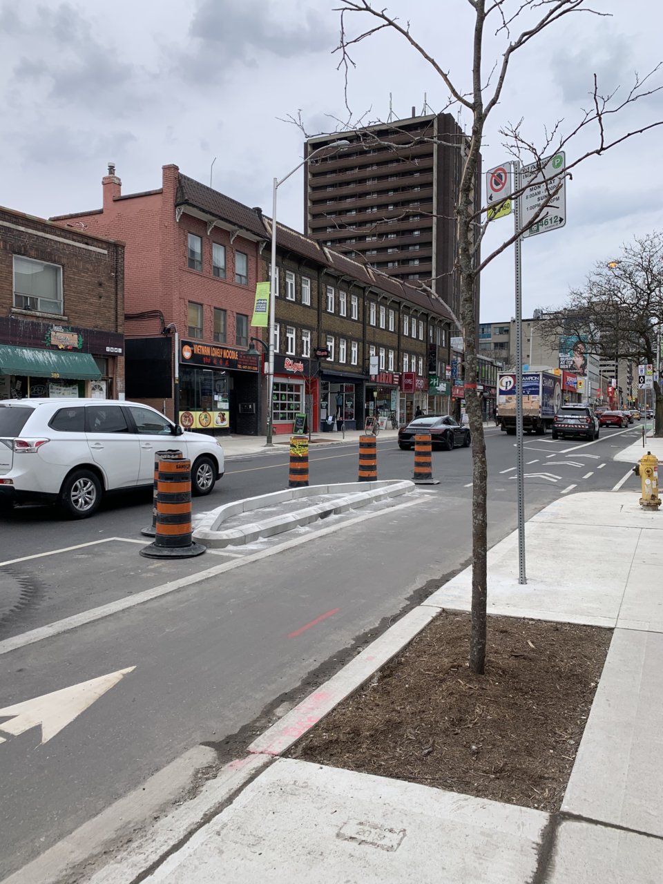

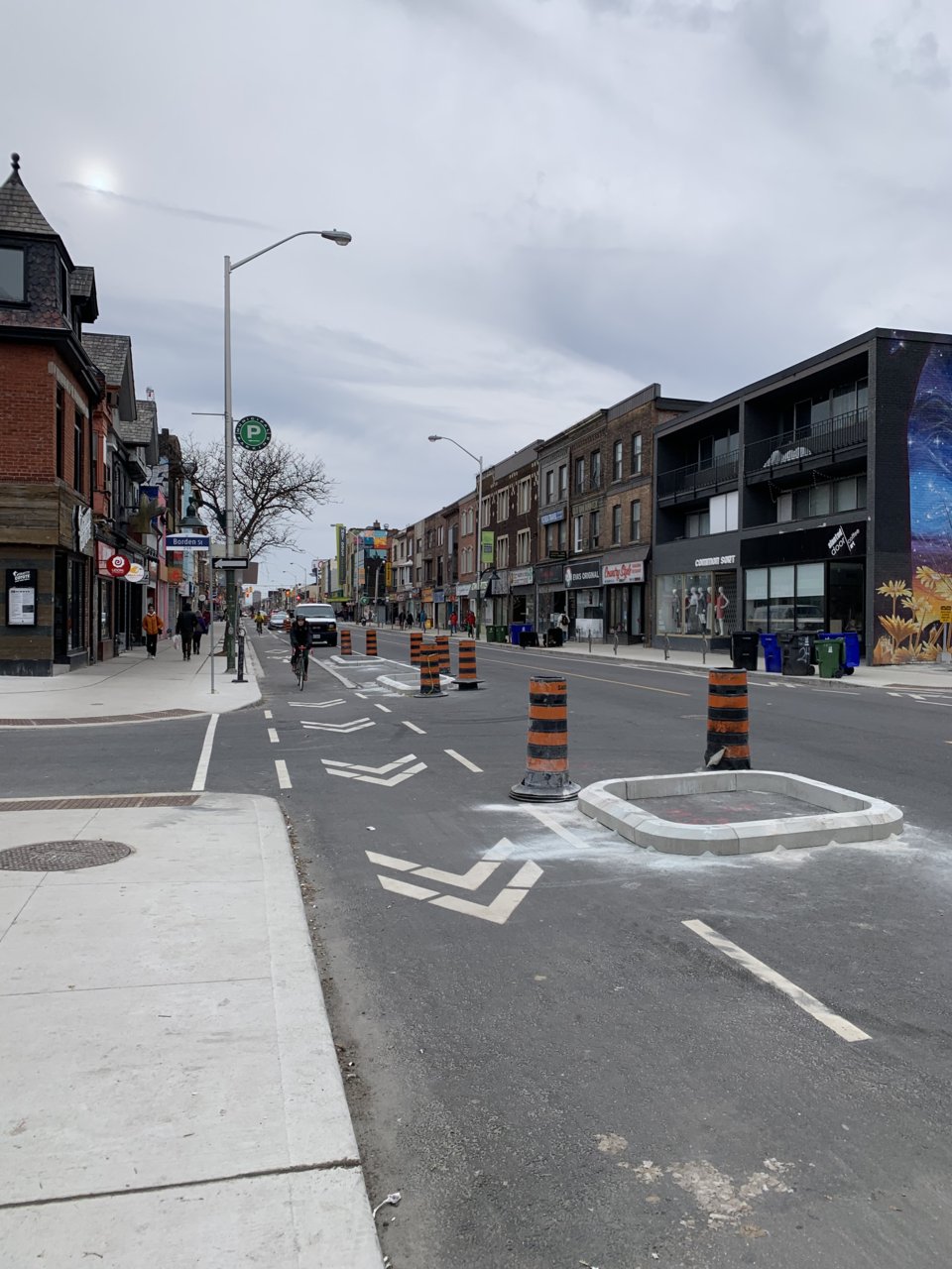

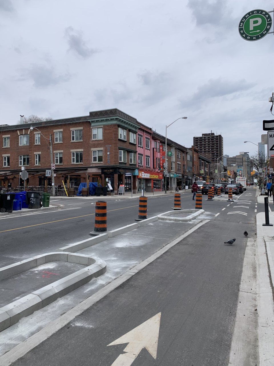

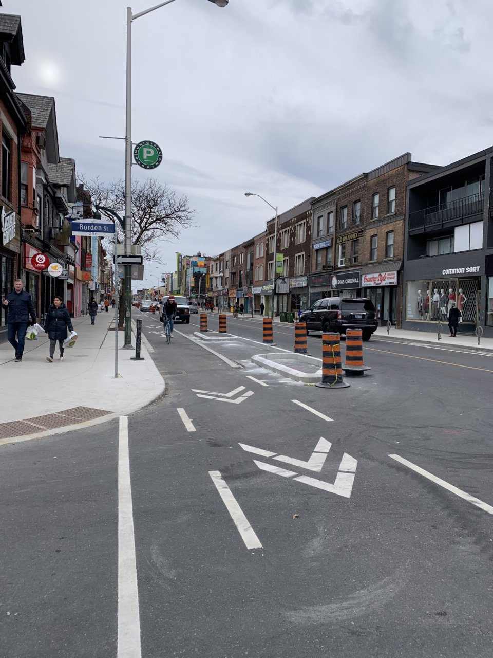

The extra curbs they’ve added to the Bloor bike lanes between Bathurst and Spadina are a huge improvement — they’ve targeted places that had quickly become nearly constantly parked-in by drivers since the reconstruction and, in some places, have also managed to further tighten the turning radius to slow down drivers and make their turn across the lanes safer by changing the angle at which they cross.
(I don’t know why it took them a number of months from “completion” to implement the added necessary infrastructure but I am nonetheless quite glad they did.)
Some very nice steps towards creating further visual/psychological separation for bike lanes and stopping drivers from assuming that it's 'just another lane' (drop a few more in, and it becomes increasingly hard for drivers to swerve in for a stop).
I wonder if there's been any studies on the effectiveness of these selective bike lane separations compared to the ideal fully-separated bike lane?
Agreed, they are really nice. If only the other side wasn't a narrow unprotected bike lane, there's quite the contrast. I'm waiting for the day when parking is fully removed on that stretch, and the westbound bike lanes can be widened and protected.
