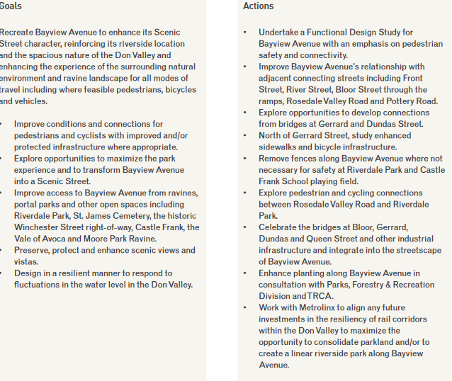

Its been a while since I asked anyone where this was at...............but in 2018, the plans under discussion looked like this:
Recreate Bayview Avenue to enhance its Scenic Street character, reinforcing its riverside location and the spacious nature of the Don Valley and enhancing the experience of the surrounding natural environment and ravine landscape for all modes of travel including where feasible pedestrians, bicycles and vehicles. Re-harmonize Bayview Avenue’s relationship to the ravine landscape by prioritizing the health of the ravine’s ecological systems and providing protected active transportation infrastructure along the corridor.
The public report on all that is here: https://www.toronto.ca/legdocs/mmis/2018/pg/bgrd/backgroundfile-114385.pdf
I can't say what the current state of this project is; but it was my impression that the railway bit was only very high-concept and hadn't moved very far...........
While some other bits had been looked at much more closely.
