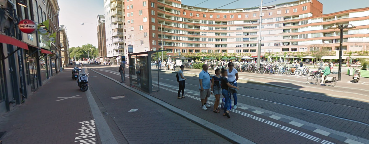

I would add, w/o judging your idea in the least, that I think its important to compare this design w/the baseline alternative, which is a bus pulling over and blocking the bike lane, or more challenging vehicle boarding/alighting for passengers from transit vehicles away from the curb, w/passengers stepping down into the curb/bike lane.
It's the standard approach in the Netherlands.
An example from central Amsterdam:
Sometimes the shelter/signage is also on the other side of the bike path with the small unloading/loading platform being even narrower.

The bus stop area I showed looks to be about 2.2m wide measuring on Google Maps, so it actually would comply with our accessibility rules, or would comply with a few minor adjustments.
As for the bus shelter, obviously a shelter in Toronto needs to be more substantial than one in Amsterdam, and there is no reason why the shelter couldn't be made larger with the same layout. The shelter can also be placed on the other side of the cycle track if necessary.

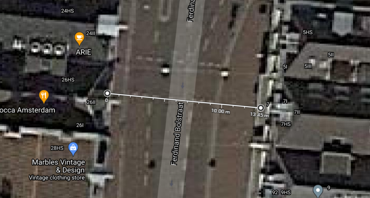

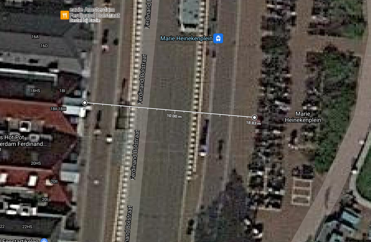

That tram stop in Amsterdam is on Ferdinand Bolstraat, a very narrow street significantly narrower than any relevant Toronto street. The typical distance between building facades on that section of Ferdinand Bolstraat is about 14m, so narrow that the tram is single track. Where this specific stop is located, there is a square off to one side and the street widens a little bit in order to accommodate this tram stop as well as double track, to about 18-19m measure from building facade to the bicycle parking on the other side:
Roncy is about 19-20m between sidewalk edges and building facades, which is wider than that street in Amsterdam even where it widens into the square to accommodate the tram stop. Christie is similar at about 18-19m and in fact pretty much all major streets in the older parts of Toronto have a 20m ROW, and in most cases the sidewalk goes right up to the edge of the ROW or really close, so they're all basically the same. And, in most cases the stops will not be directly across from each other like on Ferdinand Bolstraat, they are staggered on opposite sides of an intersection, freeing up even more ROW width which can be added to sidewalks or used for street furniture or trees/plants.
View attachment 357529View attachment 357530View attachment 357531
