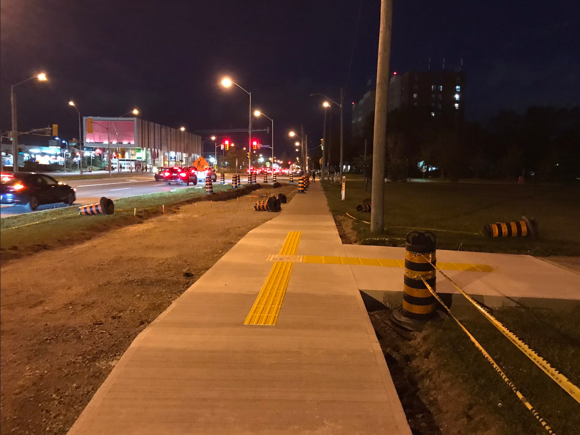

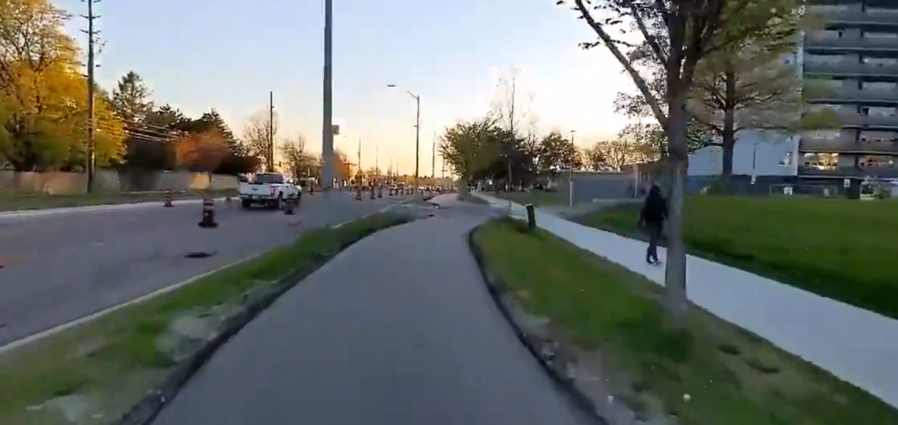

For reference (sorry for the low quality):
This recently installed trail on Ellesmere west of Golf Club Road (supposedly the highest standard,) is a stub trail that extends the current meadoway trail by about 700 metres. It's actually high-quality, nice width, green markings, bike signal and even an island bus stop. It unfortunately abruptly ends at a random driveway east of Markham Road and then cyclists are riding on the sidewalk again.
What good is a fancy new trail if it ends before it needs to, and what good is a trail if I have to illegally ride on the sidewalk 90% of the way there.
This is the main problem. City staff take pride in high-quality but stubby infrastructure. And it shows, just look at the plans. A few stubs scattered and a few major routes that have been in the plans for decades like Kingston, Sheppard, Victoria Park and Brimley that still need additional planning apparently.

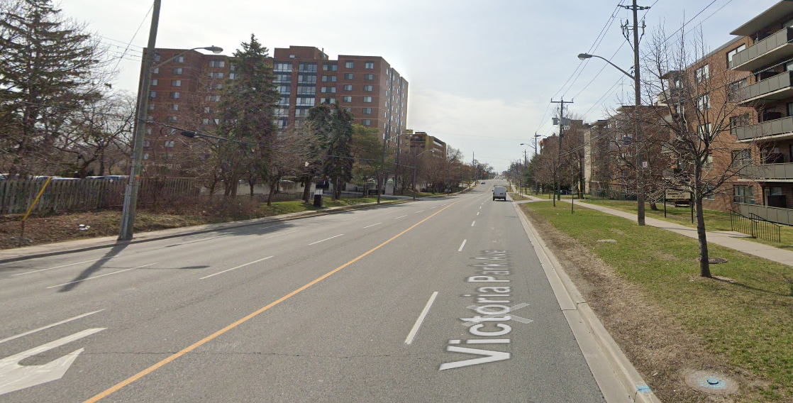

Lets look.
Victoria Park, north of Eglinton, typical profile: (looking south)
You'll notice immediately that there is no boulevard on a portion of the eastern side of the road
But what about the boulevard on the west side? Its a whopping 5.4M wide, so there's lots of room, right?
Not so much.
Look at where the existing trees are sited. Roughly in the middle (slightly closer to the sidewalk, just fractionally).
So, if you paved right to the tree, from the curb, you have about 2.6M But that would kill the tree, you can't pave that close.
You have only only 2.4m on the sidewalk side If the trees grew to a healthy size, it will also eat about 0.3M on each side, just in the in the size of the trunk.
So, how much room do you have? Curb inward, I would say about 1.5M Sidewalk outward, about 1.3M
That's a very narrow boulevard, and assumes no separation or barrier at the road, or the sidewalk.
* note, that if the trees did grow to a healthy size, their roots would like heave any trail within 2M of the tree eventually; though, you'd probably have 30 years to go before that was an issue.
Want to make it more complicated? The sidewalk does not meet current minimum width standards here, its ~1.95M and it should be 2.1M
That makes it even tougher. Can you move the curb to subtract excessive lane width? Yes. However, using the 2 southbound lanes, which have a combined cross-section of 6.6M, the City will only take it down to 6.3M (a 0.3M net gain)
To do that, you still have to move the curbs and gutters.
To be clear, I support the idea your advocating and there are places it would work; but its more complex than it looks at first blush.
Agreed.
I don't think 'take pride' is the right expression.
There are serious obstacles to getting approvals for the version of works you (or I ) would like to see.
Half measures often get built, because there is a 'better than nothing' attitude; that is to say, the cycling unit has money to do something, they want to do something, but Transportation as a whole, or another unit, or the Councillor won't
allow the road narrowing, or bus-layby removal that would be required to take a trail or bike lane to its logical destination.
The unit then decides to build what they can, rather than nothing.
Its not the way it should work; and I will make no excuses for those that hold up the proper versions of projects. But it is a reality.

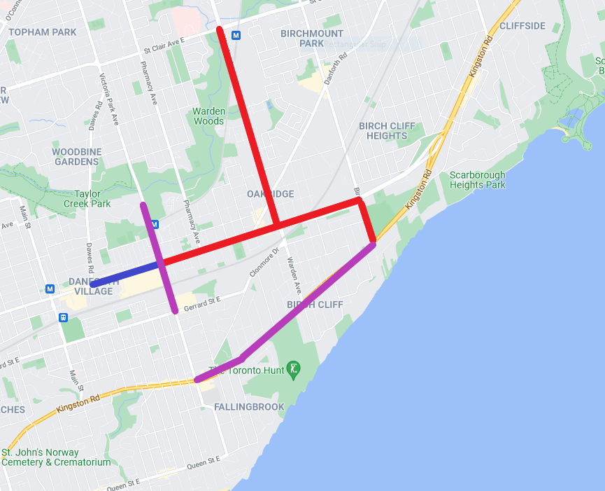

Ok, so I promised a look at how I would do things with respect to cycling infra, in Scarborough.
Let me start by saying, if politics and money were no obstacle, I would put cycling infra everywhere, which is where it ought to be, in the longer term.
But in the real world, we want to grab low-hanging fruit (infrastructure which will generate less opposition, and or sufficient support to ensure it stays in place once approved).
We want to look for projects that require as little study, and as little expense per km as possible, to maximize gain.
But we also want to choose logical routes, and aim for relatively quick uptake.
Rather than do all of Scarborough, I'll take a look at 2 spots I see as being of near-term interest.
1) Scarborough South-West.
This is the area directly abutting East York, generally south of Eglinton, and east of Victoria Park Avenue, down to the Lake.
Here's what I would do:
Legend:
Blue: approved and funded Cycle Tracks, Danforth, Dawes to Victoria Park
Red: Priority Cycle Tracks
Purple: Phase 2 cycle tracks
Here's the details:
Red:
Danforth Victoria Park to Birchmount.
This is a logical extension of the existing Danforth Cycle Track and will therefore have built-in ridership interest.
This section of Danforth is not prone to heavy congestion overall, with some minor congestion in rush hour in the primary direction of travel.
The local councillor has expressed openness to the idea (Crawford)
This would make parking permanent (ie remove rush-hour parking restrictions) for local businesses and residents (this creates an additional positive stakeholder).
It sets up a logical connection to key destinations, including, Victoria Park Station, Shopper's World, Warden Subway Station, and major Recreation amenities on Birchmount south of Danforth.

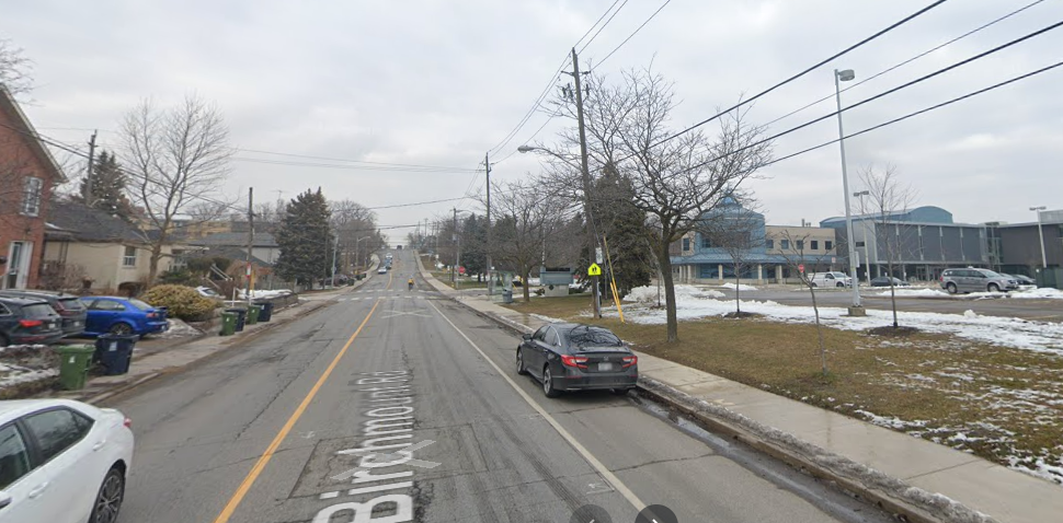

Birchmount south of Danforth:
A short stretch of road which connects Danforth to the Waterfront, and to major recreation amenities including a Community Recreation Centre, Leisure Pool, Arena, and Stadium.
Credit Streetview
As one can see there is sufficient road width along the bulk of this road in the form of a parking lane that is lightly used, because City facilities here all have off-street parking.
Additionally, the City is the land owner for ~ 90% of the land on the east side of Birchmount, along with the TDSB, meaning adjustments in road width could be made fairly easily without much if any land acquisition, should they be needed.

Purple:
Kingston Road from Victoria Park to Birchmount.
Parking is currently permitted on both sides of the road, except in rush hour.
So long as most parking remains, or enough parking remains to meet current demand, business and residents would likely be pleased by the removal of rush-hour restrictions.
This is good and represents additional positive stakeholders. It will, however, increase congestion modestly at peak times.
It also has fewer destinations and lower feed-in cycling traffic than Danforth, and is therefore a lower priority.
Same Councillor as Danforth, you won't get both at once.
Victoria Park, Crescent Town Road to Gerrard.
Looks controversial, as the VP/Danforth intersection here experiences significant congestion at peak times.
However, I believe many of those issues might actually be better resolved with bike lanes, than without.
They require dedicated right-hand turn-lanes approaching Danforth, and the elimination of those travel lanes on the opposite side of same.
That said, because it may seem counter-intuitive and involves the same Councillor as Danforth, this should rank as a lower priority.

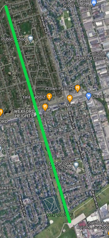

Here, the key project to date is the Gatineau Hydro Corridor, something I would propose to build off.
I would prioritize the Warden Hydro Corridor, south of the CP Rail line (crossing it is a significant investment and regulatory issue) to the Gatineau Corridor
This project is in the Toronto Trails Strategy, it connects with the Gatineau Hydro Corridor (Meadoway) therefore helps create a network.
There is no political opportunity in the near-term for investments on the parallel sections of VP, Pharmacy or Warden.

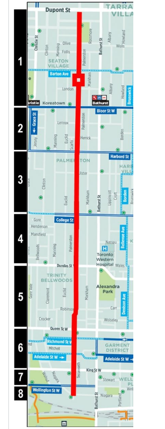

Toronto is looking at Cycling improvements for a N-S corridor following Palmerston and Tecumseth from Dupont to just south of Wellington.
Link here: https://www.toronto.ca/community-pe...cts/palmerston-tecumseth-cycling-connections/
Map here:
Description of the changes proposed for the 8 segments:
There is a virtual public meeting this Wednesday to discuss the above. For those supportive of these changes, I would certainly encourage you to register, and voice that at the meeting.
