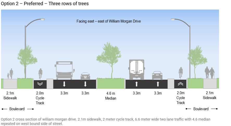

First, some comments on the above: What's with the prison yard railings on the outside? I assume this a suicide prevention barrier? I don't care for the aesthetic, I hope something better can be arrived at.
Second, 3.45M for the curb lane seems excessive, as does 3.3M for the inside lane. A bit of shaving there would be good.....3.3M for the curb lane, 3.0M for the interior lane would free up an extra .45M for pedestrians and cyclists.
Third, the barrier separating the cycle track from vehicles should be attractive, just use a nice form for poured concrete, and a more attractive railing with some colour (even black)
