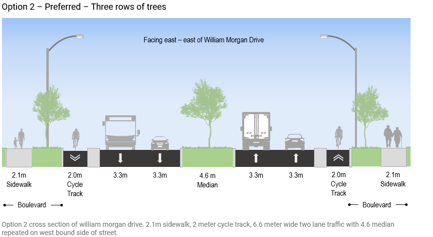

  • Sidewalks are proposed to be widened to 2.1 meters, to make it easier to walk together, and to allow people with mobility devices to pass each other safely.
  • New bikeways such as cycle tracks or multi-use trails are proposed to connect existing cycling routes in the area.

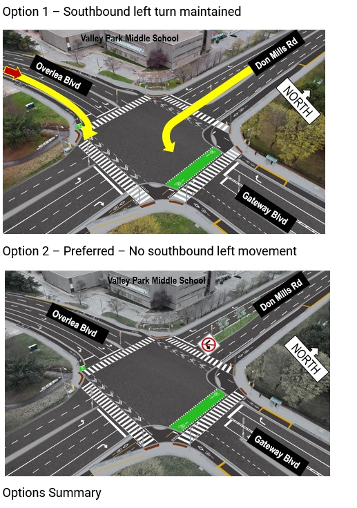

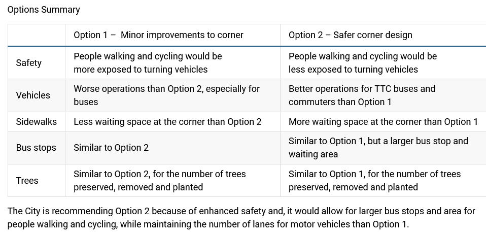

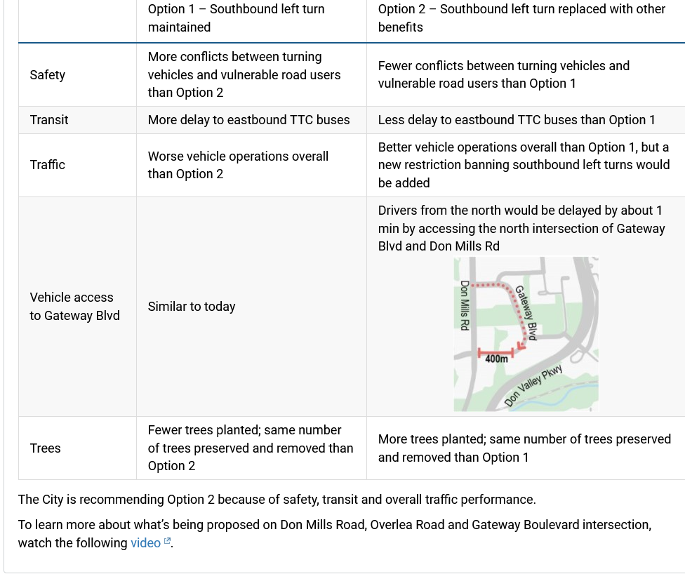

The City is looking at two options at the intersection of Don Mills Road & Overlea Road/Gateway Boulevard. The following changes are being proposed:
  • Cycle tracks would be added with dedicated space for people cycling to cross and wait, with physical separation continued to the intersection
  • Multi-use trail would be added southward along Don Mills Road to connect to the Lower Don Access Trail
  • Safety enhancements would be added to all intersections, such as renewed pavement markings, prohibited vehicle turns, and signal timing that separates the movements of vulnerable road users from vehicles.

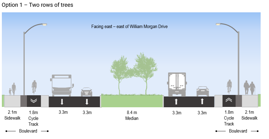

Cross Section of Overlea bridge with two sidewalks being 2.5m wide, two cycle tracks being 2.4m wide, two HOV lanes being 3.45m wide, two vehicle lanes being 3.3m wide.

First, some comments on the above: What's with the prison yard railings on the outside? I assume this a suicide prevention barrier? I don't care for the aesthetic, I hope something better can be arrived at.
Second, 3.45M for the curb lane seems excessive, as does 3.3M for the inside lane. A bit of shaving there would be good.....3.3M for the curb lane, 3.0M for the interior lane would free up an extra .45M for pedestrians and cyclists.
Third, the barrier separating the cycle track from vehicles should be attractive, just use a nice form for poured concrete, and a more attractive railing with some colour (even black)

Is the traffic volume so high that dedicated right turn lanes are needed?
I couldn't say for sure on the Gateway to Don Mills and Don Mills to Gateway movements, my instinct is that they are not needed, but its not something I've looked at closely.
The Overlea to Don Mills right turn and Don Mills to Overlea right turn are likely needed.
Overlea To Don Mills is the path for Leasiders getting to the DVP.
Don Mills to Overlea {right SB to WB) exists now because Don Mills goes from 3 lanes, to 2 lanes at Overlea, so the rightmost lane becomes a right-turn (must exit) lane.
Removing it means removing the 3rd lane further up Don Mills. (I'd be all in favour, but its a much bigger re-think)

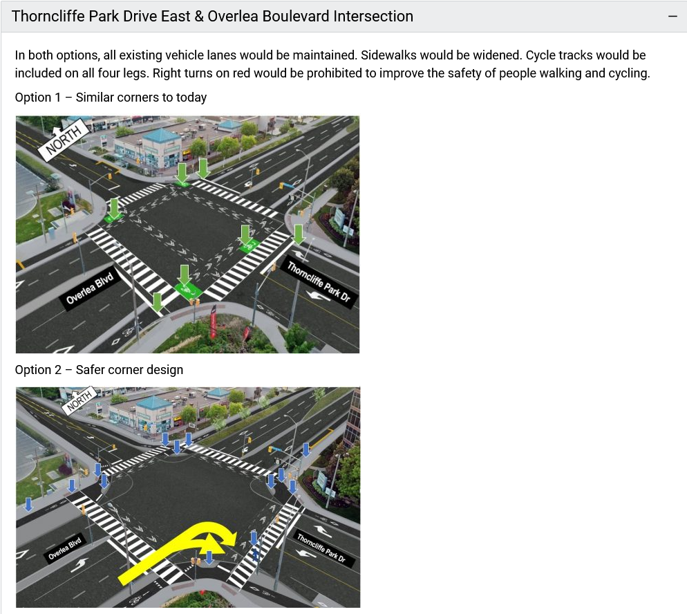

I am encouraged that protected intersections are slowly, slowly wiggling their way into north american civil engineers' playbooks. Still not all the way to bright but progress nonetheless.
