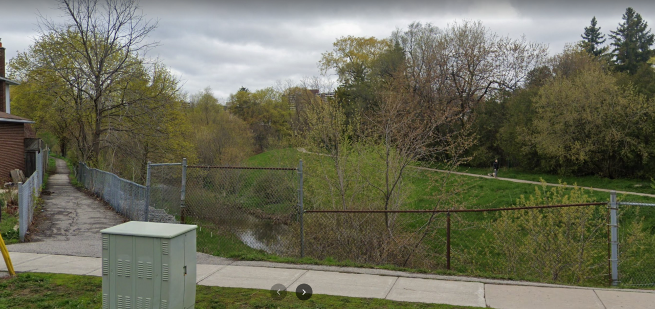

I observe when I look at the trail at Huntingwood, which is awful, but I digress:
There's no signage from Toronto Parks, none from Toronto Transportation, below the fence is probably Toronto Water.

This is one of the better ones (a fence, and reasonably cleared path), if you followed this to Warden or took the path on the right past Finch to L'Amoreaux you'd see areas where the path almost no longer exists. I did engage councilor Kelly a while back but it didn't go anywhere. It's been a while and perhaps a follow up with Mantas is in order. 'll see if I can snap pics when it's nicer out and foliage is fully bloomed.

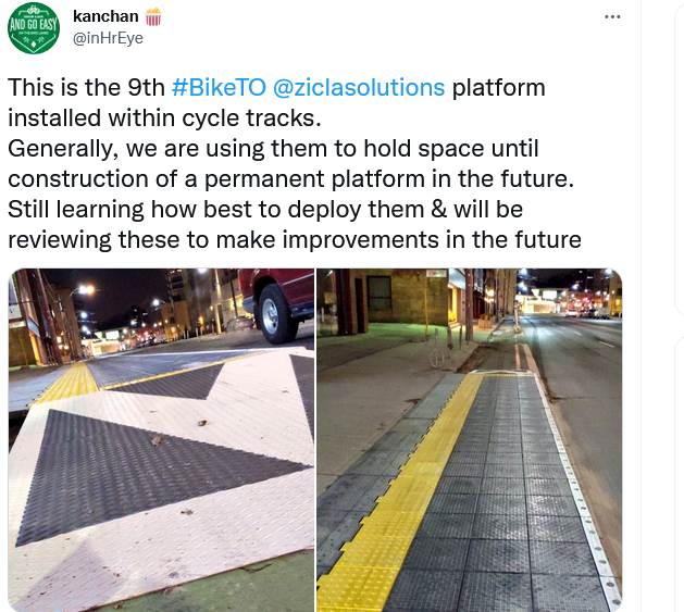

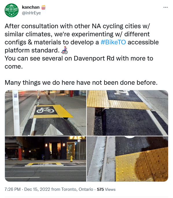

Several of you have taken a keen interest in the raised platforms in Cycle Tracks at Bus/Streetcar stops. A bit more info:
The above from:
Thoughts? Share'em; here for sure, but also w/City cycling, they are really are interested in any constructive input.

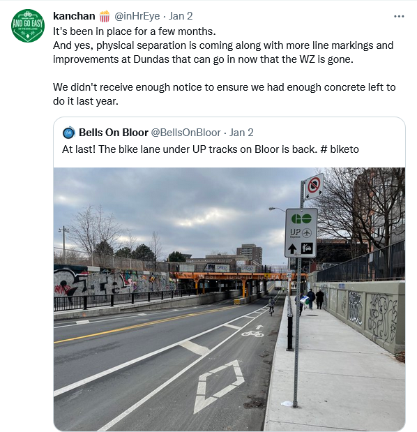

For those near the Bloor/Dundas area:
WZ is work zone btw...
Two problems.
The sewer grates become potholes over time in the cycling lane.
Cyclists need to speed up going down the incline to the underpass to be able get the inertia needed to get up the incline on the other side. Should have been level with the sidewalk at least, and separated from the roadway.
Agreed. I can see inattentive cyclists doing a header hitting the platform edge in that drainage channel next to the curb.
Overall, I think this design creates unnecessary risk and conflict between cyclists and boarding and particularly alighting passengers. I can see this being a stop-gap until street reconstruction allows the curb to be moved to bulb-in for the stop with the cycle track going behind the boarding area.
Constructive. Thanks.
Now, here's the question, what can we suggest to the City to address the drainage need, yet create a safer design?
I'm wondering about hard plating that's perforated or slatted going over that gap; but also thinking about whether it might be excessively slippery.
Two problems.
The sewer grates need to exist, or the bike lane would be under water.
However, it may be possible to incorporate a design integrated w/the curb. But that can only be considered during reconstruction.
I support your design idea, and it should absolutely be considered when this spot comes up for reconstruction.

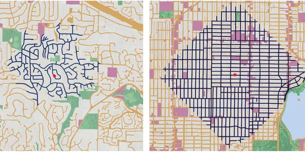

These sorts of trails really help with the issue of suburban areas having twisty streets that make walking and biking through them cumbersome
These are both places within a one mile walk for grid and suburb style layout.

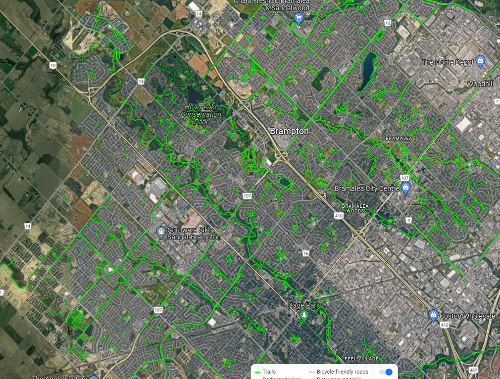

The more trails we have that allow walking/biking etc between the windy streets, the more walkable they become.
There are actually a couple places that do this well in Toronto, notably Pickering and Brampton
