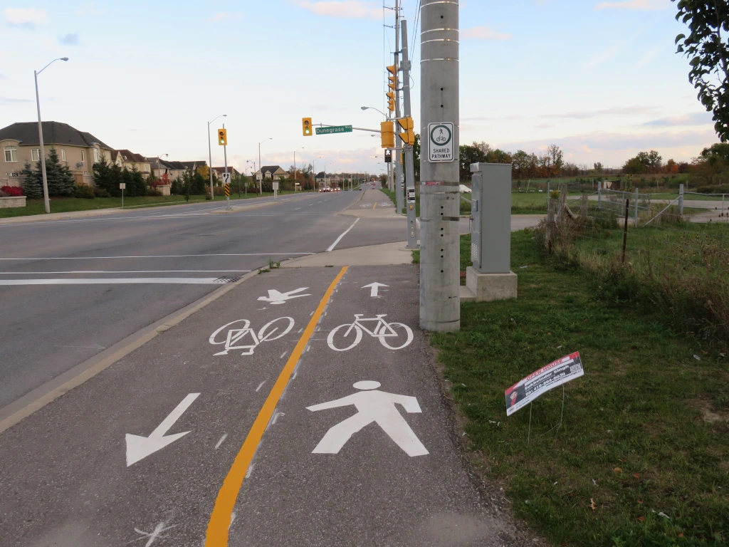

What’s an example?
Do the different users have dedicated space or they share the same space?
A good example.
From:
As you can see, pedestrians and cyclists share the space, with guidance to keep right.
They are only appropriate when the volumes of both pedestrians and cyclists are relatively light, and there is insufficient room for dedicated sidewalk and cycle track.

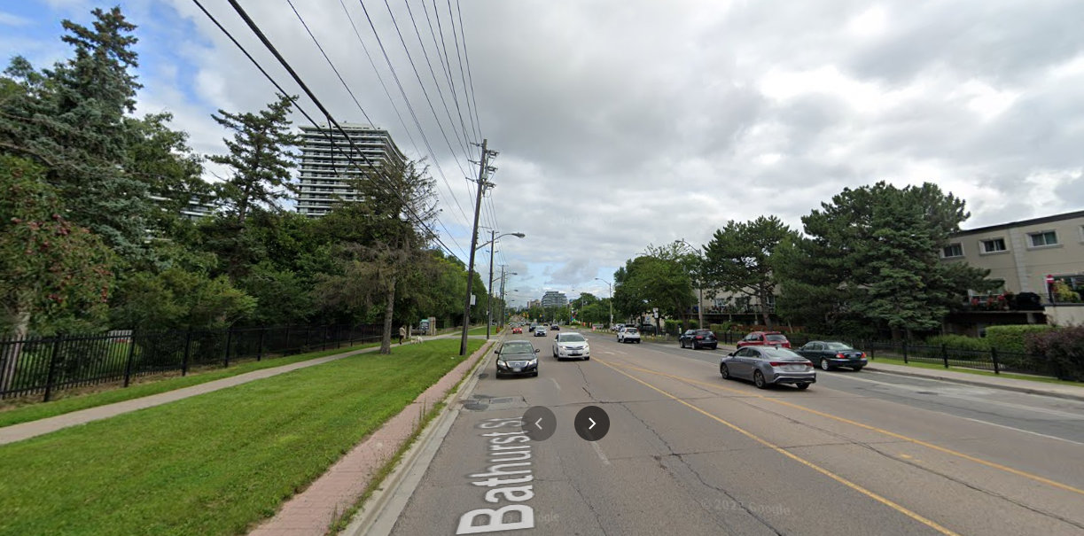

It will absolutely not be this year. No chance, no way, on how.
There will be a public consultation first; and it will go ahead with major road reconstruction on Bathurst, hopefully next year.
The intent is to put a paved bike path in the boulevard here. Likely in addition to the sidewalk, but I haven't seen the design yet.
Generally, MUPs in Toronto range from 3M to 4M. This would probably be in the narrower side.
The 4M is typically in Toronto Parks and meant so that an ambulance can navigate it, this should not be a consideration for a trail beside a road.
how do you know these details?
what about the future lane on Armour Boulevard that is currently in "study" stage?

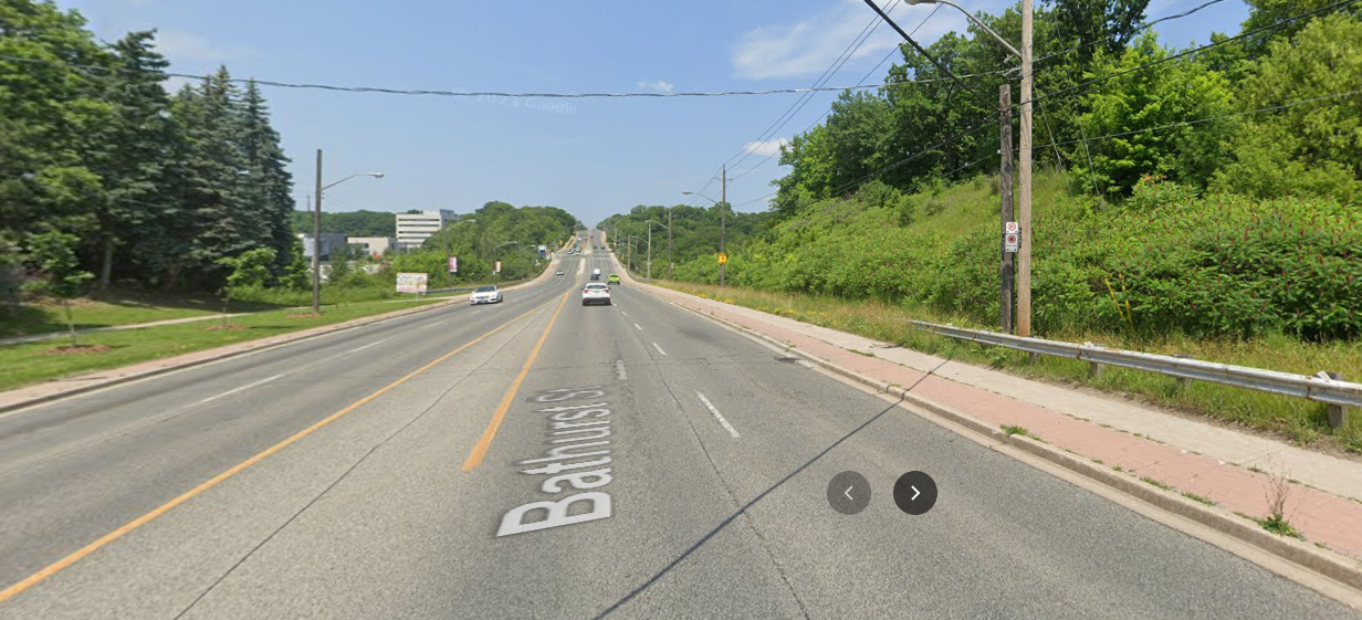

Relevant sections of Bathurst:
This one will have to get through consultation still; I haven't seen the design, so I'm not sure how much softscape is proposed.
I'll wager there will some space from the street itself reallocated though.

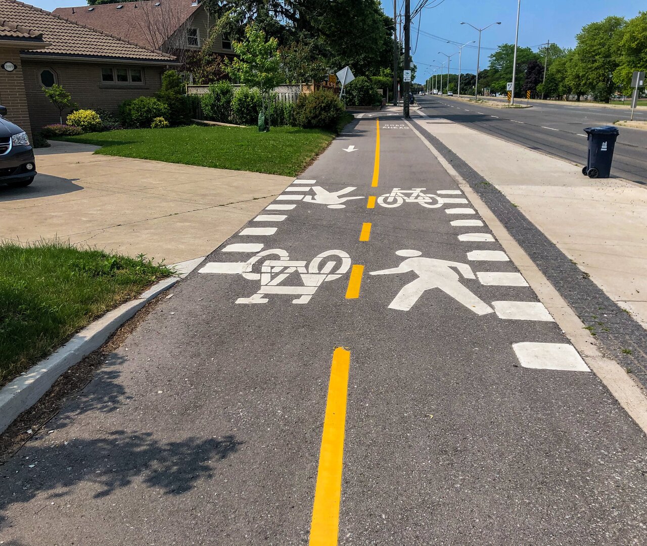

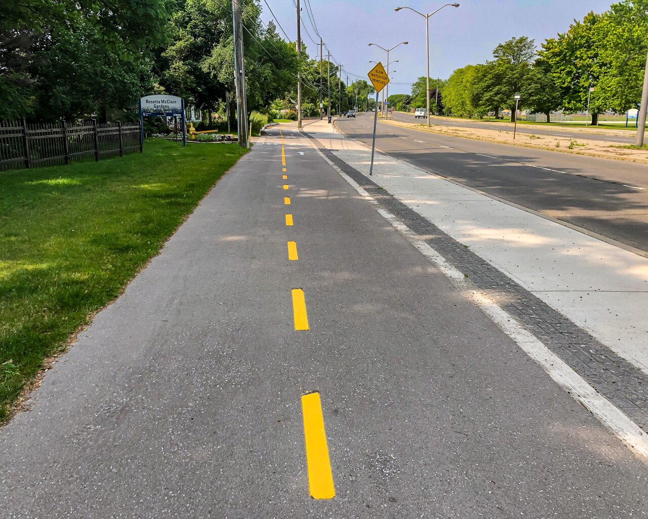

Here's an example adjacent to the sidewalk.

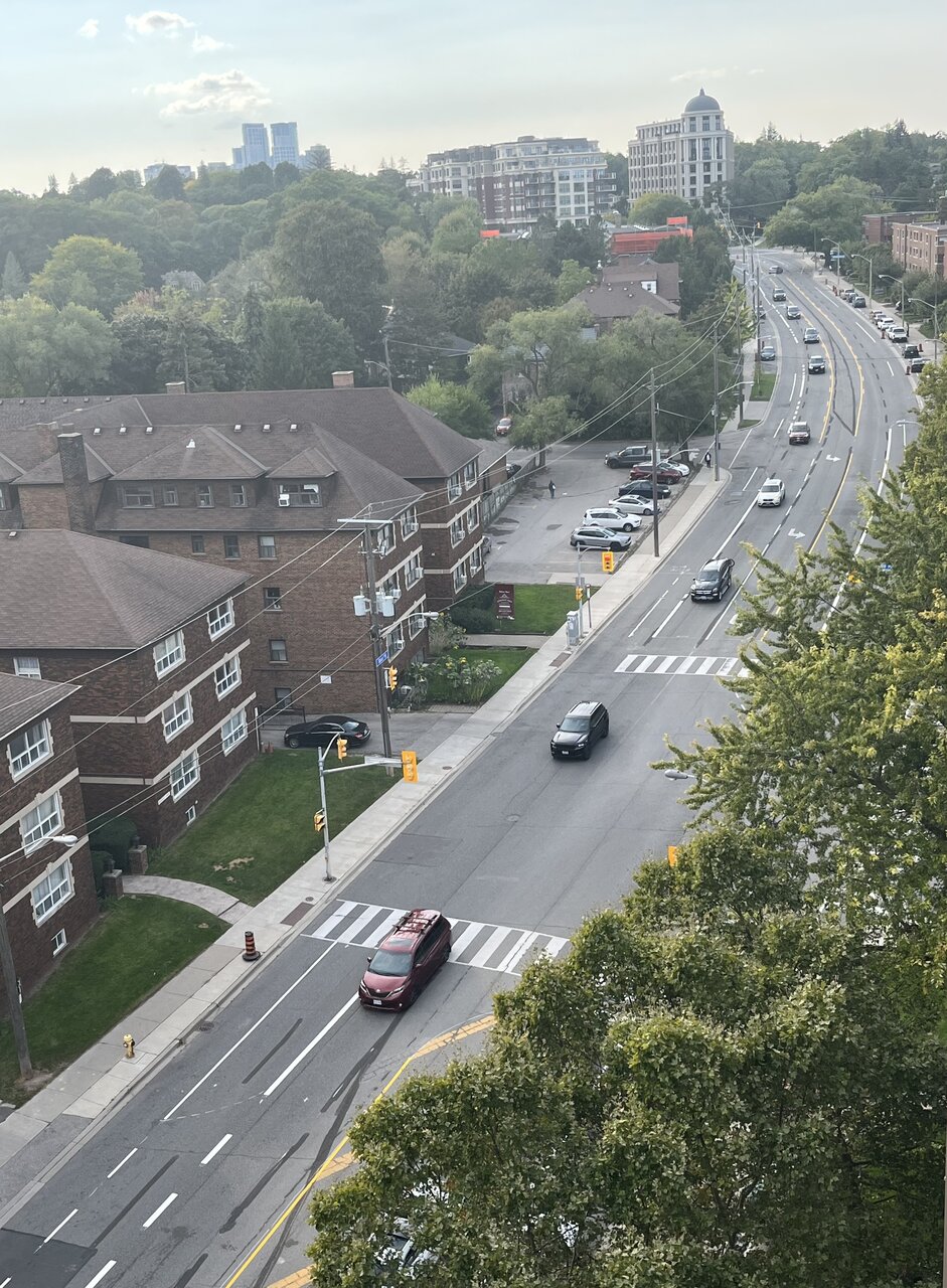

A portion of Bathurst crosses a ravine and that is what you showed in the first picture. Otherwise the street is lined with mid or high rise residential, and low rise retail. It’s not like 905 suburbs with no pedestrians.
I think the lanes are wide enough that they can create bike infrastructure without removing boulevard green space. Not sure we need more concrete at the expense of cutting down trees and removing grass spaces.
There will be a public consultation; if you're not digging the drawings when they come out, you should absolutely say so!
I myself haven't seen the drawings even though I know what's coming, roughly, so I'll reserve judgement.
