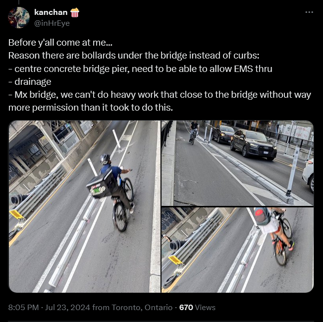

Kanchan does a good job explaining why we have interim solutions; which don't satisfy everybody:
I'm unconvinced by these bullets. This design isn't in keeping with the original design for physically protected lanes here.
Drainage? The curbs can be spaced out to reduce that issue.
Mx permissions? If placing precast curbs is "heavy work" can the city not get that permission? There are lots of barriers under rail bridges. Someone got permission!
The issues around EMS access are to me likely the main culprit. This is a city choice, and maybe more to do with optics than reality of EMS impacts. Those vehicles can get over the low curbs without much trouble.
I don't think we're re going to win this battle in the public consciousness. People generally want to dress for their destination, without needing to change/shower, and without sitting in sweat-damp clothing for hours. All the power to sports cyclists, but maybe we don't all want to live the way you live.
Temporary vs permanent, we've been over this. This is the interim condition, more will be done at a future date.
Huh? Show me the design you have in mind. I don't know what options were examined, but we have barriers that let water underneath, the challenge in an underpass such as this is that there is a solid barrier in the middle which does not allow water underneath, that raising the cycle track would preclude drainage without moving the catch basins, that water naturally flows down hill, the location of existing catch basins matter, etc etc.
Its not that it can't be done, its that its a big deal in time, and money to do it all now.
The point wasn't that its impossible to obtain permission to make more substantive alterations, the point was that it sucks up time, measured in years.
On one project they took over 4 years to grant approval. The choice here is this for now.........or wait several years. Mx also has the habit of trying to get others to pay for work they want to do and stacking up costs.

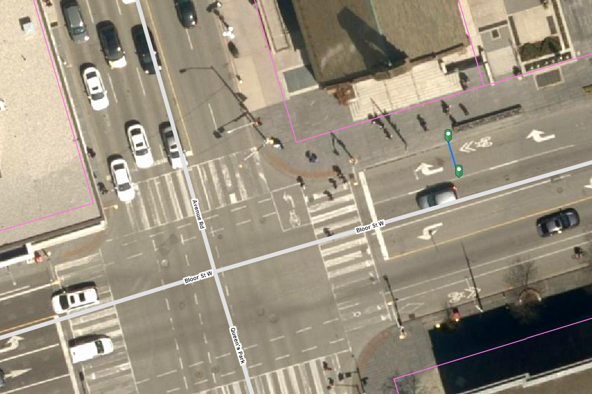

Lets look at an aerial photo:
The cycle track here is 'shared' with a dedicated right-turn lane. That lane is ~3.9M wide. The minimum standard for a vehicle lane is 3M, typically a curb lane is a bit wider.
But lets go w/3M, that leaves a dedicated cycle track, including buffer 0.9M Which is obviously not workable. A bare minimum cycle track is about 1.6M wide, excluding buffer where any separation would go, for which you generally need at least another 0.4M, and more would be preferable.
So the only way to get a separated cycle track here, at the intersection would be to either remove a car lane (the dedicated right lane, presumably) or to narrow the sidewalk. The sidewalk here being quite busy, I don't think that's really on.
Can we cut the dedicated right lane? Physically, obviously yes, the question is what would the impact to traffic flow on Bloor be? My honest answer is that I don't know, as I don't have the traffic count data for that lane. But staff will have that number, and presumably the feeling was that it would have too high an impact to remove it, the last time it was looked at.
This section is coming up for enhancement shortly, and new counts should be done, and may have been already.
I'm happy to support at least considering removing the right lane........though we really need the data to understand the impact.
I suspect if one removed the right lane, that a right turn restriction would be required here, though I don't know that.
There are some things to look at as the enhancement plan goes forward. The reduced capacity on Avenue Road (from the forthcoming cycle tracks on Avenue Road) may mean a reduced demand for that turning movement.
Can we cut the dedicated right lane? Physically, obviously yes, the question is what would the impact to traffic flow on Bloor be? My honest answer is that I don't know, as I don't have the traffic count data for that lane. But staff will have that number, and presumably the feeling was that it would have to high an impact to remove it, the last time it was looked at.

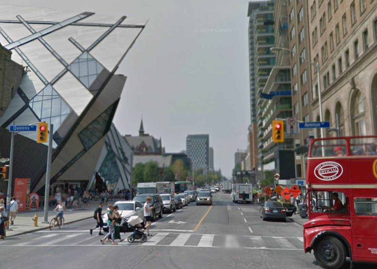

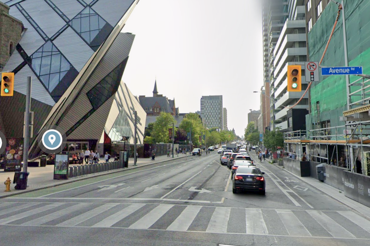

I am wondering why the city couldn't do exactly the same configuration as they did on the West side of the intersection. There Bloor used to be 5 car lanes wide, and they converted it into 4 car lanes plus two bike lanes 0.5 car lanes wide. Not ideal, but seems to work okay.
West Side Current* Configuration (* I am not sure if this has changed with the construction on Bloor West of here)
West Side Past Configuration
Here on the East side of Bloor they also had 5 lanes, but converted into 4 car lanes plus a bike lane that is 1 car lane wide in one direction and no bike lane in the other. Is there a reason they couldn't do the same configuration as on the West side?
Ideally a car turn lane should be removed here, but if it can't, I think the eastbound bike lane can be narrowed and lose its buffering at the intersection with the four car lanes shifted South, if that allows to fit in a westbound bike lane.
Ideally a car turn lane should be removed here, but it it can't, I think the eastbound bike lane can be narrowed and lose its buffering at the intersection if that allows to fit in a westbound bike lane.
I want to be clear that I am not speaking for City staff here, just myself........
Giving your suggestion a once over......I think its feasible.
The free and clear EB bike lane on Bloor at Avenue road appears to be ~2.4M with a 1M buffer. If you pinch 0.5M off that, you can get a 1.4M bike lane on the north side, and if you went down to a 0.6M buffer....there should be room for a small buffer on the north side as well. *
* that's very back of the envelope and any errors in measurement may affect what's possible
But I would point out that it does not provide physical separation at the Avenue Road intersection. So it would be an improvement, in adding a painted line, and possibly green surface treatment, but it wouldn't physically prevent a car (or refuse bin) from blocking the bike lane.
Certainly though, its worth considering.
Measuring of Sat. Photos is inexact, but i would note that on the west side there, it appears as though the WB bike lane is of substandard width, and the EB car lane appears to also be sub 3M, but that may not actually be the case.
Any which way, its a very tight squeeze, and physical separation (barrier) can't occur without removing one of the vehicle lanes.
I just checked, the enhancement to the Cycle Tracks on the east side of Avenue Road (on Bloor) is currently programmed for 2027. I can't say for sure when design would start, but it could be as soon as next year, and should not be later than 2026.
IF you have suggestions, now is the time to be sharing them with staff and/or Councillor Saxe.
