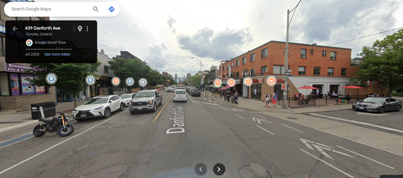

Where? I keep seeing stuff like this (at Pharmacy). There's enough to paint in parking spots that easily leave the width of a bike lane!

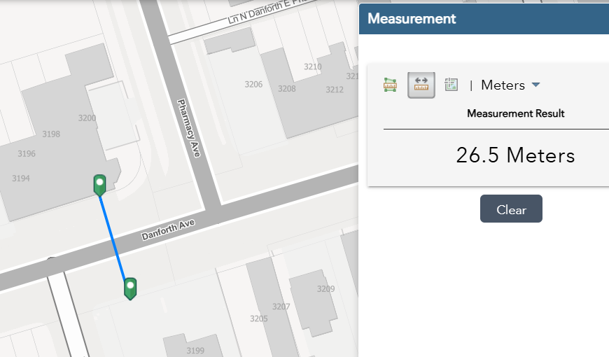

I just remeasured. I got 15 metres. Where were you looking? Perhaps we are looking at two different things.
Danforth/Pharmacy is 25.4M within the ROW and is 15.4M curb to curb
I said 27 metres and 15 metres above. I'm remeasuring yet again. I still get 27 metres - or at least 26.5 metres, which is within the accuracy of the notoriously dreadful PIN mapping. Can you show your 25.4 metres?
