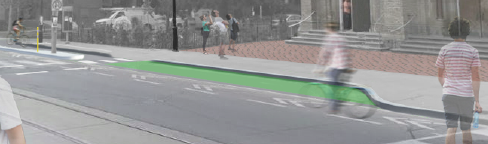

The curbed and channeled section from Adelaide east to Bathurst makes logical sense. The spoiler is the 'green' lay-by from the north within the intersection. The schematic pic actually adds to the confusion by showing an arrow to turn before attaining the marked cycle crossing sharrows.
So what is the purpose of the green lay-by? Is it to stack cyclists southbound intending to head east, and if so, for the numbers touted by the City, it appears inadequate in size, and also very indefinite as to where to channel them to cross, not to mention that by not having it as a channeled, curbed lane, it is technically part of the intersection, and you can't have traffic purposely back-up through an intersection.
The green lay-by is a very poor design, if not illegal, and it doesn't seem to offer any advantage over not having one there at all. In fact it promotes conflict with the northbound separate lane.
That green lay-by should be made a separated bike lane too (with curb, for safety and to bring it under City control, not HTA) and the potential conflict with the opposing separate bike-line studied again to see if sequential bike lane lights are needed. Something is.
Edit to Add: I've read this a number of times in case this is an awkward semantic:
"The Adelaide Street West intersection is offset at Bathurst Street so that the west leg is south of the east leg."
I've given up trying to make sense of that, it appears polar opposite, so I presume what's intended is:
(gist)"The Adelaide Street West intersection is offset at Bathurst Street so that the eastbound leg approaching Bathurst St is south of the eastbound leg departing from Bathurst Street."

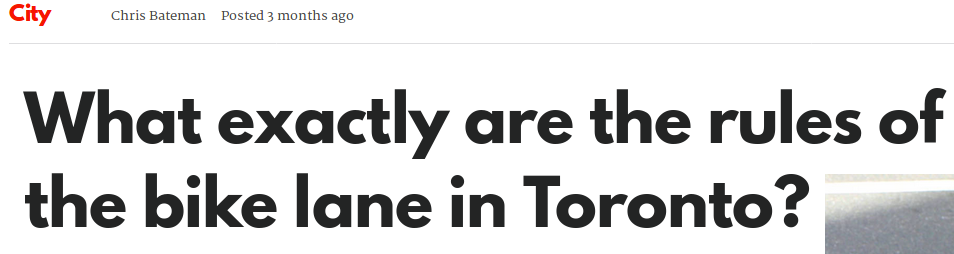

The rules of the Toronto bike lane are, let's face it, unclear. Most cyclists don't know which vehicles are legally allowed to be stopped or parked in the bike lane. Contrary to popular belief, even dedicated bike lanes aren't off-limits to all motorized vehicles.
The lack of clearly posted rules is coupled with a dearth of visible enforcement, but the biggest scofflaws — delivery van drivers and moving companies, judging from angry tweets — seem able to dodge enforcement officers with relative ease.
Coming straight from the City of Toronto bylaw, here are the rules of the Toronto bike lane. Note that the rules differ slightly for painted and separated bike lanes, like on Sherbourne and Wellesley. [...]
http://www.blogto.com/city/2014/06/what_exactly_are_the_rules_of_the_bike_lane_in_toronto/

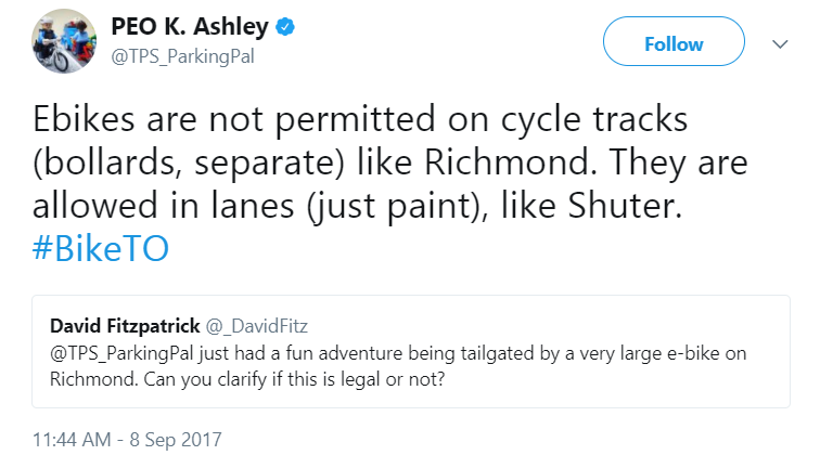

Can we get ebikes out of the bike lanes?
Yeah...they're a blight, doubtless, but unfortunately, Council fudged the issue, and getting back to the ambiguity in the Law, they are using lanes that come under the HTA. In parks and off-road trails, they are banned. Doesn't stop many of them from doing it. Quite a few use the West Toronto Railpath, not legal. And not legal on the Roncesvalles raised sections, Sherbourne, Waterfront and a few other instances of seemingly on-road trails, but by being physically separated, technically they are sidewalks, not roadways.
Enforcement on this is almost totally non-existent. In most cases, the e-Bikes are a menace being operated by persons who lost their licence to drive. There are a few legitimate users with a disability that dictates the need, but they're a minority, and unfortunately get thrown in with the bandits.
I can't remember which official it was, but someone confirmed/asserted on Twitter last week that the delineation is that e-bikes are technically not permitted in cycle tracks but are in non-protected bike lanes. I hate them everywhere tbh.
I share your disdain, and there's actually an amazing amount of discussion on this on-line. e-Bikers are reviled internationally in developed nations. Many e-Bikers can't understand why...lol.
THE major point is that they have no consideration on protocol or common-sense in using bike lanes. A well-functioning cycle lane is like a choreograph, you clearly see this in the Dutch and Danish videos, even in some of the US progressive cities. And e-Bikes fit into that choreograph like a pair of construction boots at a ballet class. Some considerate riders can and do, they are rare, and they unfairly get the flame meant for the miscreants.

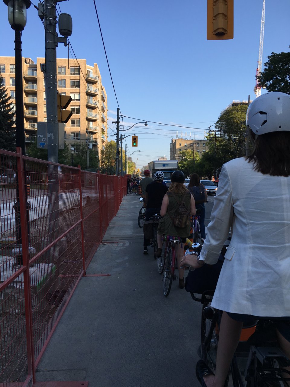

Well then Mr Sensitive, study the picture, and add some input:
upload_2017-9-21_0-39-48-png.121739
What will make cyclists stay in a rational stream when stacked up in the green space? Note the feeding lane opposing? It's north bound, and has a curb to channel cyclists to a very limited aperture to cross east to Richmond. How are the two flows, one from the south, the other from the north, going to meet and flow safely and controlled across that intersection without problems?
Note also an oncoming cyclist north to the intersection with a light in his favour to progress eastward across Bathurst. But there's the red-light runner headed south across his right of way.
Safe?
Over to you...
A bit confused at some of the questions:
- If you are going southbound and then turning left you go into the green box. Then you wait until the light changes and cross the street
- If you are going southbound and going straight you follow the bike lane. If there is a back-up of cyclists turning left you slow down/stop. If there is no cars you can signal with your hand and go into the traffic lane to go around the left hand turn lane.
- If you are coming from the north (from behind the church) you wait behind the pedestrian walkway. When it is free you can turn right to cross the boulevard.
Both sets of cyclists will merge when they cross the intersection. Note with the sharp turn the bikes should slow down. I don't really see the safety concern here for people that follow the rules. There will be those cyclists who try and run a red light and just like cars cyclists should be passive aggressive and not permit them back into the row of bikes. Force them to go to the back.

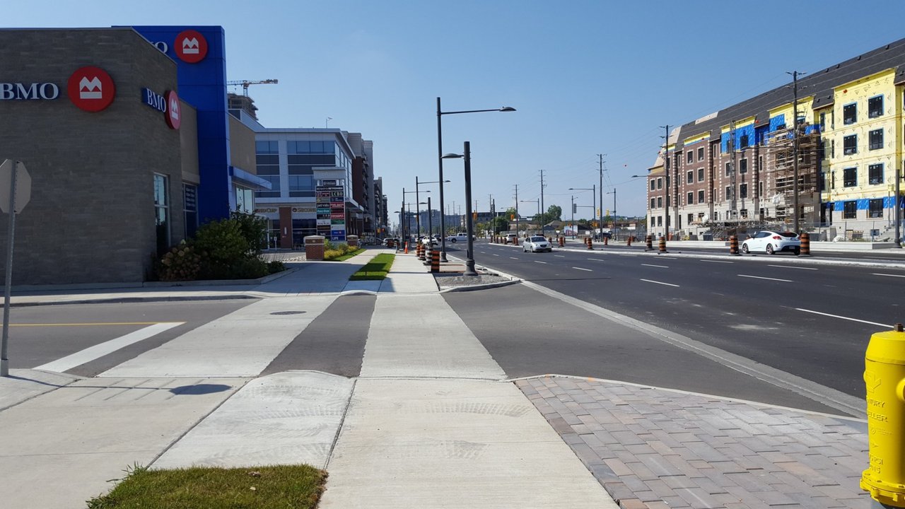

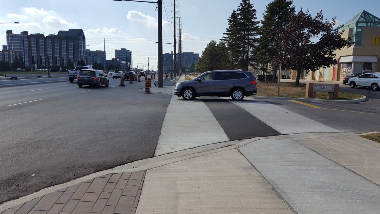

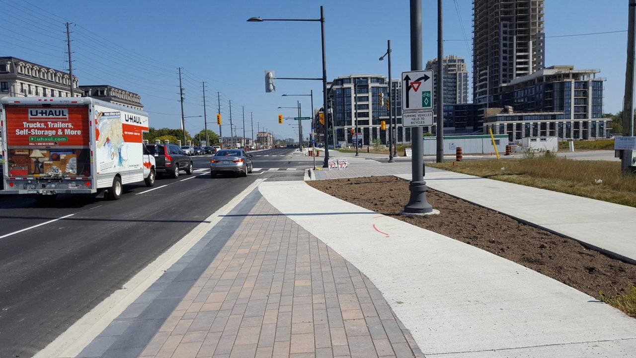

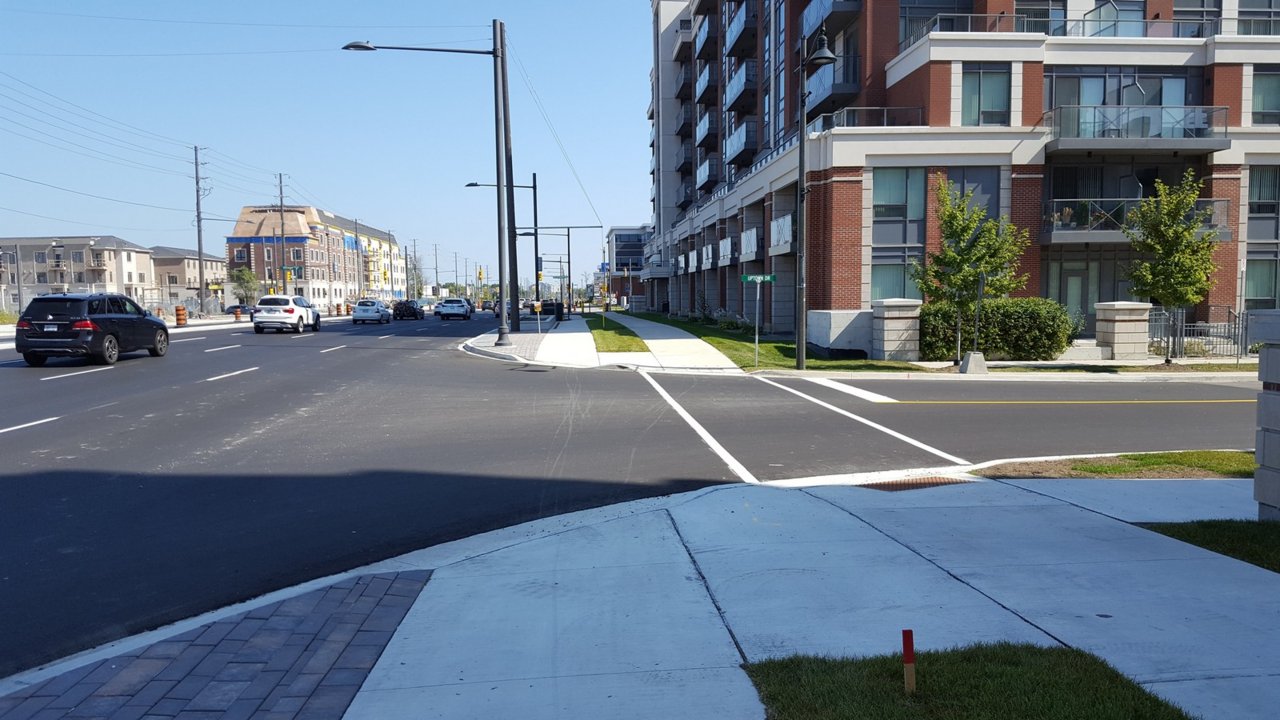

The separated bike lanes on Highway 7 between Town Centre and Sciberras are almost finished and I've ridden them a few times since they finished the paving work. The whole length is now rideable with a couple minor obstructions. I like the design for the most part; the lanes are separated from traffic by planting beds to create a relaxing riding atmosphere. At signalized intersections the lanes join the road to make cyclists more visible to drivers and less likely to be blocked by a turning vehicle.
At unsignalized intersections and driveways the bike lane doesn't join the road; it crosses the intersection like a sidewalk.
The advantages of the lanes re-joining the road are lost at these spots, and you end up seeing a lot of this:
The other thing I don't like about the bike lanes is that they're made of concrete instead of asphalt. The concrete is smooth for now, but asphalt is still a nicer surface to ride on. The road paint isn't all done yet so hopefully they'll add some clearer road markings at all intersections.
Suburbs around the GTA are making efforts to build cycling infrastructure but it's a mixed bag. Less experienced cyclists still tend to use sidewalks even where a street has bike lanes, because the bike lanes are still exposed to traffic. At the same time, serious road cyclists tend to use the road even where a roadside bike path exists. The multi-use paths can have pedestrians and badly designed intersections to deal with, and they're often rougher than the regular traffic lanes. So the design of bike lanes and paths still needs work. With much better designs being standardized in other areas, this isn't rocket science.
