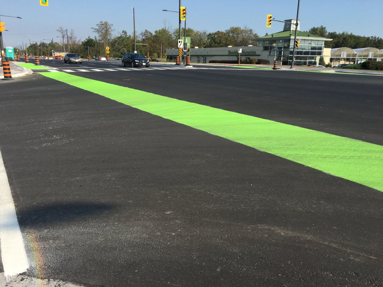

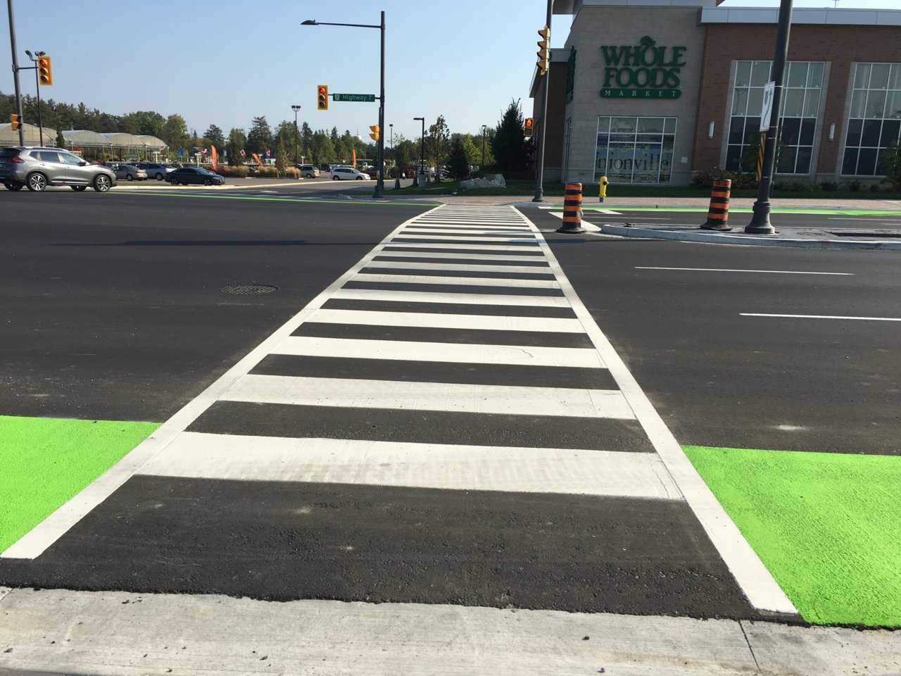

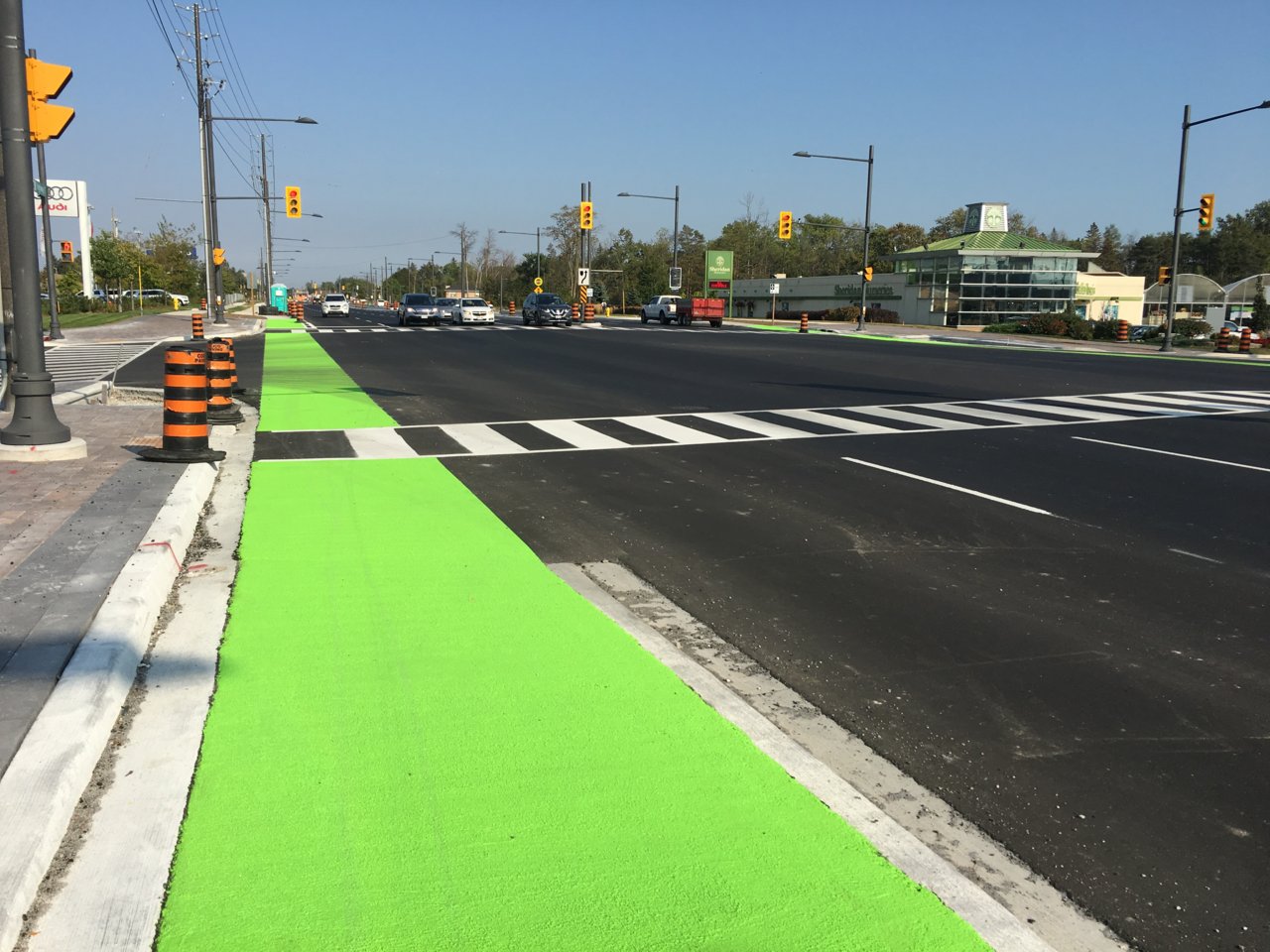

There is now green paint on the Highway 7 Bike Lanes. I would assume white likes will be added, but not yet.
Signalized Intersection:
Non-signalized entrance/exit:

I fully expect you will see some nice green paint at crossings before that is done. York Region used green paint liberally on the earlier phases of the highway 7 lanes.

That green paint looks like it could be slippery when wet.
The green "paint" is actually "thermoplastic" (MTO-rated durable marking, available in high-friction/anti-slip formulations) it's "heated" onto the asphalt (not painted). The green thermoplastic is pre-mixed Corundum ie aluminum oxide which is more durable than sand - in contrast white paint are done in cold plastic with glass beads for reflection - try stopping in the rain on green thermoplastic VS the more slippery white paint); I suspect they're actually using the same green "thermoplastic" Toronto has been using:
