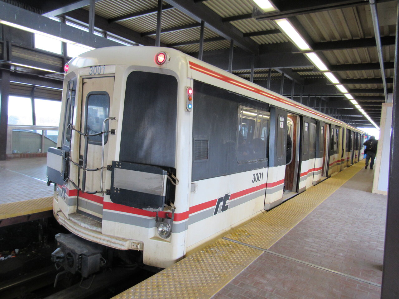

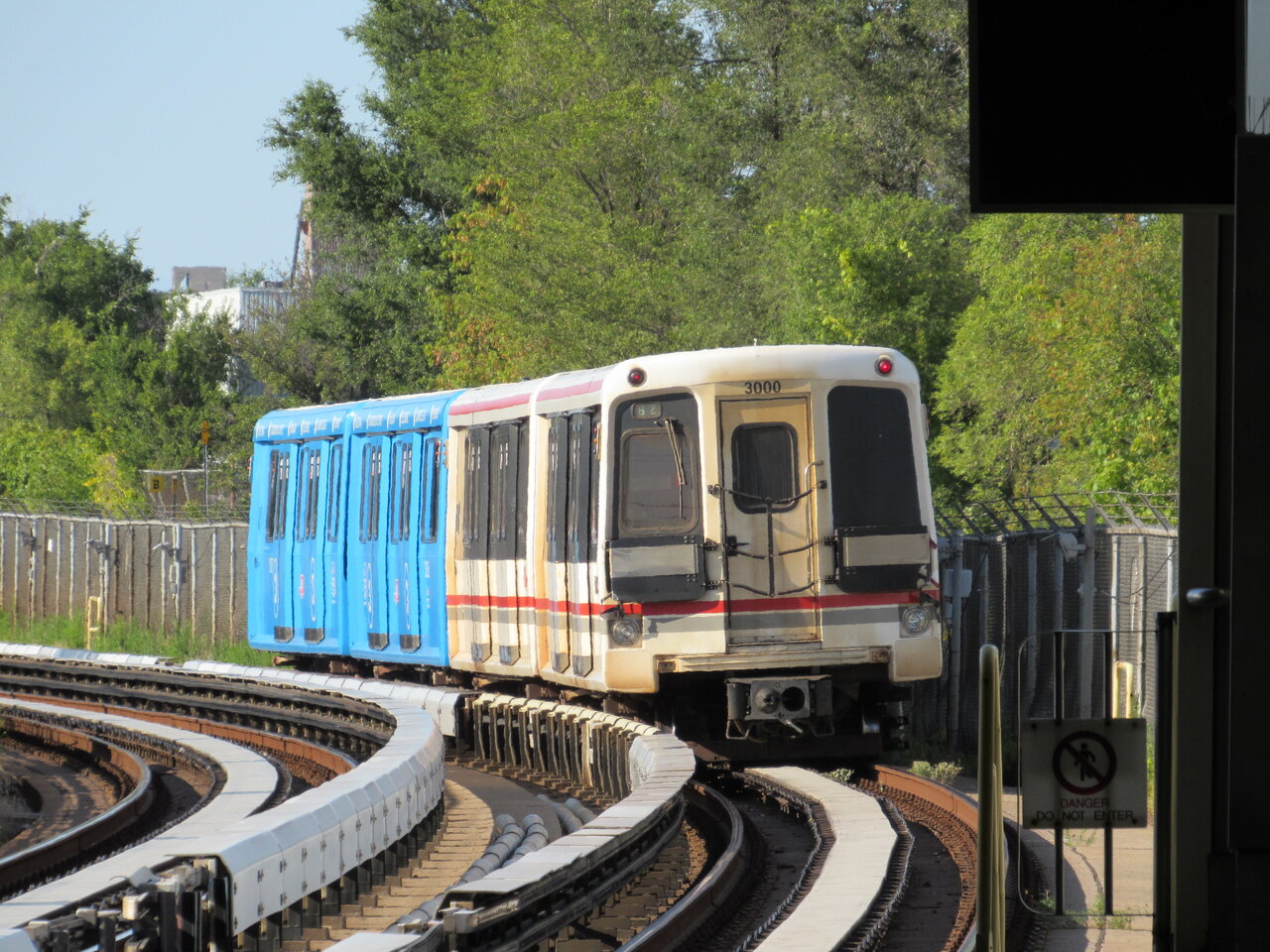

I am away from my computer and I don't have access currently to my most recent photos of 3000-3001.
So enjoy my photos of them back when they were painted in REAL colours.
So glad I photoed the entire fleet before this derailment happened. I just grabbed photos of the last cars I was missing in March.
