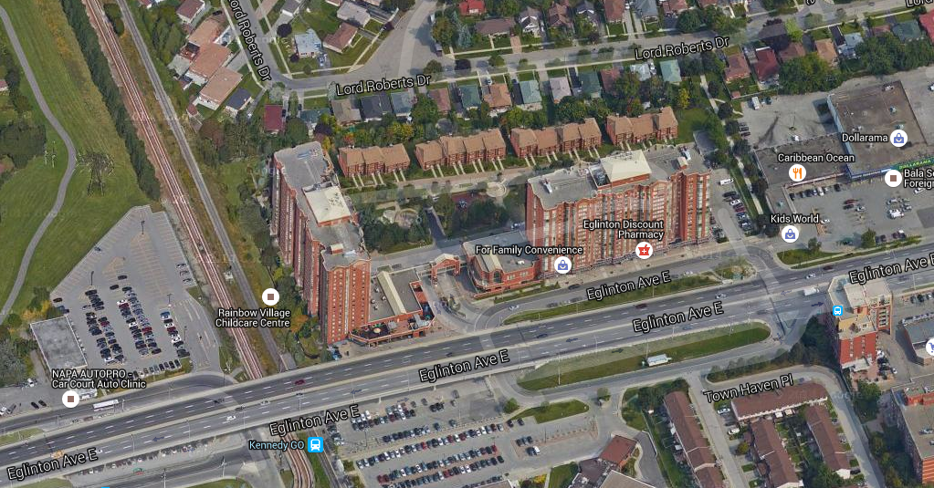

Your alignment passes right underneath a highrise building. The tunnel would not be very deep here to begin with, how do you know that it won't affect the foundation or hit the parking garage?
We don't know. That's why it's being evaluated.
Maybe the tunnels to the east of Kennedy Station can be dug deeper to avoid hitting the foundation.
If we did need to avoid those buildings entirely, the worst case scenario is that we might have to build the curve 100 to 150 metres east. That might actually end up being cheaper since it wouldn't require demolition and rebuilding of the Kennedy tail tracks.
And might allow for gentler curves.
