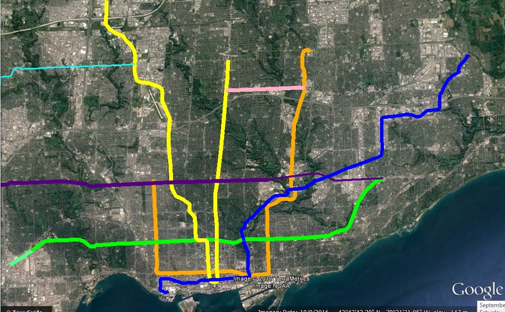

Yes. Basically, the "Scarborough line" has the basic job of doing what the B-D extension does, but better, and as cheap as possible.
  • The 2 serve different area. DRL goes to Seneca and the Don Mills corridor, while this "Scarborough Line" cuts diagonally through Scarborough to serve mostly Malvern, Centennial, and STC.
  • They sort of share a common portion through Flemingdon and Thorncliffe, but this is really only about a 2km segment. It provides an oportunity for an interchange (connectivity is always important) and it also allows the 2 to share a common train yard near Overlea and Millwood (near the waste treatment plant).
  • Farther south, DRL serves Pape and Greek Village, Riverside, while the "Scarborough Line" is really looking for the cheapest route downtown, and sort of serves Regent Park.
  • Through downtown, I think there is enough ridership that a route along Queen and 1 along Wellington are far enough apart. They also criss-cross here as well, with an interchange station at/near Queen/River/Eastern

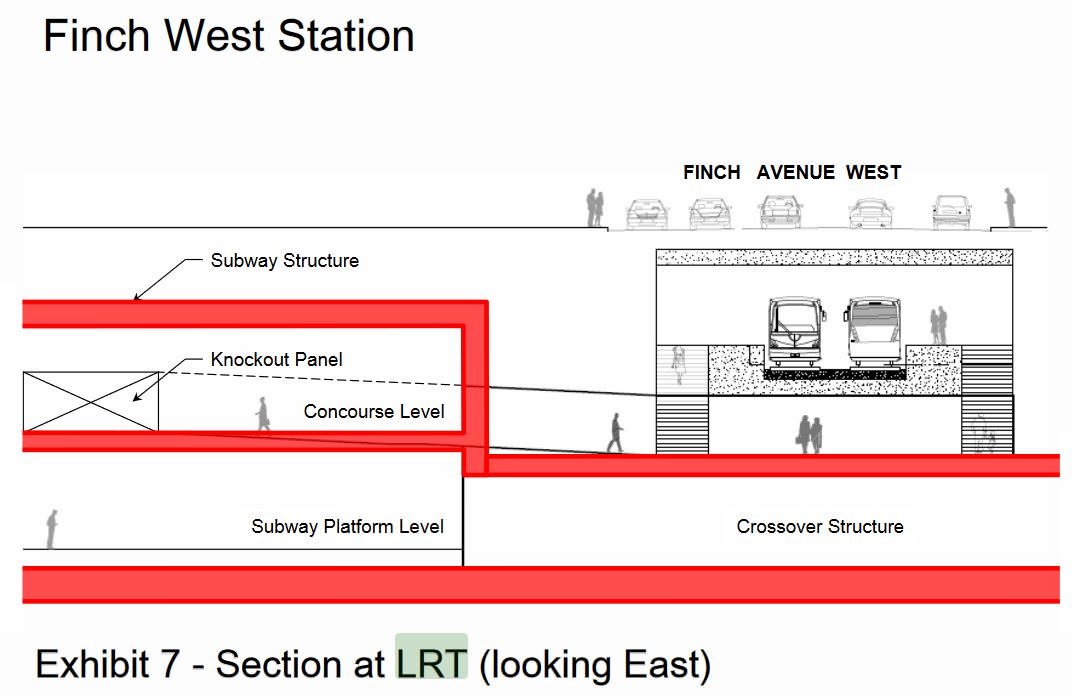

Besides the idea of a separate line from Scarborough to downtown, the other option for SSE is the station at Lawrence.
I saw this image from the FWLRT thread that reminded me of this.
Ignore the subway and look at the LRT portion to the right. This LRT station is directly under the Finch/Keele intersection. By scaling, the track are located about 6m below grade, with a passageway under it. This shows the solution to a possible McCowan/Lawrence station.
Locate the tracks about 6 to 8m below grade as they cross Lawrence. This allows the utilities from Lawrence to pass over the station box. A little north, the tracks would rise to being about 5m below grade, with traffic running directly on the subway structure. The "Mezzanine" for the station would be below the platform, much like the walkway. This "mezzanine" is only needed at the station, so why build the track an extra 5 or more meters in depth (and requiring the use of TBM) for its entire length, when you can instead build a shallow linear structure (using cut-and-cover).
Vibration, noise, surface disruption, pollution (from flange grinding), etc. Quite frankly, if they built a cut and cover subway line right next to my place, I wouldn't care about any of those things because the benefit of available transit greatly offsets the small noise and vibration. However, suburbanites tend to not be in support of such moves. People want it out of site and out of mind.
