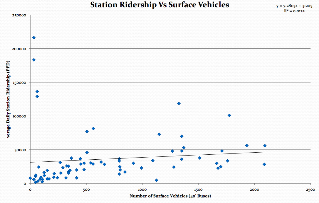

I know this is more of a general sentiment, but the main problem with the LRT plan is not that it's inferior transit, but it's the fact that it has way too many stops to be viable for people going downtown, or even for people getting around Scarborough. Scarborough is huge and you're never going to remove the bus from the equation without having an LRT on every road that stops at every intersection (the equivalent of streetcars in downtown Toronto).

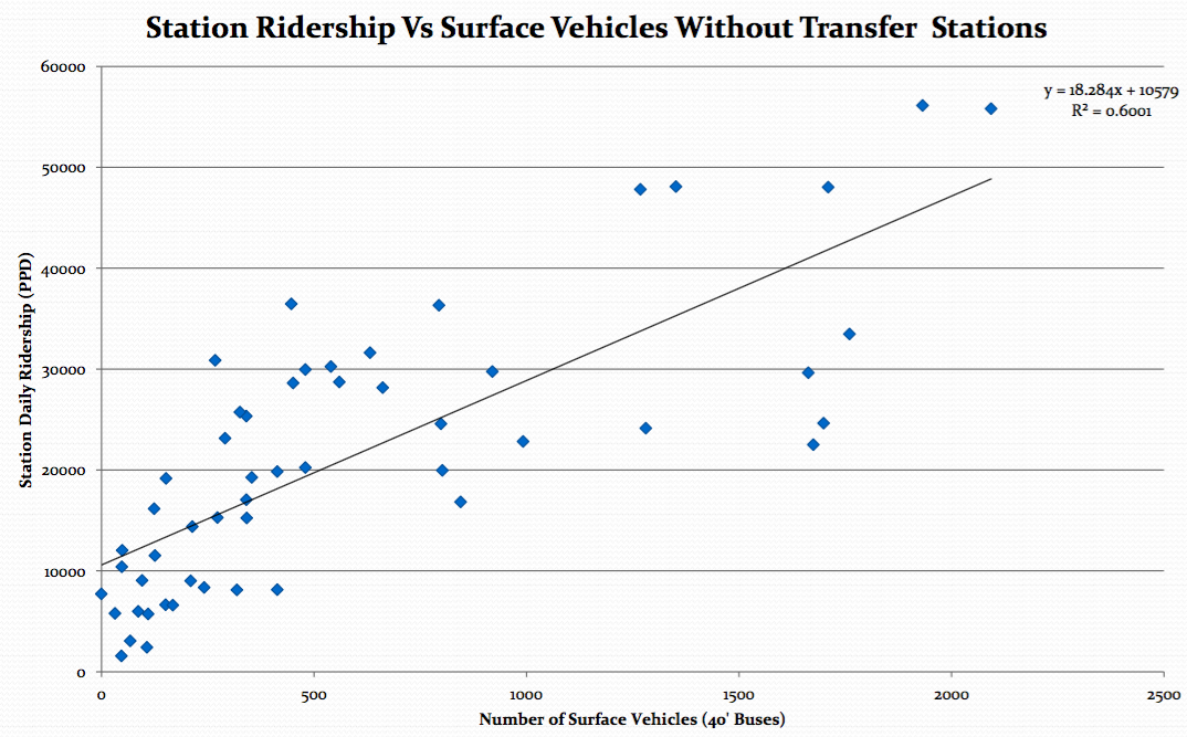

This graph shows a station's daily ridership in 2015 to the number of surface vehicles that serve the station (Yes, I painstakingly counted every single bus that serves a subway station per weekday). The R^2 value is low but it includes all transfer and terminus stations. If we remove these (Bloor-Yonge, St George, Sheppard Yonge, Kennedy, Finch, Don Mills, Sheppard West, Kipling, Union (GO Transit), North York Centre (GO Bus), Islington (MiWay), and a few others), this is what we get:

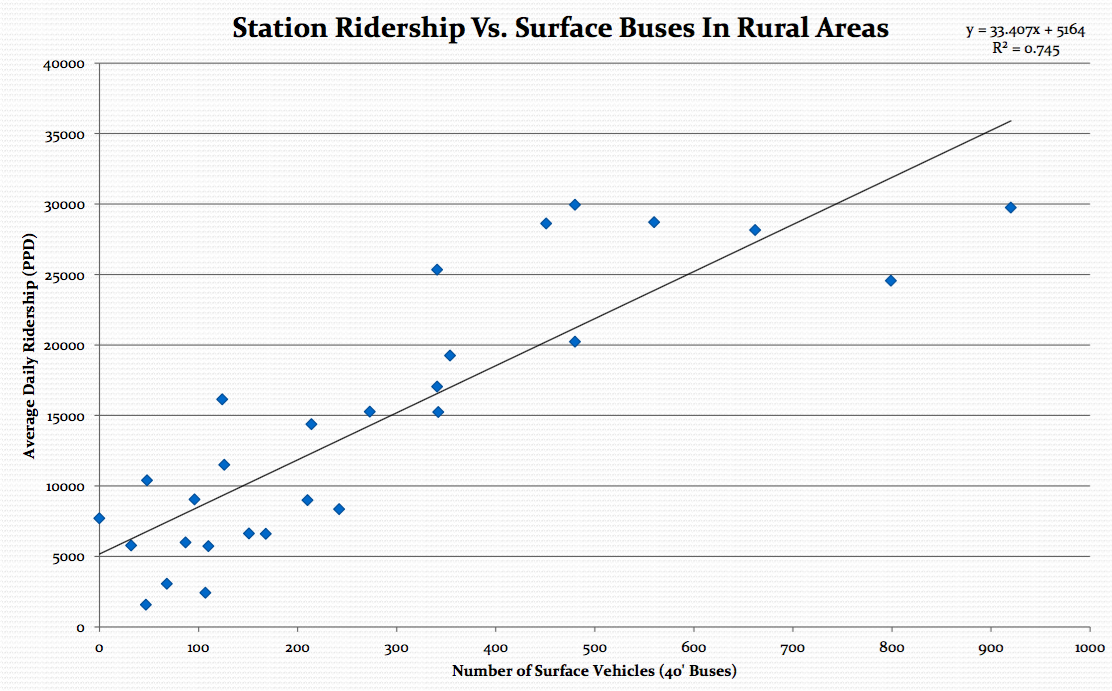

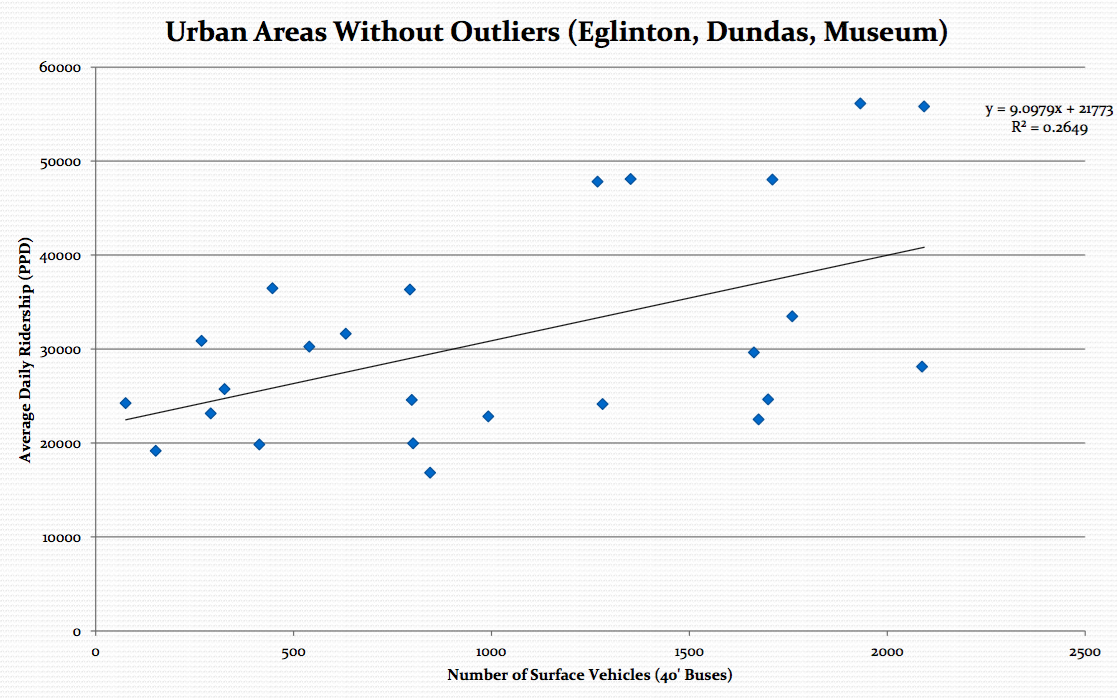

With an R^2 value of 0.60, there is a strong correlation. And it's not done yet. If we isolate urban and suburban stations, we get:
The correlation is so much smaller in urban areas than it is in suburban areas. The R^2 value is about 0.75! This proves that building extra stops in Scarborough is not going to do anything to help with transit ridership to and from the STC, especially at when going from other areas of Toronto. Yes, I agree that the Eglinton East LRT should be built, and should have stops ~ every 800 m. (Cut out a few redundant stops), because there are areas of Scarborough that should be intensified. However, like it or not, people will still have to take the bus to get to most LRT stations, especially along the existing RT corridor. The population densities are too sparse to serve anyone with the LRT plan, and no one is going to want to bus to the LRT, ride it with more stops, then transfer at Kennedy to the subway, then transfer in downtown to a streetcar. That is nuts. The ideal solution is an elevated line 2 along McCowan or the existing RT corridor with stops only at Lawrence and the STC. This way you don't spend excessive amounts tunnelling, transfers between buses and subways aren't insanely difficult, transfers are barrier-free, transfers are quick, there is no need to transfer at Kennedy, and capacity is there for the future.
