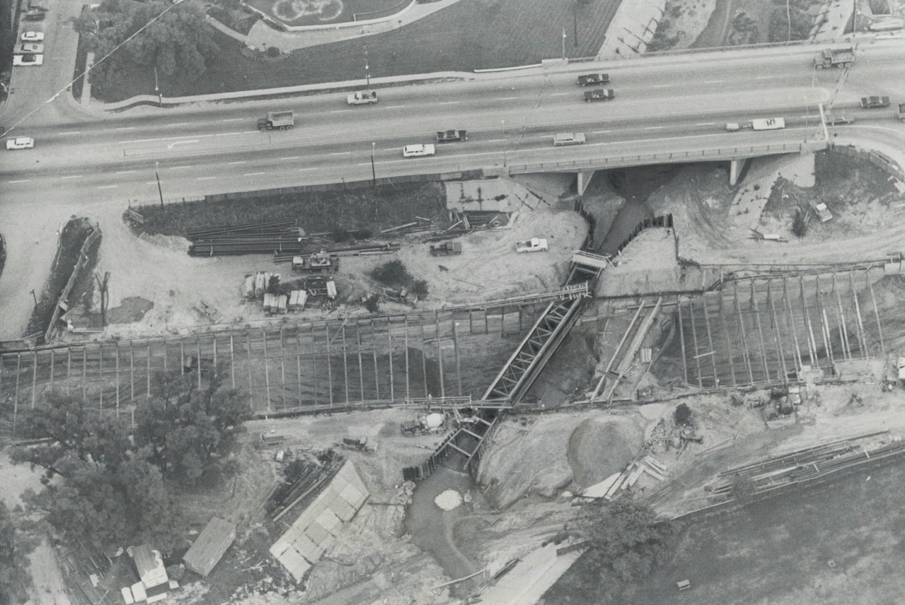

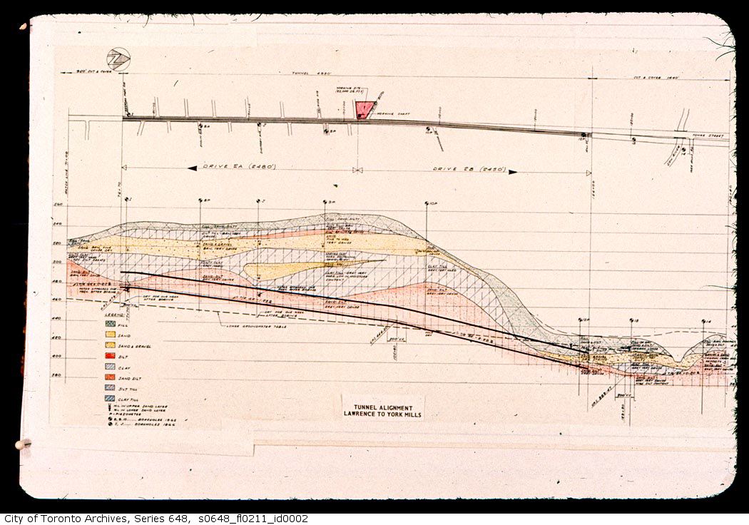

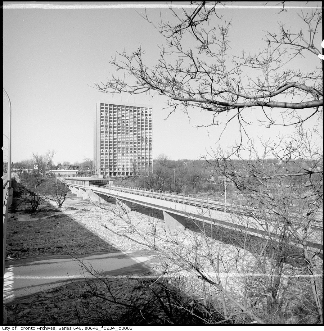

Am a huge advocate of affordable subway-building, but with the exception of Line 3 ROW/Uxbridge sub I personally can't see any realistic way of using open-air subways to get from Kennedy to SC. Midland, Brimley, McCowan are all fairly sleepy and not the kind of wide, honking suburbany arterial that'd be good for elevated. And trying to zigzag a way around this doesn't seem too logical. Considering we just built TYSSE into Texas-like industrial Vaughan I think it's okay to keep things subgrade, all things considered. Danforth Rd/McCowan alignment is good, maybe using the old Canadian Northern ROW. The latter is more direct but no doubt demands TBMs and subsurface property ownership from many homes.
Best step forward I think is keeping current alignment but bringing the craziness down many notches. No need for this ridiculous 100ft deep stuff. The topography, hydrology, geography, geology seem no different than elsewhere in the city. Don't care what City reps might say. Would require two tiny valley crossings which seem no big deal.
Just cuz I wanted to add these on when I brought this up before, here's how West Don was crossed when we extended to York Mills. The river was put into a box flume, then tunneled under with part of the station box underneath too. Take note of the pickup and cement mixer for scale. Waay larger than tiny a branch of Highland Ck.
And here's Old Mill when fresh. Same thing exists today, but good for showing an even more affordable means of valley crossing (with a station).
Then Leslie bridge on Sheppard
https://www.canadianconsultingengineer.com/features/civil-sheppard-subway-don-river-bridge/
