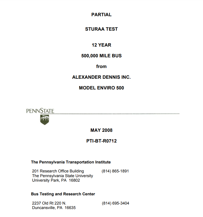

Addendum: Running short of time, but have located this for others who wish to peruse:
Screenshot from 2019-01-16 18-48-03
http://apps.altoonabustest.psu.edu/buses/reports/134.pdf?1442415368

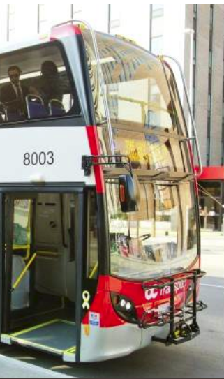

Regarding that image of the design of bus in question, there appears to be no impact or crush area in the upper design. I can foresee an interim decision to remove the first row or two of seats.
I can't see anyway around it. It's brutal how they've provided a 'balcony seat' rail...which only further invites passengers up against the most dangerous place in the bus. Even a branch blown loose by the wind could cause immense damage, or something blowing off a truck in front. It's a gorgeous view, doubtless, but even a bar lattice with structural integrity over the window would offer much greater safety.
