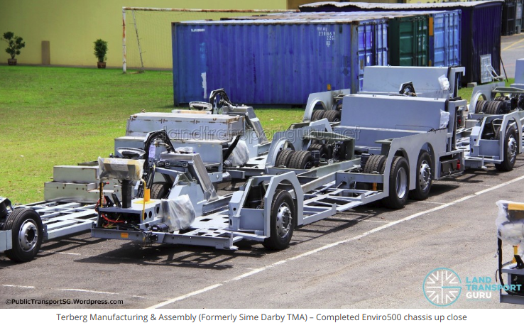

I've been trying to find more about the A-D body front crash resistance, because if you take a close look at their chassis at that link, (pic added at bottom of post) you'll note that other than the chassis front flange, there's nothing integral to the chassis itself for frontal strengthening. I defered from comment earlier in case there is a lateral reinforcement bar integral with the body that directly connects to the chassis, but I'm doubtful. Nova specifically mention 'two lateral stainless steel tubes to reinforce the front body against impact' (gist).

A proviso! This is from 2002. Seventeen years ago. A lot has progressed since then, and one of the 'innovations' has been ultra-light bodies....to the point of being *flimsy*. A-D exalts in their use of 'light metals and plastic' for the body. Nova, on the other hand, touts stainless steel for strength and longevity.
And this is exactly where the race to 'the lightest body' has gotten some builders into the 'damn the safety' mindset, since it's not mandated by Transport Canada anyway. The builders are now selling performance, and economy, and the best efficiency of operation for the lowest price, whether it fails to meets safety regs elsewhere or not. A-D, now the largest bus builders in the world, are specifically building factories off-shore from the UK to build to local needs...read 'regs', and China and Malaysia built ones are now feeding Eastern markets, save for the nations there with tighter regs (South Korea for instance)
Lightest bodies vs strength are proving to be a huge mistake, and ironically, the total vehicle weight is still above provincial requirements for axle loading.

They're generations ahead of us! I have to question whether the North Am produced, especially the Cdn assembled Enviro 500 could actually be sold in Europe in terms of meeting their safety regulations? I somehow doubt it...still digging to document and/or reference that.
Enviro 500 chassis pic:
While i can understand that, given the majority of the Enviro series is sold overseas. So, what is the difference between a European Enviro 500 and ours and would it have made a difference here. I can't see our market being large enough to make anything but the most trivial changes to the design that already passed EU regs.
Also i think crash regulations even in Europe expect the bus to collide with another vehicle or object at ground level, but this is specifically about a top impact, which is somewhat is a unique case.
