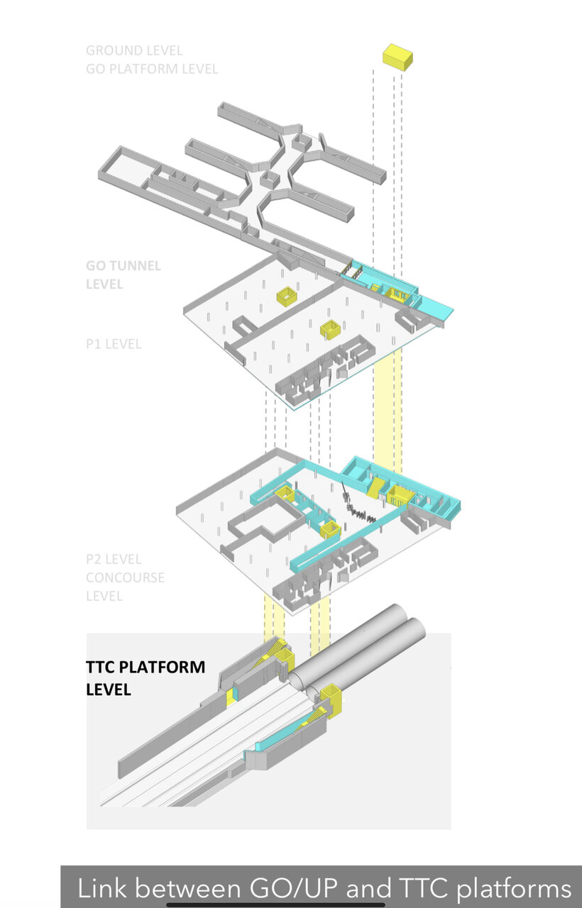

Fortunately, most of the connection between Bloor GO and the Dundas West platforms re-purposes the existing underground parking garage as the transfer concourse. The only "delicate" construction seems to be the elevator shafts that are right next to the live subway tunnels.
So looking at these plans the connection doesn't really have a true long tunnel section per se. It's mostly stairs and elevators.
Not sure if this update was shared here but its relevant to the progress of this project: https://www.metrolinx.com/en/discover/2024-progress-at-bloor-go-station
The WTR entrance looks like it will be done this year, but I would be pleasantly surprised if they are able to finish the tunnel to Dundas West station by the EOY.
