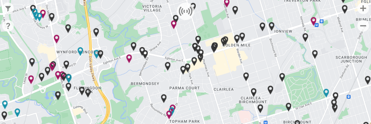

No one’s coming for a street car. Just look at how little development applications have popped up for eglinton east of don mills. It’s embarrassing. In the spirit of last nights sanity “subways, subways, subways!”

I'm sorry, but this comment is so far from the truth. Eglinton East of Don Mills has seen a massive increase in number of development applications. Here is UrbanToronto's own map with all the black pins being new applications for development.

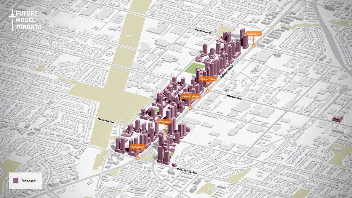

@FutureModelTO also released a picture of the developments currently submitted for the Golden Mile:
LRTs do indeed spur development. Arguably to the same level as a subway would.
