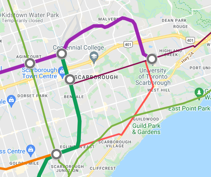

Ok...I read the business case..............I gave it some thought.............hear me out on a wacky idea............LOL
The line should not run from Kennedy Station, it creates too many operational hassles or financial costs.
Instead; build the missing station on the SSE at Brimley/Danforth. Run the EELRT from that station, you can do an underground connection to the mezzanine (I would) as it allows you to have the line skip the traffic lights at both
Brimley and Danforth.
But you can purpose-build the connection as shallow as plausible to lower the cost.
This reduces travel distance of the line by 1.4km and avoids the need to get in/around the SSE/Kennedy Stn/GO Line.
It eliminates (potentially) 3-5 traffic lit intersections through which the LRT would have to travel.
This produces a time savings in the range 6-8 minutes (gross) I would think (per direction) making the line much more competitive. (4-6 minutes net to travel to Kennedy by subway)
The cost savings of removing 1.4km of line should come close to offsetting the new subway station which I would estimate to be 300-400M in cost. (maybe less if we can do through a change-order before the SSE is under full construction that that location.
That's an interesting variation.
I've wondered if something closer to the SRT current corridor would be more useful. Build a new GO station at Ellesmere and an elevated line east to the Line 2 Scarborough Centre station (at McCowan), then follow Ellesmere east until Military Trail. IMO, a GO connection will be viewed as more useful than a TTC subway connection in the next decade; strong GO service (with price parity?) will rapidly replace subways for much of the backbone network; but connecting to both is best.
I tend to think Kingston Road itself is better off with a busway: abundant stops with smaller and more frequent vehicles.
Wow someone with a similar idea that I’ve always had.
I have always thought there should be a SSE station at Danforth or Brimley. I was disappointed when Mattamy decided to build stacked towns at the former Caddy’s and not high rises…
As for the LRT…This is a great idea. Big cost savings. If there is going to be a transfer at Kennedy anyways between 5&7 then why not transfer to the subway and get over to Brimley much quicker. Having taken buses along this stretch of Eglinton many many times I can safely say not many people get off between Midland and Brimley anyways. Now, there is huge opportunity for condos on this stretch BUT Brimley would not be a long walk to these properties, and obviously there would still be buses supplementing this stretch.
My big issue with this idea is, say you're travelling from Line 5 to this new Eglinton East LRT. So you have to transfer to Line 2, then in 1km transfer again to this new LRT? All whilst travelling along the exact same street?
Fair, that's a bit of a hassle, I concede.
It really begs the question how substantial that travel pattern is of wanting to go from one side of Kennedy to the other, along Eglinton, with no interest in the Line 2 connection.
I don't have those numbers; if they are substantial, that's an issue; if they are a small minority of riders, its an unfortunate problem for them.
