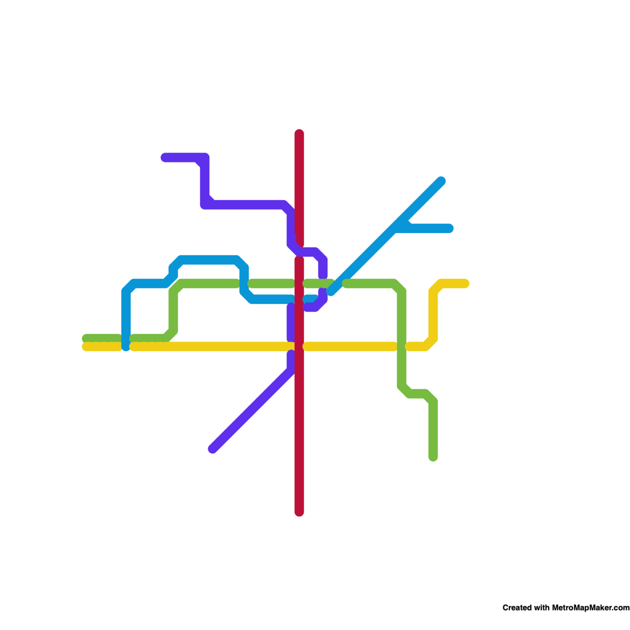

I have updated it with my vision for the LRT, within Edmonton confines only (didn't dabble into the CMA).
Schematic Map:
Explaining every line:
