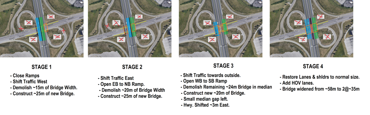

I have said before, I was hoping this bridge would be replaced, instead of reusing the abutments and piers as they are doing now. In 40 to 50 years, spalling of the abutment/piers will resume, whereas they could have got a 100 yr. design life bridge for marginal extra cost. How you rehab this bridge in the 40/50 year time-frame with an active LRT line will be quite difficult.
Anyway, shift the traffic west and squeeze the lanes. Then remove part of bridge and construct and widen to the east. Then shift traffic east, remove part of bridge and widen to the west. Finally, shift traffic to the outside and demolish and reconstruct in the median. Just to maintain traffic during construction, you could almost add HOV lanes for minimal extra cost - but there was no value seen in adding these lanes as they are not part of the plan. Both ramps closed in stage 1, while only the EB to SB closed in stage 2. I expected each stage to take about 6 months - so 1 ramp closed 6 months, and 1 ramp closed 12 months. Total construction (well the hwy 400 disrupting construction) would have been about 18 months.
The current bridge has ~19m spans. I was eyeing ~25m spans, to all an extra lane and wider shoulders under the bridge - while maintaining the profile of hwy. 400. Now, they are loosing a lane to the LRT. Actually, I heard that the change in LRT train order was a slightly wider train, and the current rehab design had to be adjusted (and compromised) to accommodate these trains.
