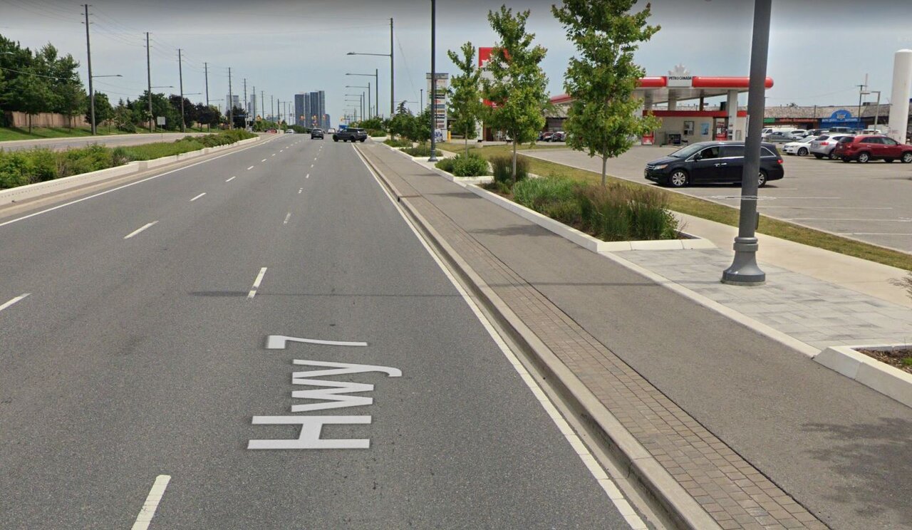

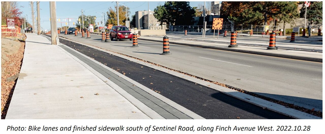

I noticed when driving through that these new bike lanes aren't at the same level as the sidewalk like on highway 7 (it's hard to tell from the picture), and in the presentation they describe the bike lanes as having "mountable" curbs so it looks like cars can easily drive into the bike lane. Would this count as grade seperated or did we get short changed here?
Finch bike lane from the November CLC
Highway 7 east of pine valley via google maps
From my experience, they are both mountable. There needs to be physical separation so that the cars are unable to park in the bike lane. Both "types" of lanes are an easy stopover for an Uber driver to park in.
