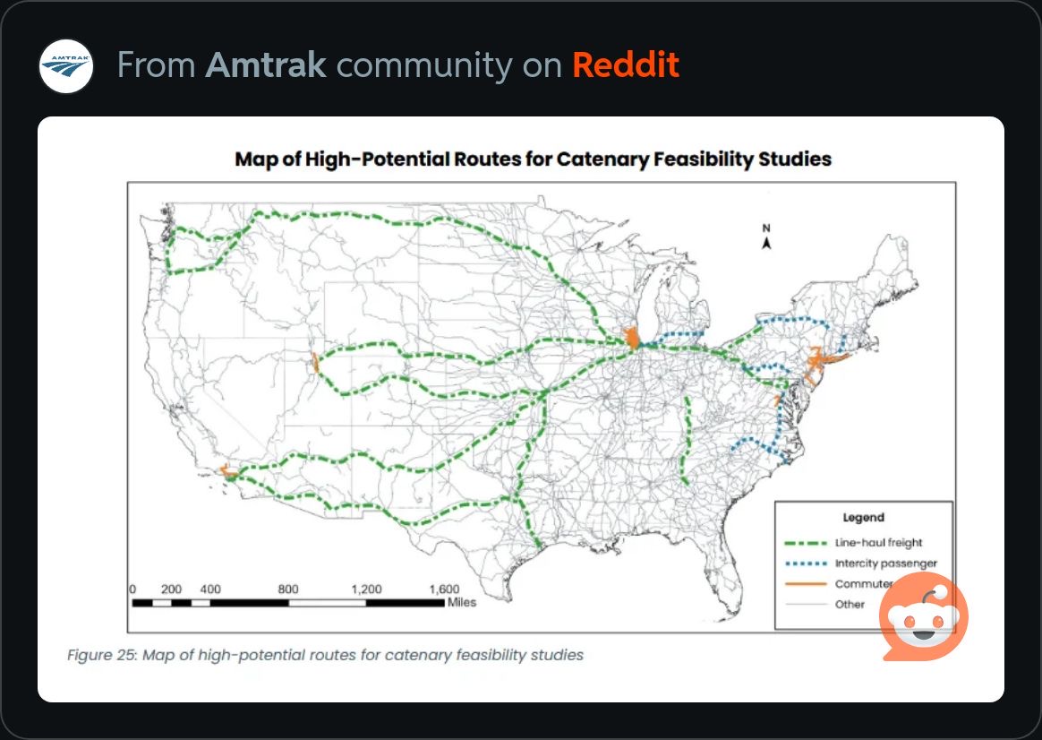

I haven‘t had the time to look at this study, but definitely looks interesting:
If Canada could do a phased approach, I'd suggest tackling the lines in the Corridor that have some sort of passenger rail on them. Converting the freight and passenger rail along there would likely be a sizable chunk of GHG emissions emitted by trains in Canada. It is interesting how that study seems to point at doing key corridors, not a blanket conversion. Doing that in Canada would be a prudent way to do it as well.

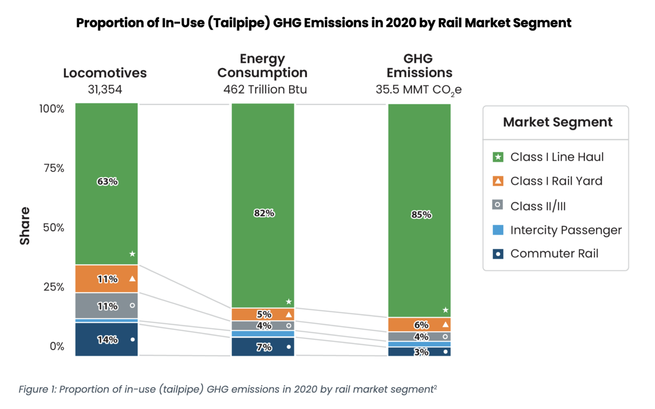

I'm still reading, but this chart was an early revelation. And we are in such a hurry to electrify passengers - GO, VIA, etc? Even a marginal impact on freight would be a bigger bang for the buck.
Yes - but. The intensity of use of the GO network means that impact per kilometre, and the corresponding reduction of GHG's in relation to the cost of electrification, again on a per kilometre basis, would be disproportionately better than the costs associated with electrification of the much more thinly used long-haul freight lines in Canada. Not to say we should not pursue the freight line electrification, but to prioritize that over GO Transit based on the statistics shown is not such a clear cut case.
And - the other major benefit of GO electrification would be the service improvements possible with better acceleration and overall faster times between stations - overall reduction in journey times for GO transit passengers.

If the government paid to have all the current GO routes electrified and CN/CPKC could use it, it would be a good incentive for them to consider making the switch, If the government paid to have the Via Corridor routes electrified with the same idea,that would really be a good push for CN/CPKC to switch over in those areas. They won't unless they can see a ROI within 5 years.
I agree, the GO network is a cheaper (ie more affordable) place to start, and electrification gives service benefits. But….a kg of Carbon is a kg of carbon - and the graph won’t improve much with only passenger electrified.
Ironically, the midwest line that shows the greatest ton-miles of traffic (which would be the logical line to electrify to get the greatest carbon reduction soonest) …. Has such a heavy traffic base because it’s a key route for coal from the Powder River. Switch those customers off coal, the coal trains go away, and the carbon produced thru rail miles would fall considerably all on its own. A similar improvement is possible if we reduce the demand for shipment of oil by ship, btw
I wonder if someone has done the numbers on the old Santa Fe line from KC to LA - it looks like the most attractive investment in terms of most sunlight and most tonnage. It would be interesting to know the potential cost per ton mile compared to diesel.

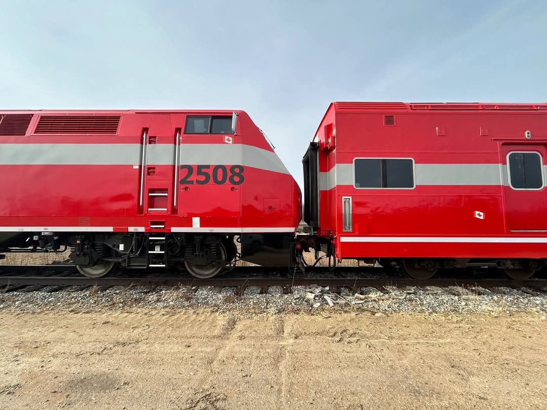

This equipment is much better than what they had previously
One concern I have is do the frames of these cars support the freight cars that are attached at the back of the train?
Also if they run the locomotives around the train they won't be able to provide HEP to the coaches, unless they put one on each end and have the second locomotive dead in tow providing HEP for the coaches.
