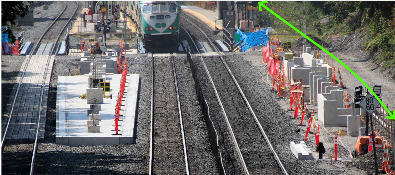

I can't remember. Are they also adding a 4th track here (green annotation on @drum118's photo)? cc @smallspy @crs1026 @Northern Light @reaperexpress
They're not adding a 4th track or platform as part of the current project. I hope they're protecting for one at least, I haven't noticed one way or the other.
This is another case where it would have been cheaper for them to build the station for quad track with two side platforms (same as the old Exhibition layout and planned Park Lawn layout), avoiding the cost of that island platform on the express track used by trains that don't stop there anyway. The station is only 2km beyond the current end of quad track (just west of Mimico) so quad-tracking through Long Branch would be a low-hanging fruit for capacity and flexibility improvements on LSW.

Thanks. Where is the quad tracking west of Long Branch going to start again?
There is enough room to add a 4th track but require adding a bridge over the creek. If I am not mistaken, Browns Line bridge is either a tight fit for 4 tracks or need to be rebuilt for it as it been too long since I shot it and looked at it to say which is right. There is enough room for 4 tracks from Long Branch to Burlington. You can get 4/5 tracks to Aldershot that has to be share with CN.
Any 4th track west of Long Branch would start west of the creek to the point there is room for 5 tracks up to Port Credit
I was told once that 4 tracks to Long Branch would require a new Browns Line Bridge, fairly pricey undertaking. Plus an additional bridge over Etobicoke Creek.
