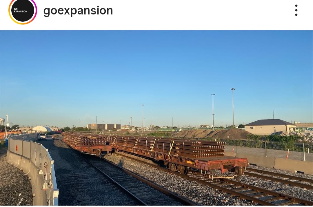

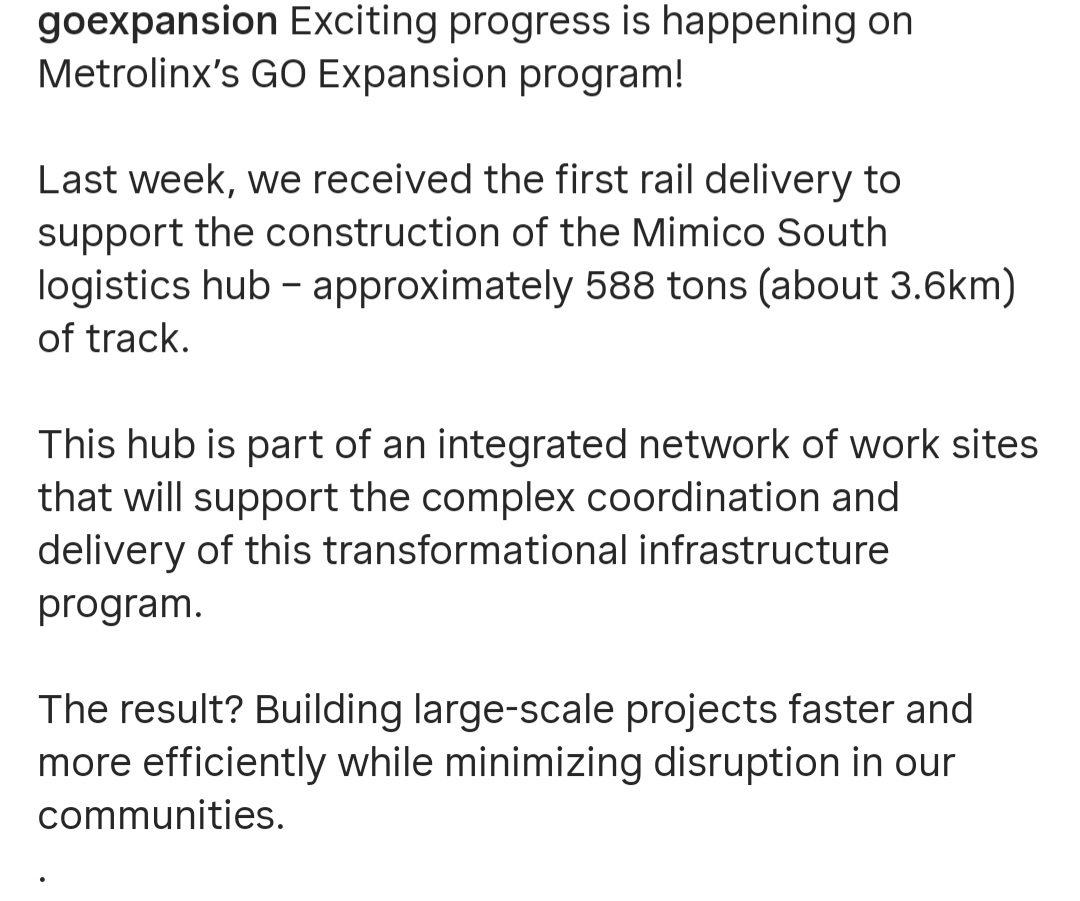

Posted on the Metrolinx IG account today. I wonder if this rail will be for the 4th track on the Lakeshore East/Stouffville Line.

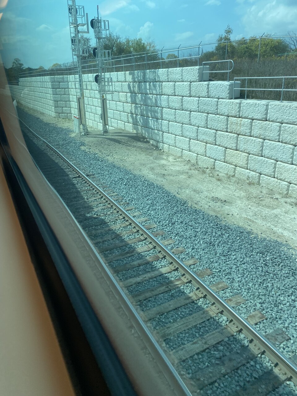

Some shots of the 2nd track work heading west out of Guelph Central.
Just before the Hanlon overpass

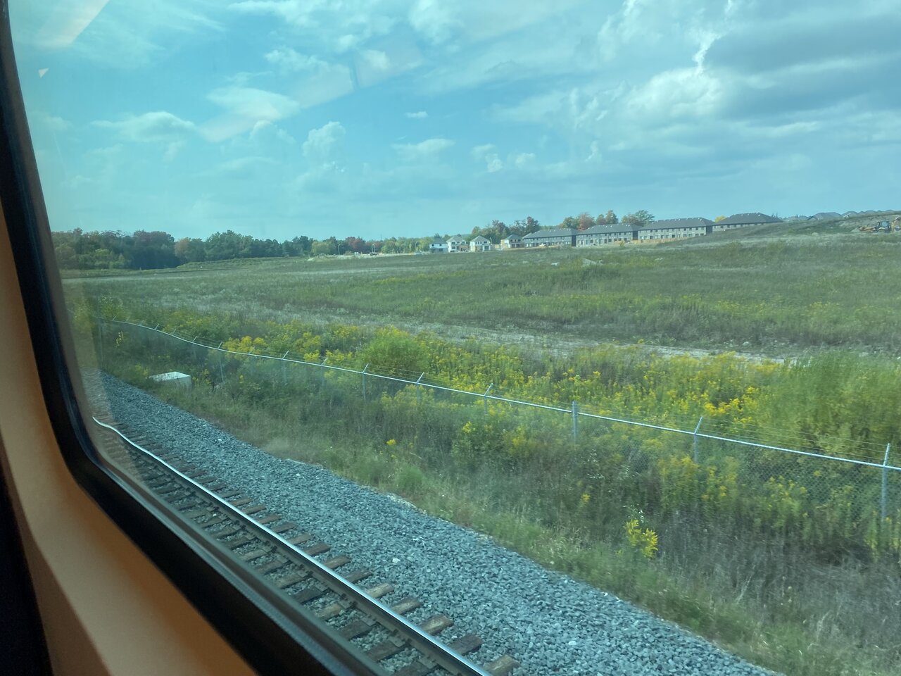

Future Breslau Station
IMO this station should be built sooner than later. The western edge of the Kitchener Line needs a proper park and ride station. Trying to get out of Kitchener Station after a train arrives is complete bedlam.
That's correct, the Region purchased land on the other side of the tracks from the original location and next to Fountain St.
The future Dolman St extension (phase 2 of the Madwest subdivision by Madison) will intersect Fountain roughly at the entrance for the future GO station.
The area won't be high density like some stations because of the proximity to YKF but the Region is still planning on partnering with a developer to get some affordable housing built with the station.
The Region is currently extending the watermain along Fountain to serve future development around the station. There is also a significant gravity sewer project in the works that will take sewage from the East Side Lands down to Kitchener's WWTP. I haven't checked holding provisions recently but it wouldn't surprise me if there's some servicing related provisions in place for the property (there's no existing water service for example).
