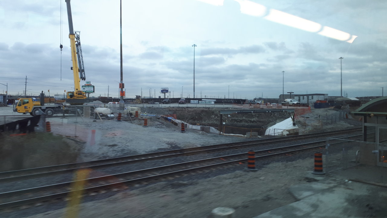

Blurry window pic of Torbram

I hope they accounted for these sound barriers being so close together! If not done right the sound can actually reflect off each side and amplify the noise.
Good catch. You have an intuitive sense of acoustics and waveguides. There is a way to mitigate the 'channelling' of the sound, and they're not doing it, oddly. I've seen the technique used under bridges on the GO system, and I'll look for a well-explained and detailed article to link later, but basically the technique is to present an 'anechoic' surface on the wall such that it scatters longer wavelengths in a way that the disparate directions from scattering/diffusing tend to phase cancel if the proportions of the 'diffusers' are matched to the wavelength(s) to be subdued.
I can see very real problems if they copy the opposing wall with the same surface in the pic.
More later, sharp eye! The term for the concern is 'Standing Waves'.
Must run, but quick Google shows these results. Not mentioned that I see in the cursory perusal is 'slotting' which I'll discuss later.
https://www.google.ca/search?q=Para...19j0j7&client=ubuntu&sourceid=chrome&ie=UTF-8
I'm amazed the neighbourhood reps haven't raised this issue. That being said, as long as one opposing surface is 'treated', the other can remain as shown in the pic. The clincher will be what they raise the other side. The posts don't look promising for something anti-acoustically active.
