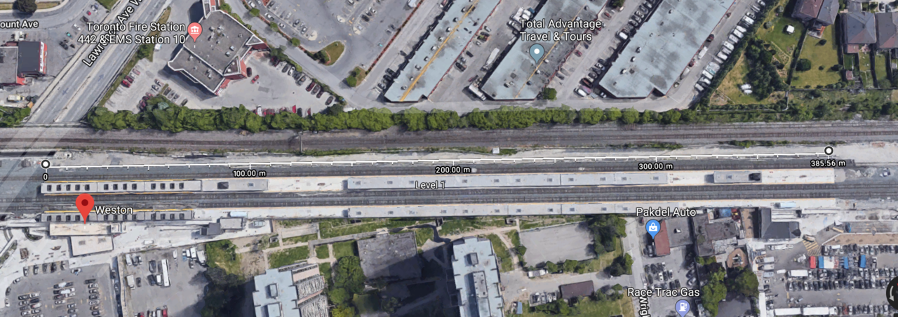

They need the extra platform once the new track 1 is installed. This will allow northbound trains to use track 1 and southbound track 2. UPX would continue to use track 3 & 4.
Based on all meetings for the station and the corridors over the last decade, the platform is to be a centre one to allow an 1A on the east side that would connect to CP track for the line to Bolton. Don't know if that still the case or not. If not, it would be a side one.
Track 1 is installed north/west of the station to south/east of hwy 401.
It would allow VIA to stop there if they want to.
So it would roughly go where I've drawn the measurement line I guess. I'd assume that another platform at Bloor GO is also in the works?
You are correct. The Weston platform is needed to complete the fourth track from the Interlocking at Nickle (a sidestreet south of Lawrence) westwards.
The fourth track from Nickle eastwards through the Junction and Bloor Station is a different project, and I haven’t seen any sign of it reaching procurement. It requires similar work at Bloor plus shifting the Railpath somewhat. Last I saw, there were consultations going on about that shift, but no resolution reached.

No new platforms are needed at Bloor GO - the existing eastern platform is roughed in for an additional track on the east side of it. Weston has a side platform, so it's final configuration will be side-centre-side in terms of platforms, while Bloor will be centre-centre.
True... the issue at Bloor is tunnels. When the fourth track goes in there will be no pedestrian access from the east side - needs an extension of the tunnels to a new entrance on the east side.

There were to be 2 tunnels at Bloor with the 2nd one north of the current one connecting to the Plaza. Both tunnels were to have entrance/exit on the east side of the Rail Pathway with elevators.
The 4th track aka as track 1 would run on the east side of the current platform that will become a centre platform from the current side one. Nothing other than tunnel extension has to be done to the current platform.
The current Rail Pathway will be shift to the east as well deceasing width wise to get track 1 in as well installing a fence for the whole area. The shifting of the pathway will be between Bloor and just north of Wallace Overpass.
The current bridge for track 1 over Bloor St still has to be shifted to the east to line up with the new track 1.

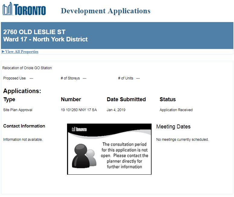

The Leslie Subway Station is to the left, the Oriole GO Station is the train bridge going over Sheppard Avenue East, and Old Leslie Street is the road bridge to the lower left.
Oriole GO Station is straight ahead (west), while Leslie Subway Station is to the right (north).
