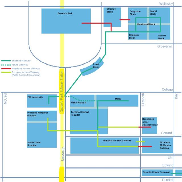

Unlike Hospital Row ( from http://urbantoronto.ca/news/2011/11/mars-phase-ii-integrating-queens-park-station )
November 11, 2011.
(Note the "restricted walkway" to the Legislative Building, which Doug Ford does not use. Would rather drive himself, by himself, to the reserved parking spot.)

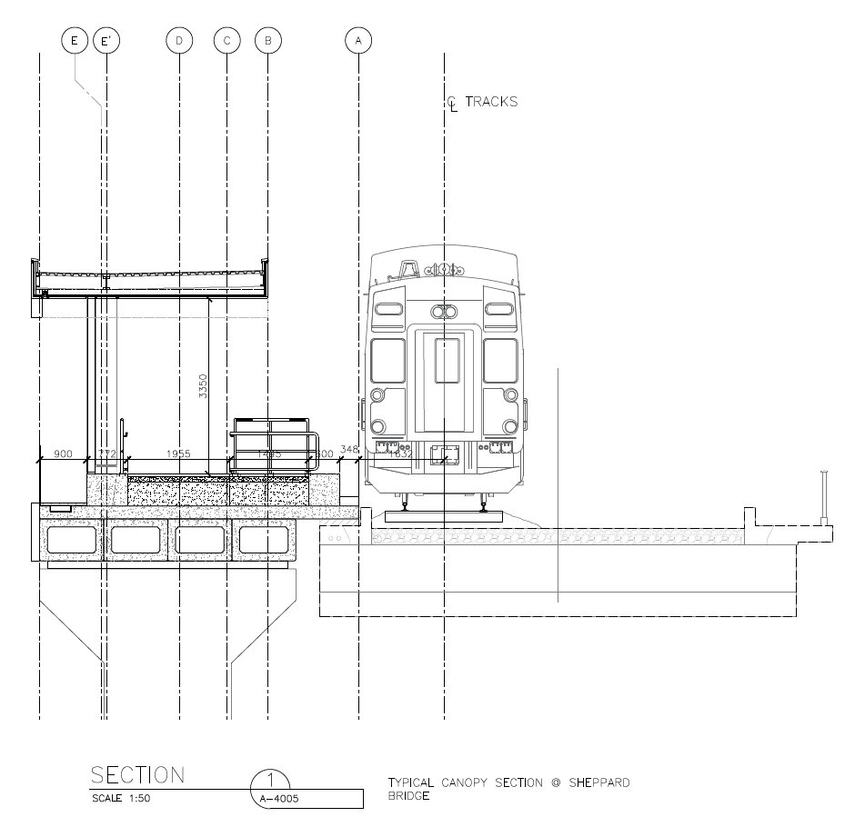

Looking at the section, it looks like theyre still intending to have a low platform height that isnt flush with even the bi level doors (assuming that the railing is for the wheelchair ramp section). Is there a reason for this? Have they not learned
that level boarding saves a lot of time?
The level boarding strategy, whenever it arrives, will have to be rolled out a route at a time. Can’t have a hodgepodge of los and high - the cars’ door sills have to be modified. Once modified, they may not be compatible with the old (low) platform height.
