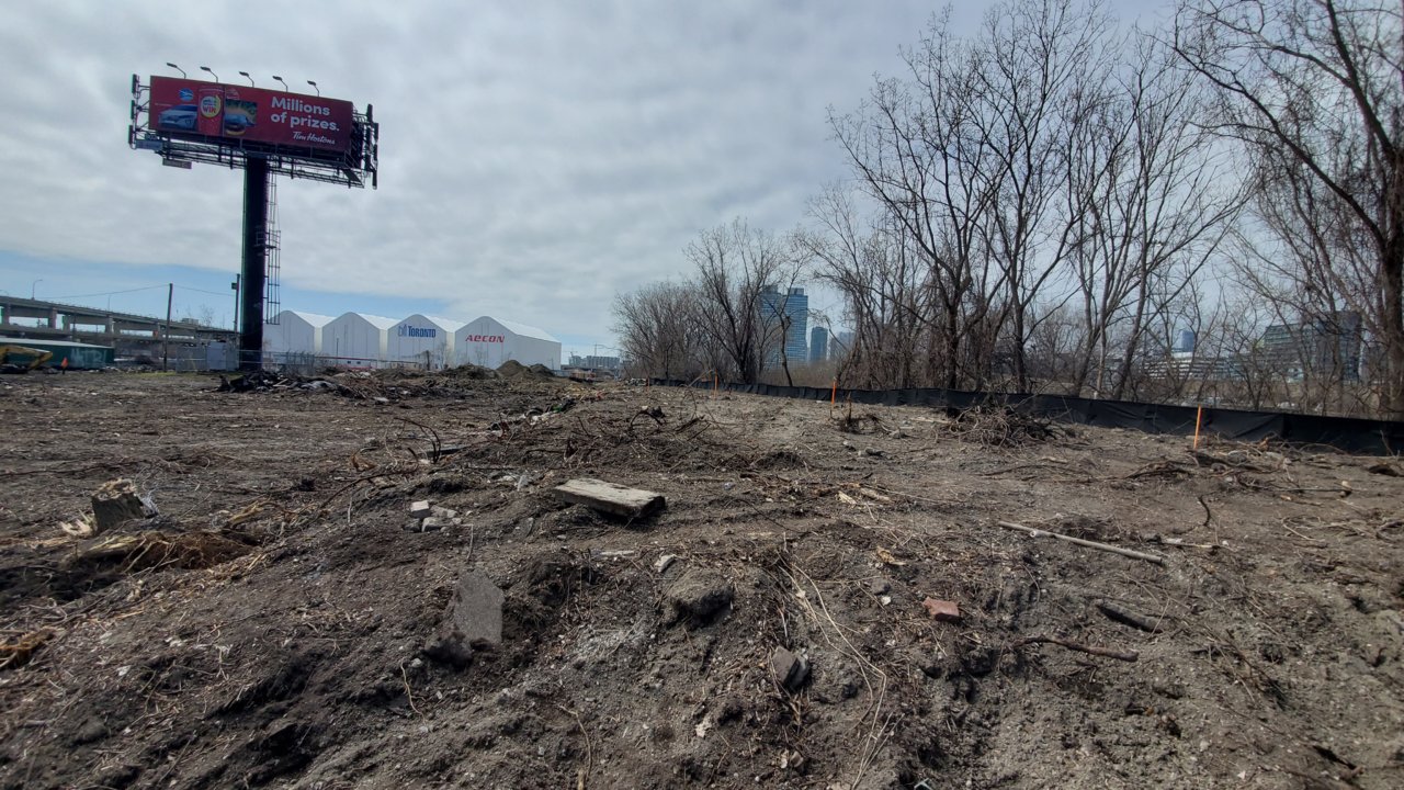

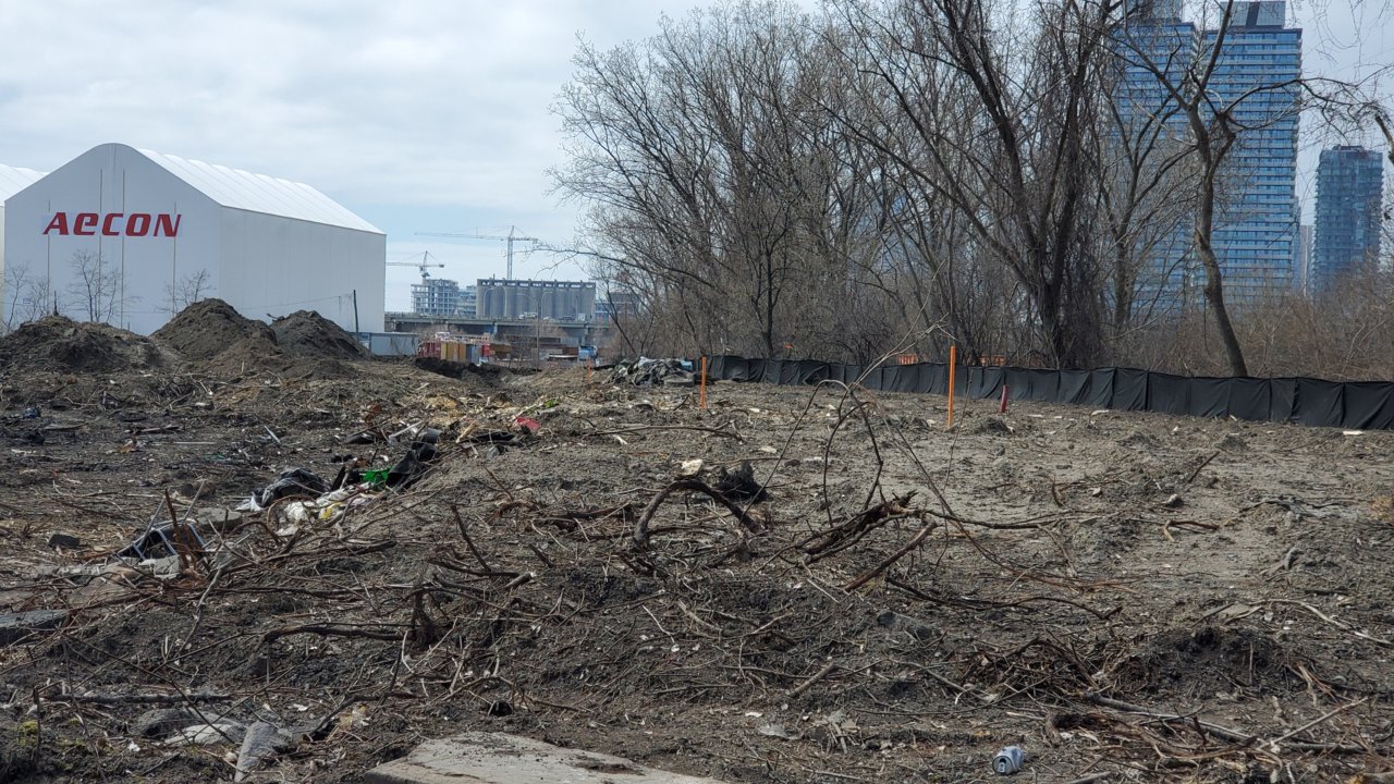

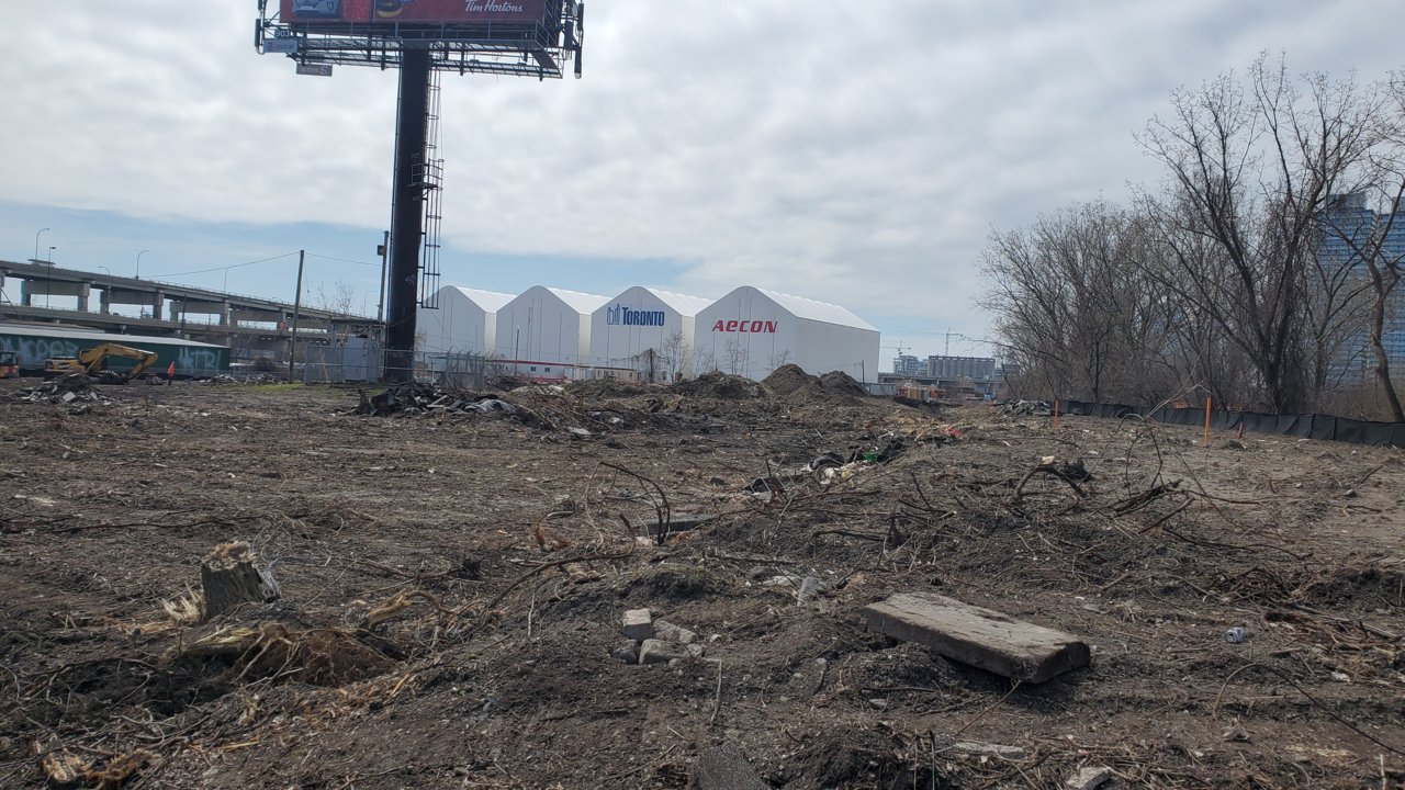

Is this construction/clearing for the new GO Willson Yard?
@smallspy @crs1026
