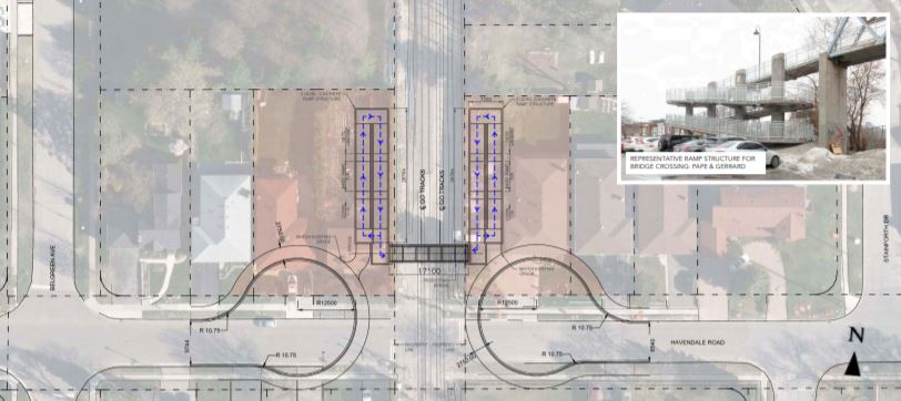

Havendale Road (pedestrian only)

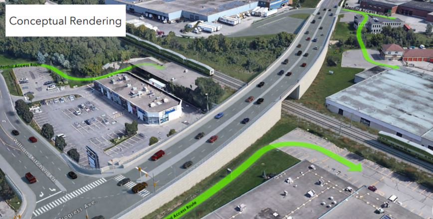

Progress Avenue
