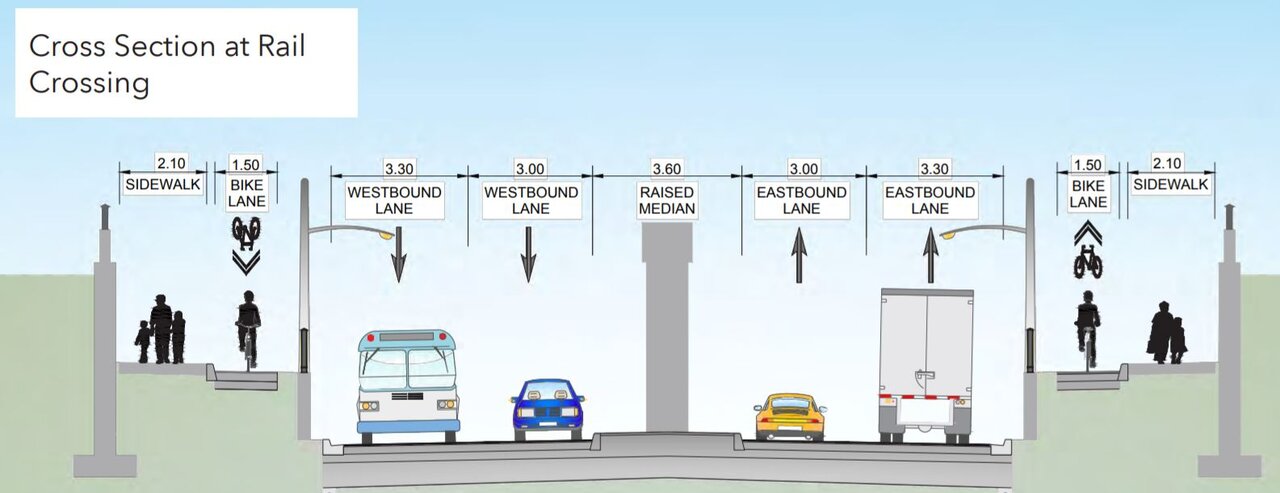

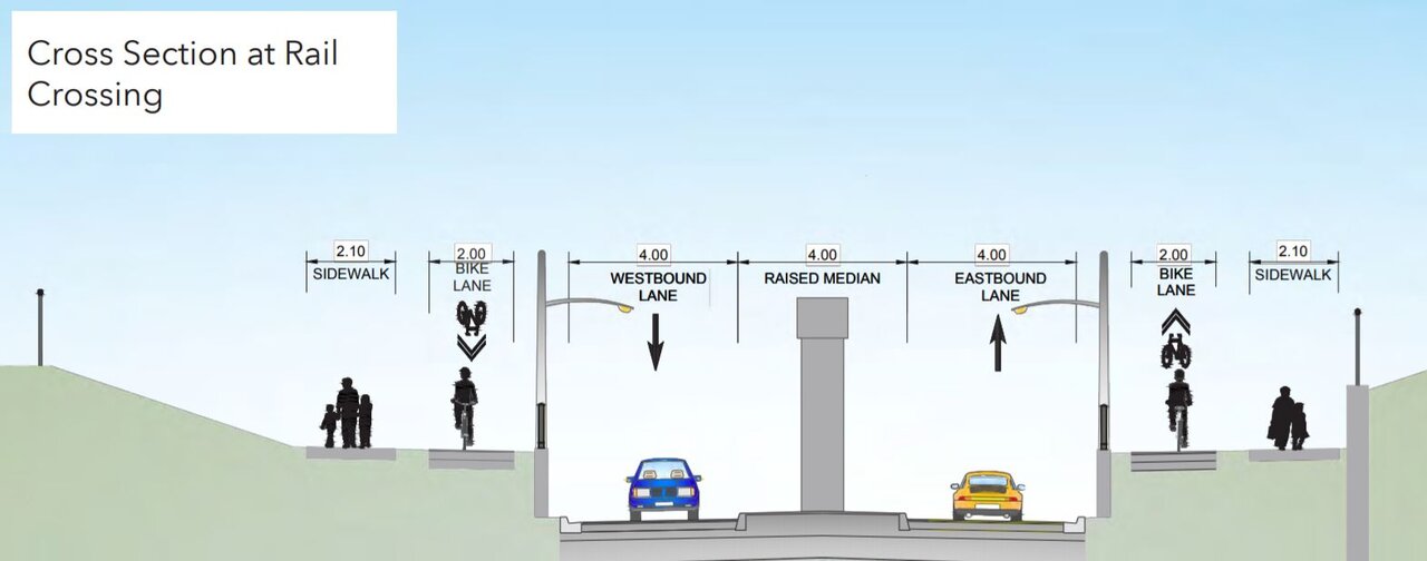

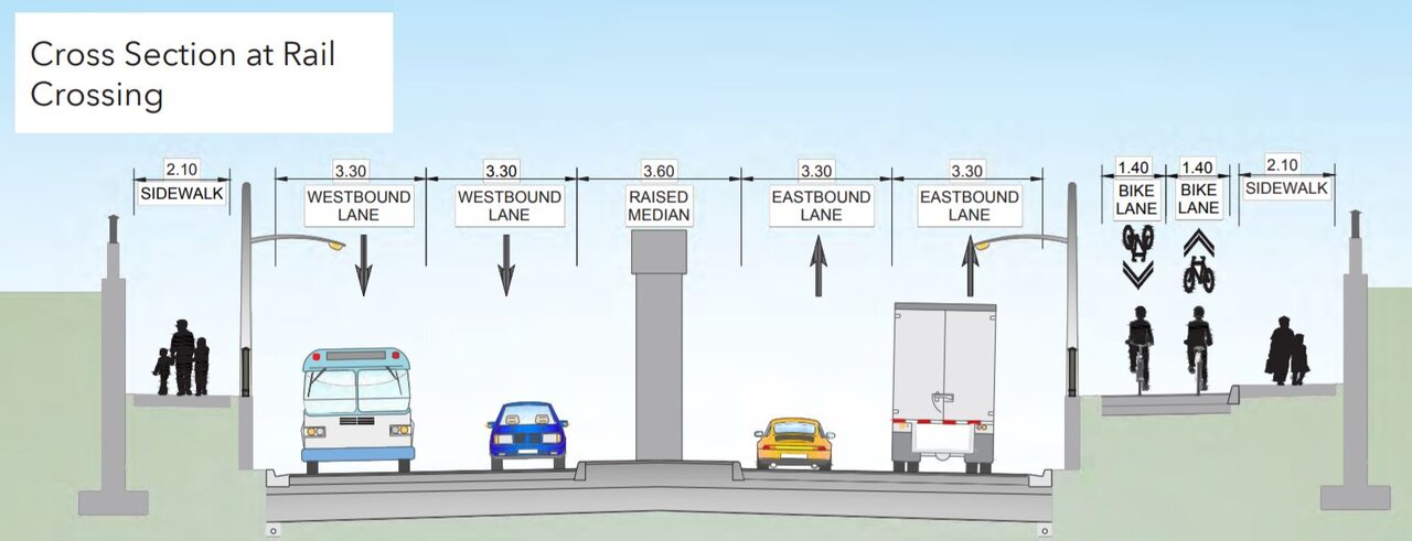

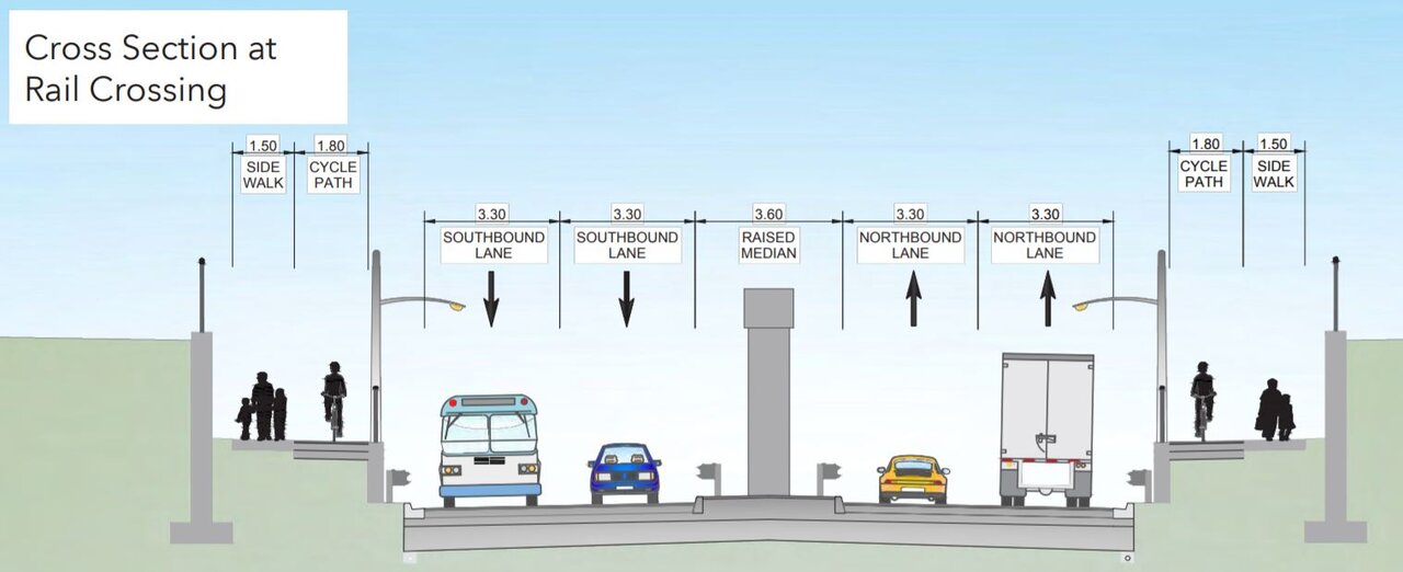

Sure, we could hope for separated bike lanes... Or we could just look at the proposed designs on the website.
Kennedy Road:
Steeles Avenue (from this report; cycle path in red):
Passmore Avenue:
McNicoll Avenue:
Huntingwood Drive:
Kennedy Road:
Passmore Avenue:
McNicoll Avenue:
Huntingwood Drive:

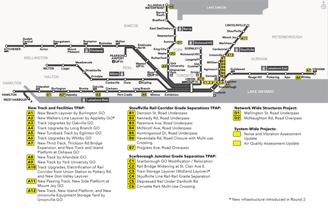

Interesting re A10 on the map. I hadn't realized this when seeing the PDF: " Metrolinx spokesperson Anne Marie Aikins said the agency has already revised its original proposal in response to public concerns, including by relocating the layover site from a part of the valley south of the viaduct, which the city deemed environmentally sensitive. It has also reduced the number of tracks required from three to one." (emphasis added)
The article does't mention it's using an existing (but not actively used) rail corridor.
I have commented on that thread, that I would support this project being used to relocate the Bala Sub from where the Don Branch begins to just north of Pottery Rd.
This would solve a big part of GO's Flooding issues, and would also allow restoration of more than 5ha (12.5 acres of land.
On top of which it would allow pedestrian and cyclist access to the valley from Rosedale Valley Road and opposite the Brickworks with the choice of running a parallel trail on the west side of the river, or crossing over with bridges to the existing east side trail.
In a formal submission, I also suggested they could reforest the DVP embankment (from the DVP down to the valley bottom) as an off-set measure.
Looks like the article has been updated with a site plan map (created by the Star I assume) and a picture taken by the Star of the location. The site plan map doesn't show the multiuse trail (or maybe it does and they just didn't label it).
