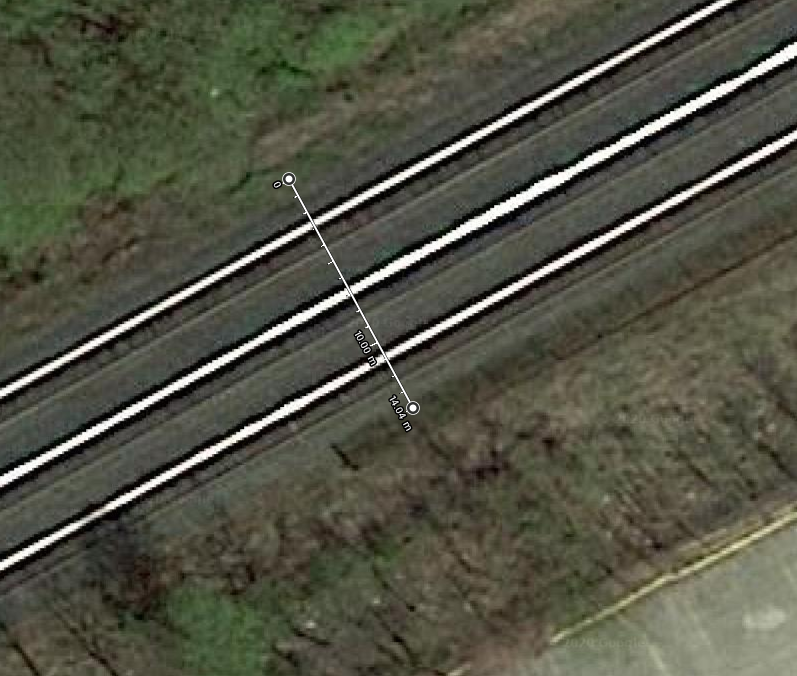

Quick question here for those more familiar w/railway construction practice than I;
Looking at the Small's Creek cross-section, the existing ballasted area is ~14M; if it comes up short its by a small amount, on fairly level ground, to the naked eye.
14M should be, to my understanding, what's required for 4 tracks.
So why does the scale of the intrusion/expansion seem so large relative to the space required?
Do they need extra room just for the noise barriers? I'm just curious, as it seems a bit odd to me.
@smallspy , @crs1026
^I can't speak to how steep the side slopes ought to be - but - Electrification will require space for poles on the outside of the track clearance, and signal towers - and they may want some flat ground for work equipment and for people safety outside of the tracks themselves. Also for signal bungalows, which may need a bit more clearance on electrified lines.

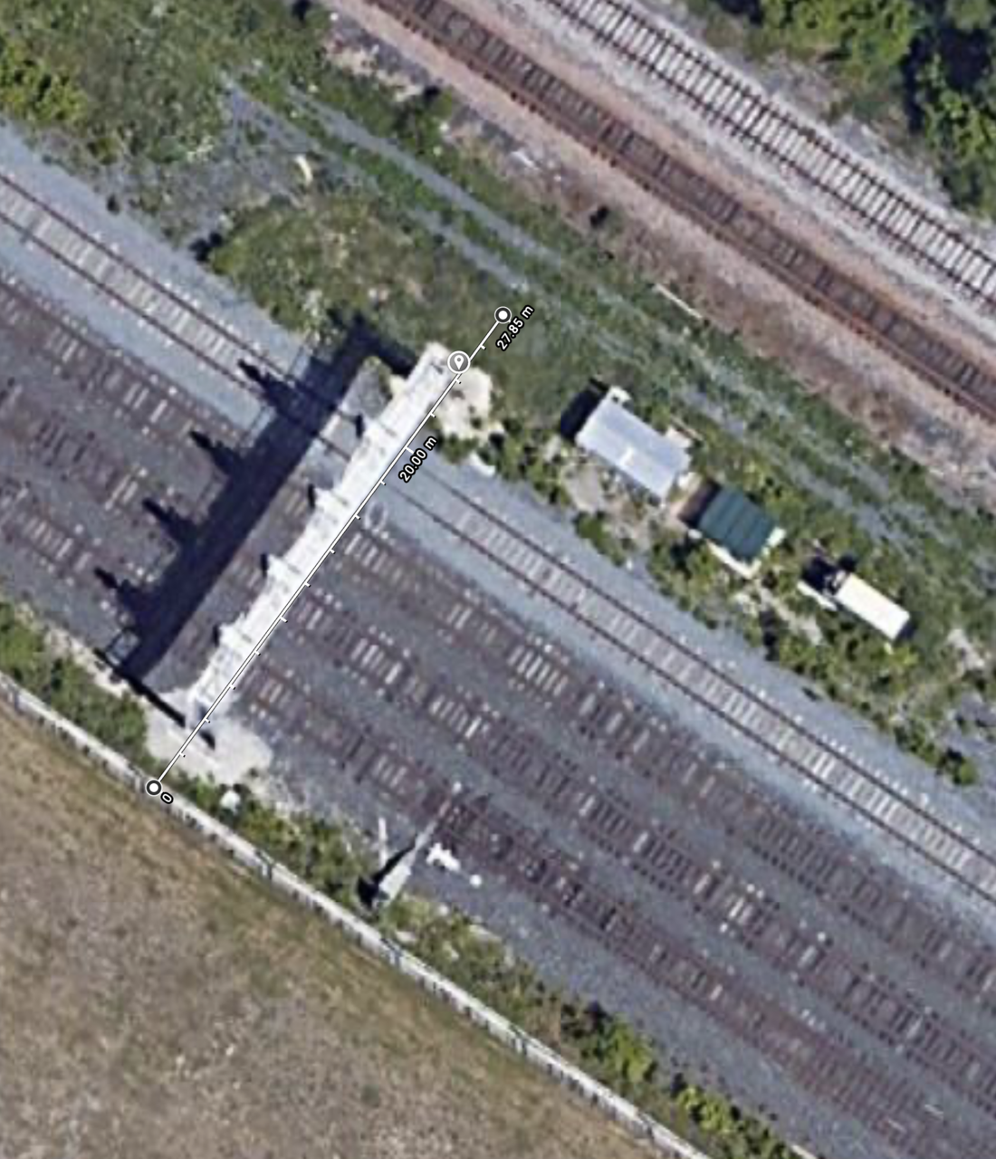

A comparison might be to the Weston Sub - here's the Weston just north of the Nickle Interlocking - 27m from one sound wall to the outside of signal bungalows on the other side.
PS - the Weston Tunnel is about 19M wide.
While the ballasted area may "only" be 14(-ish) metres wide, the subroadbed and the structures required below it are far larger than that.
The shoulder of the subroadbed sticks out at least another 1.5 to 2 metres from the edge of the roadbed - and can be more where an allowance is made for a fourth track or a maintenance access road. And its slope away from the tracks are generally prescribed to be a 2:1 or 3:1 gradient.
