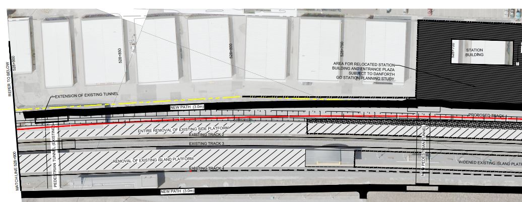

The new layout for Danforth Station is definitely not what I would have gone with. The station is shown with two island platforms (i.e. quad track express configuration), but this creates a whole bunch of headaches due to the need to shift the outer tracks around the platforms:
From page 14 of the EPR linked above:
The fourth track contains track separation from the existing Track 2 through Danforth GO Station. The Danforth GO Station future platforms will consist of two (2) islands. The platforms will also be relocated approximately 170 m east to allow the track not to impact the existing Main Street overpass.
The new track will take the place of the current westbound platform under the bridge.
This will make access to Main Street considerably less convenient than today, which in my opinion is a very big deal given the effects on access to Main Street Station. The reason the station is being shifted east is to allow the centre express tracks to have platforms, but without a convenient connection to the subway it wouldn't be worth stopping express trains there anyway. The area itself is quite lively, but it's not a destination to the point that many people would specifically heading there from Durham Region. And I say that as someone who used to live next door to the station.

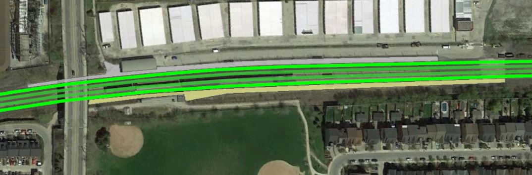

In my opinion, it would be better to set up the station as local station with side platforms on the outer tracks only. Most importantly, it would allow the current westbound platform to remain as-is, along with its convenient access off Main Street. And the new eastbound platform would be accessible from the existing south exit from the pedestrian tunnel just east of Main Street. The new eastbound express track would take the place of the current island platform, and the new eastbound local track would be roughly in the position of the current eastbound track.
Existing side platform in grey, new side platform in beige:
On top of being much more convenient for customers, this configuration would also be much cheaper to build, because it:
- doesn't require the rail corridor to be widened at all
- avoids the need to extend the current pedestrian tunnel northward
- reduces the number of elevators required in the new pedestrian tunnels from 4 each to 2 each.
- avoids the need to rebuild the current westbound platform to the east

The most recent set of roll plans released for the electrification/additional tracks/Scarborough Grade Separation show that the existing Danforth Station will remain as-is, with a fourth track built on the south side and with a new platform servicing it.
Just to keep everyone on their toes, I guess...
do you mind sourcing that? i found this, which isnt exactly specific on new tracks or platforms for Danforth https://www.metrolinxengage.com/sites/default/files/lakeshore_east_roll_plan.pdf
That's the one and the same. It's not very clear at first blush, but if you look closely around Danforth it shows tracks 2 and 3 realigned, with a 4th track located to the south. For whatever reason, they chose not to show track 1 through that section, although it does show crossovers leading to and from it.
