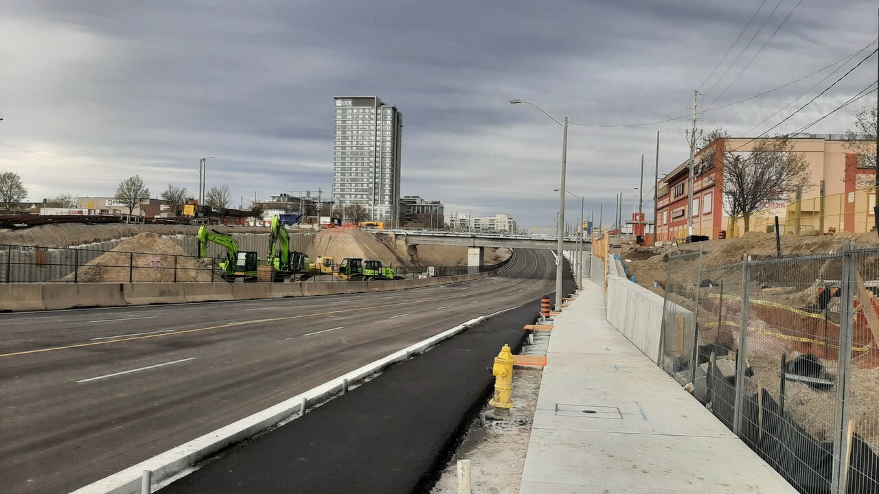

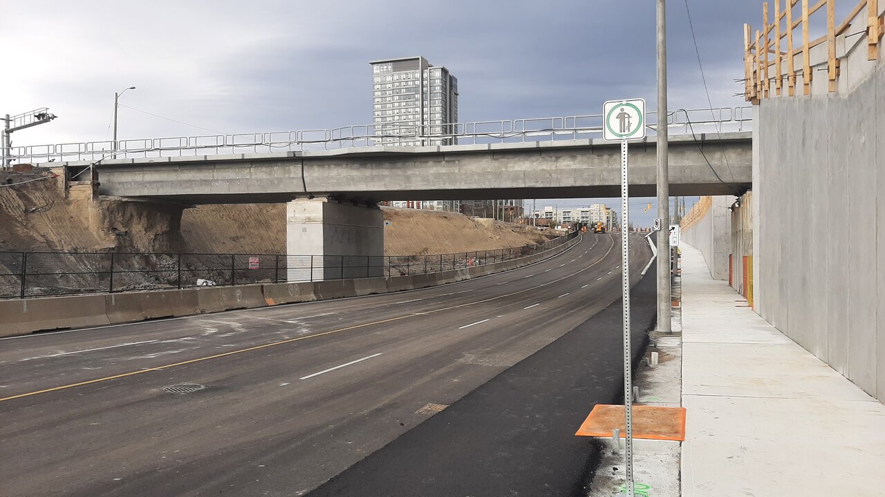

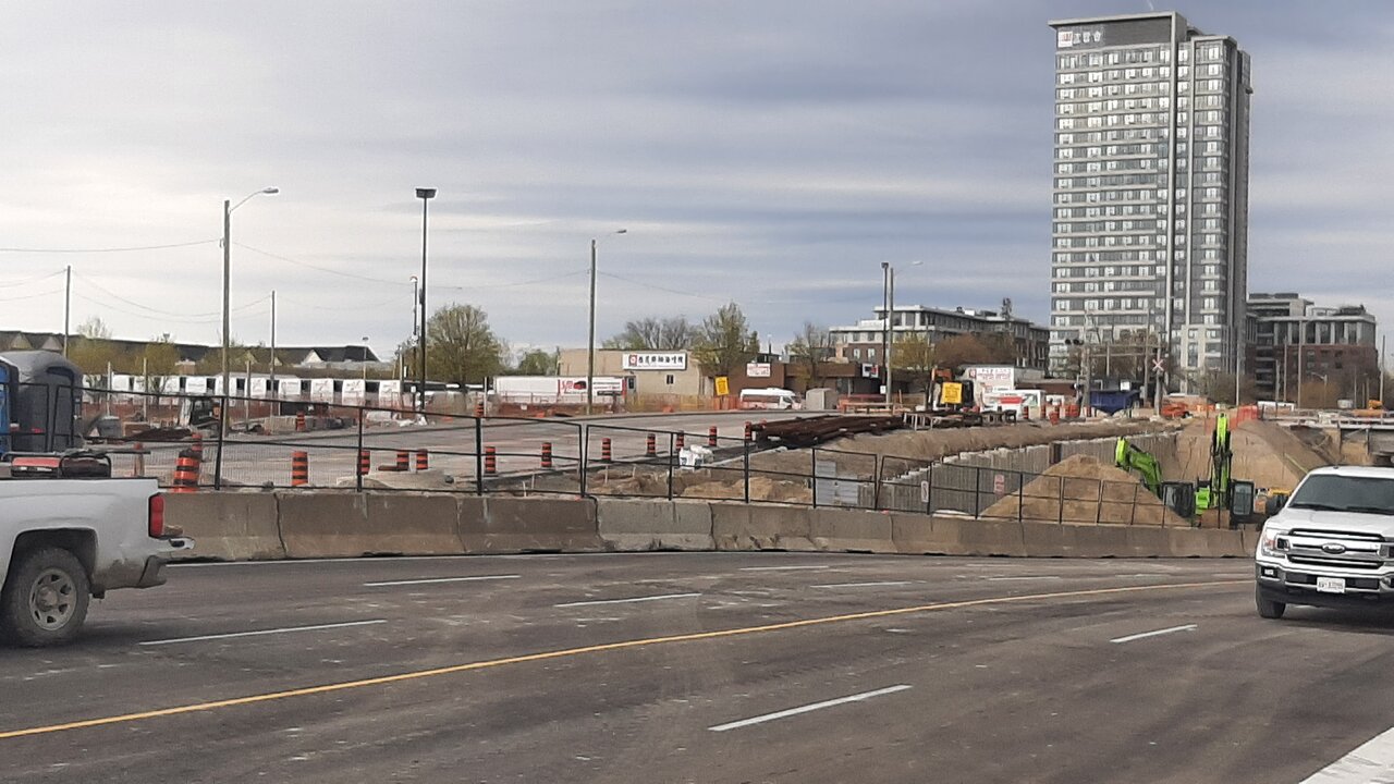

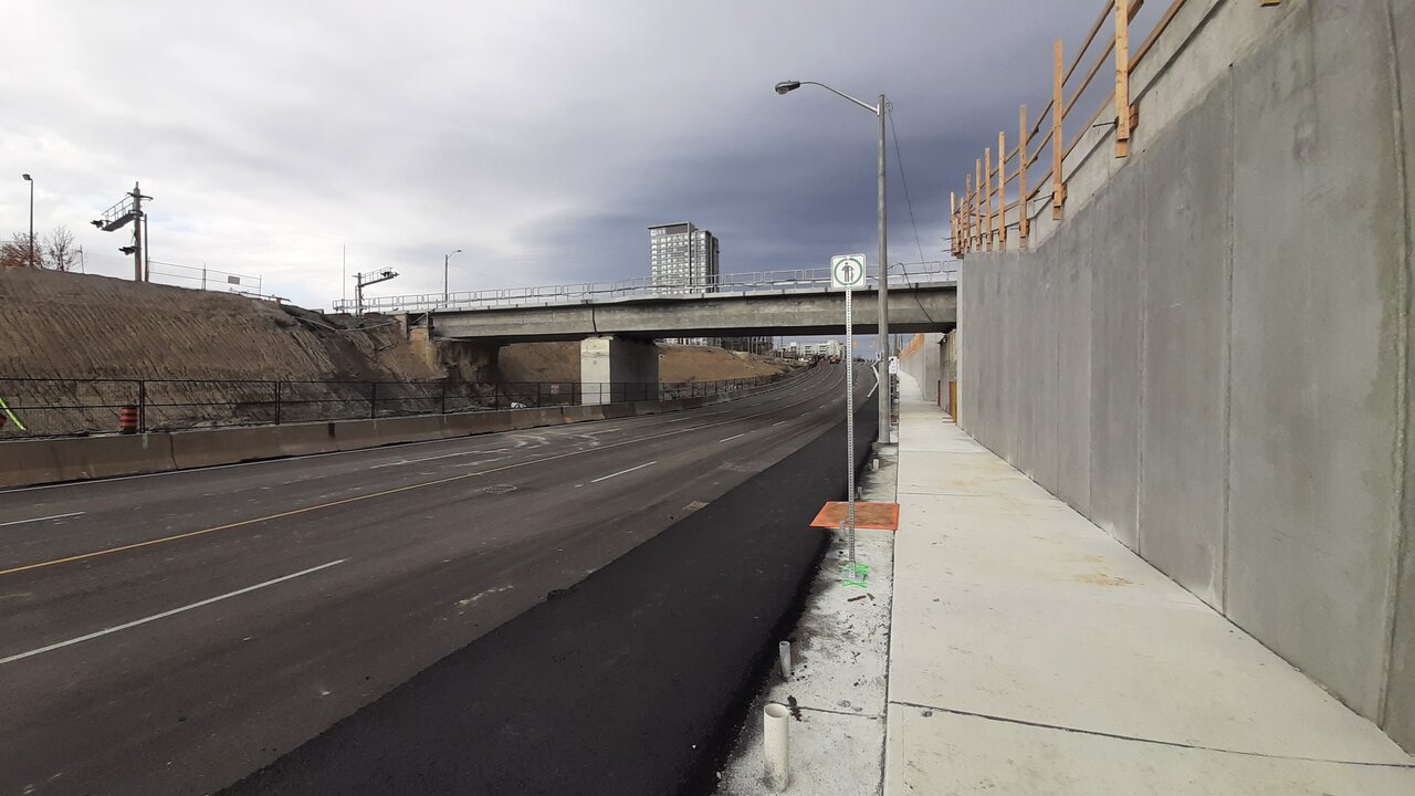

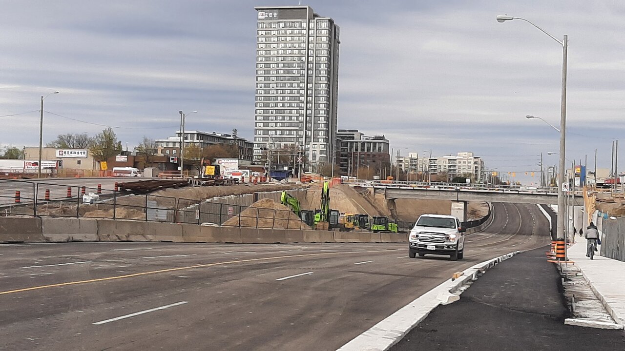

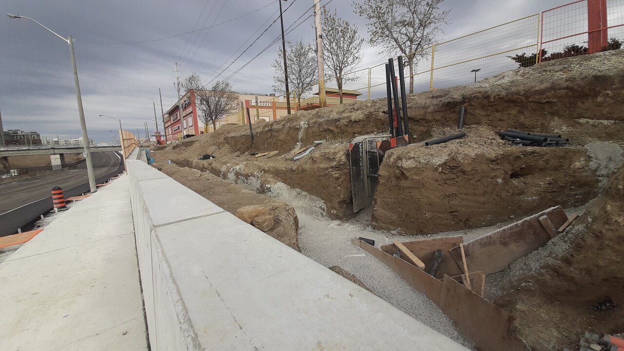

Steeles grade separation from today:
The above does not seem to reflect this render:
Looking at how much space there is between the support pier and the side wall; hopefully the final product will look more like this.
Though, if that's the case, they are going to have to rip a lot of asphalt back out...........which seems a tad wasteful.
