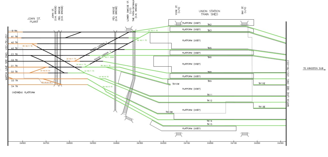

That's why ML has been noodling on how to rearrange platform allocations at Union to maximise the throughput through the ladders and flyover between Union and Bathurst Street. Several ML documents have shown different layouts and I don't know if there is a final official version. Having the tracks narrow from 8 to something less on the Weston corridor, and merging with the four from the Oakville corridor, isn't a problem per se... provided the number of moves requiring crossing over is minimised.
This is the most recent layout I've seen. Not sure if you've seen this one. This is from a noise and vibration pdf released back in December. Pg. 88/89 to save you the trouble.

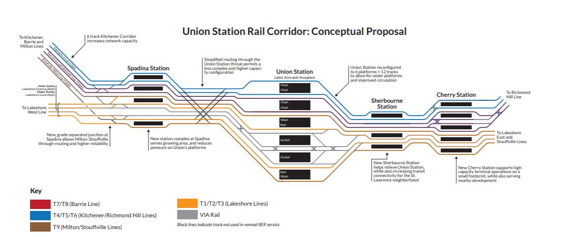

^Thanks for that! The previous page is also relevant as it shows how the 8 tracks from Weston merge with the 4 from LSW. Note that the Spadina station has been inserted, and the LSW no longer uses the flyunder in the same way.
From the top:
- 2 tracks to Barrie (with stop at Spadina)
- 4 tracks to Bramalea/Georgetown/Kitchener
- 2 tracks to Milton
- the Western Lead aka "back route" to Exhibition - which had been disconnected, last I looked
- 4 tracks to LSW

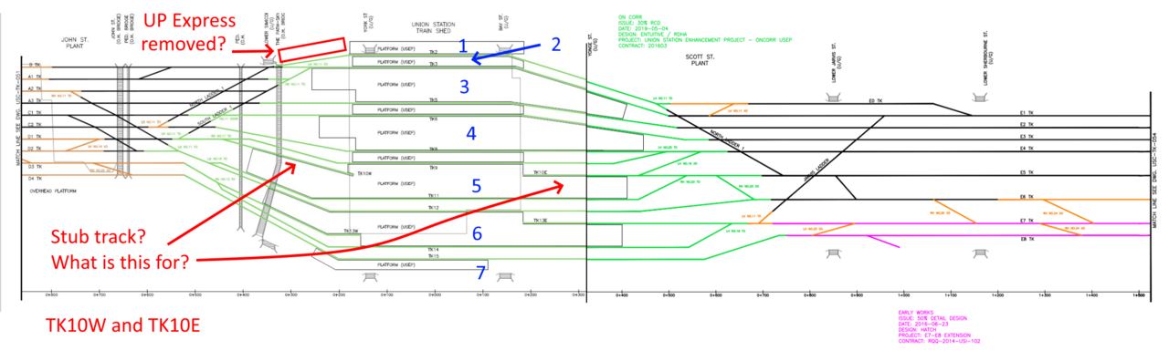

Great find with that Metrolinx Union Station track plan map. I just have some questions/observations in the graphic below (I added in the eastern side on page 89). I annotated in blue numbering the platforms I think I see. cc @reaperexpress @crs1026 @smallspy

My uneducated guess for the 4 stub tracks TK10E, TK10W, TK13E, and TK13W is for VIA departures; and potentially other express train departures depending on the platform length. VIA arrivals can unload relatively quickly and then pull forward and back into the stub tracks as they prep and wait for loading as departures.
