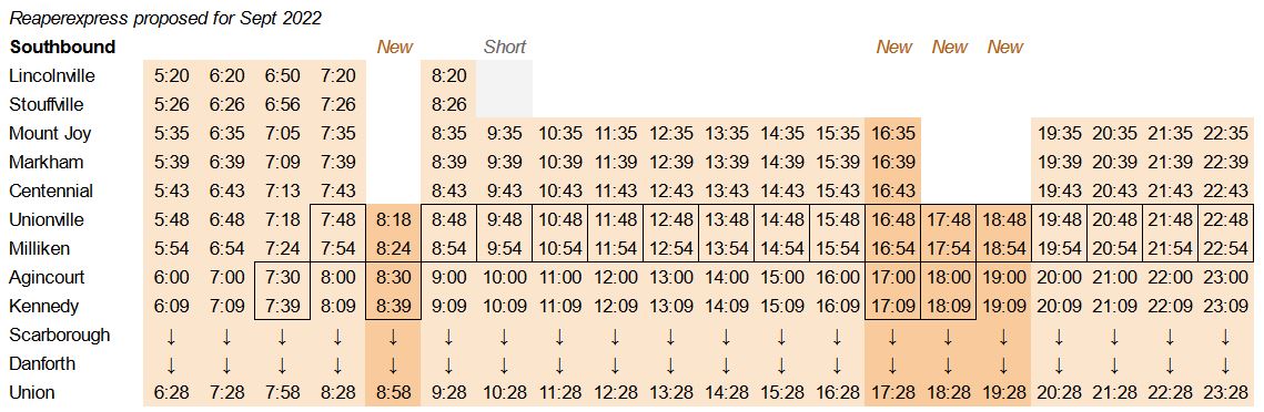

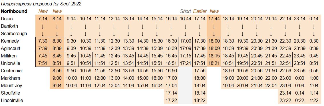

Yeah, I think you're right and the second platforms at Agincourt and Kennedy will sit unused for at least the next year. In the meantime they will just use the nearly-complete passing siding between Agincourt and Kennedy to slightly increase service.
Here's a concept for how that new siding could be used to introduce counter-peak service and add one additional peak-direction trip.
Changes compared to the June 2022 schedule are highlighted. Train meets are outlined in black.
Unfortunately it is not possible to have full counter-peak service to Mount Joy until a second platform is built there. Trains to Old Elm need to be able to pass through while the terminating train is sitting in the station in preparation for its southbound run.

I don't think Metrolinx will implement the schedule you are proposing. In the afternoon peak, the Stouffville Line used to run every 30 mins to Old Elm (See Stepember 2021 schedule before Omicron), and it is unlikely for Metrolinx to reduce service for riders north of Unionville.
There is, however, 3 platforms at Unionville. Therefore, I think it should be possible for Metrolinx to stage 2 trains at Unionville just before the afternoon rush hour for the reverse peak service. There will still be a 2-hour gap for the reverse peak direction as 3 trains are required to fill the current 4-hour gap.

I did look into the option of running 2tph midday (1tph to Unionville, 1tph to Mount Joy), but that would result in a 57-minute layover at Unionville, which is an extremely inefficient use of resources. It wouldn't be possible to shift the timings to reduce that layover because the siding locations lock in a regular 30-minute patten. On that basis I was wondering if they would wait until the Highland Creek bridge is complete before introducing an hourly midday service to Unionville.

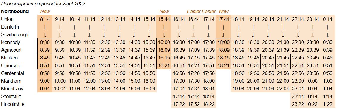

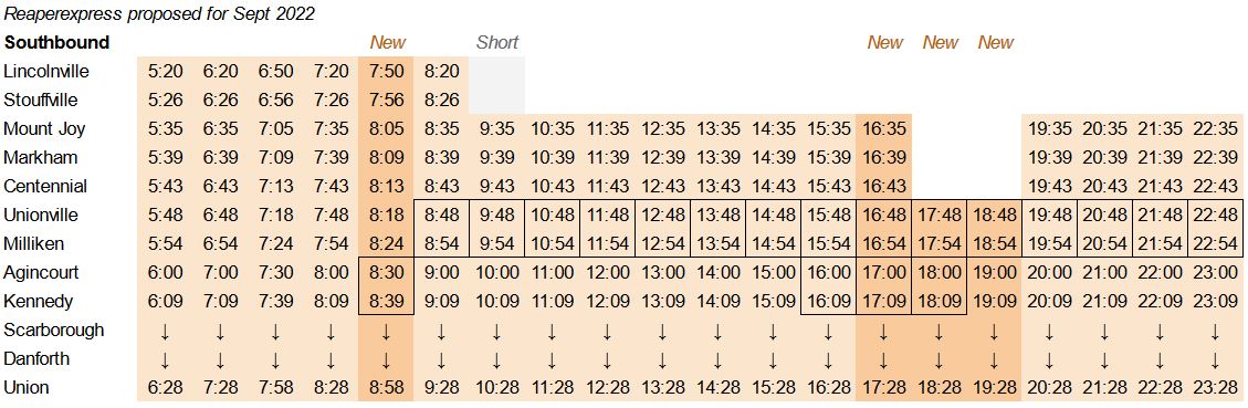

I did wonder about the fact that the schedule limits the PM Peak frequency north of Unionville to hourly. But I think that Metrolinx might accept it given that:
- They have been extremely reluctant to reintroduce the September 2021 service levels anyway
- The limitation would only exist for a few months from the intoduction of counter-peak service until the completion of the Highland Creek bridge. At that point it would once again be possible to run more more than 2 tph in the peak direction, enabling 2 tph to Old Elm plus 1+ tph turning back at Unionville.
Here's an updated concept which improves the peak frequency north of Unionville by storing one train at Unionville for PM counter-peak service.
I don't think they would store a second trainset at Unionville for two hours, since it is an inefficient use of resources, it could potentially obstruct the southbound trains at 15:48 and 16:48, and Metrolinx doesn't seem to be that bothered by the massive gaps in counter-peak service. The aforementioned September 2021 service also had counter-peak service to/from Bramalea, and that still hasn't been restored despite the track capacity already being available for an elegant service pattern.

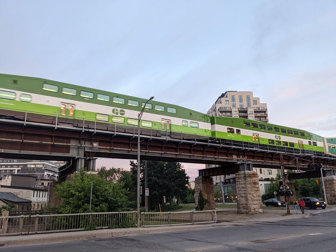

^ Awesome shots!
Thanks! That was my first time to the top of all my time living here, and realised there was a great vantage upon the tracks from up top (which my phone would fit through!)
Ill be back when more progress occurs, as other than on the platforms its a great vantage of the work without breaking any laws.
Speaking of, a minute before taking this photo some guy was taking photos of the river right up there on the bridge. Its crazy people don't bother to check the schedules at least.
The completed new beams here are ready for tracks on this side, hopefully happening soon, I've always been fond of this bridge into Guelph, great views from the ground and on the train.
