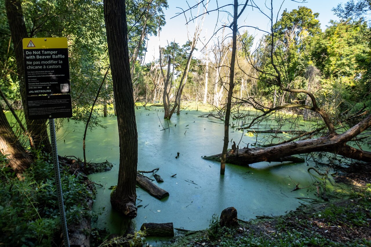

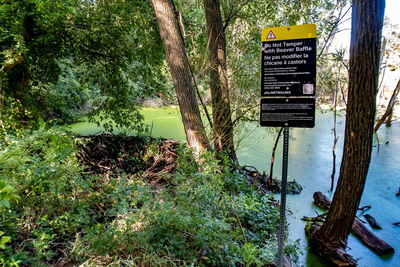

Saw this Metrolinx sign on a ride this morning. :)
