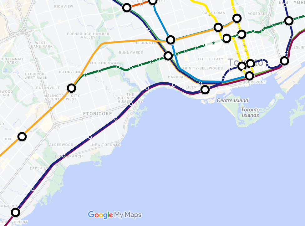

But you guys understand what's going on here with this Lakeview station? Doug didn't agree to build this station because he cared about offering transit to the people in this neighbourhood. His developer buddies want to use the tax payers to fund a GO station to be constructed in this area so they can mark up the homes in this new master planned community on Lakeshore.
The only exception to this I can think of is maybe Park Lawn
Let’s not forget Park Lawn GO and the Humber Bay area are extremely similar to the Lakeview development and its proposed accompanying station. The population of the entire Humber Bay Shores neighbourhood is 39,186, and the population of just the Lakeview development on its own, not including the existing neighbourhoods nearby, will be 40,000.
Should we drop Park Lawn and only have Mimico?
City Place in Toronto only has 18,000 residents (based on 2020 numbers), should we drop Spadina-Front because Union is close enough?

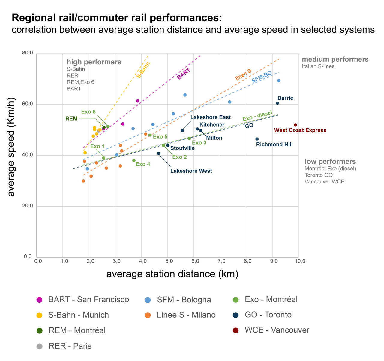

I support electrification and a more frequent go service, but we really need to not fall into the fantasy that electrification and signalling is a magic bullet that can transform LSE/LSW into everybody's favourite subway system with stops spaced like the Yonge subway.. . GO should be left as a regional system with measured station spacing capable of competing with longer distance highway travel, and we need to build higher order transit for those first/last mile legs and to meet local needs.
GO is slooooow, with terrible performance of huge, underpowered trains the culprit. Modern electrification, trains, and signalling as on the Munich S-Bahn delivers higher speeds than GO with triple the stations. Not quite a magic bullet, but certainly reason to jettison reflexive opposition to infill stations.
Doing a bit of spot-checking. The average station distance for REM is 4.2 km, not (about) 2.6 km. That does put that graph into question. (though I suspect that the general trends are correct).
