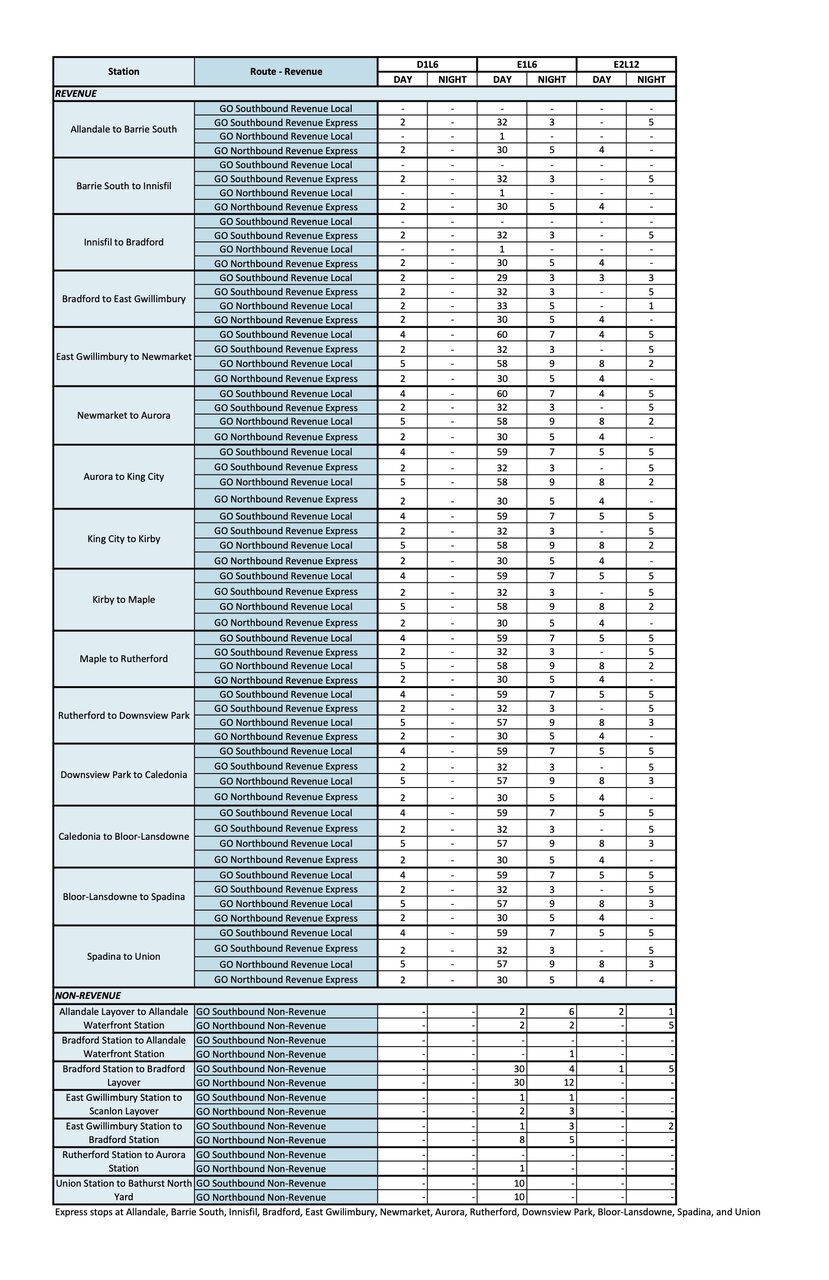

The detail on LSE is bizarre. On Page 55 they specify 95 revenue diesel hauled trains per weekday, plus 70 non-revenue diesel hauled trains. That's almost one non-revenue move for every revenue move.
But then, Barrie (pg 52) specifies 232 revenue electric trains and 130 non-revenue electric trains. Won't the folks around the Davenport Diamond be thrilled to learn that a third of the trains traversing the new flyover will be empty!
I was going to respond about the Stouffville number with a sarcastic "Must be Smart Track". But maybe that's the reality?
If you look at the Appendix G -Noise and Vibration Modelling Reports in here, you will find the ultimate capacity schedule. A large portion of non-revenue trains in the barrier line are to and from Bradford GO and Bradford layover, and between Union station and Bathurst layover.

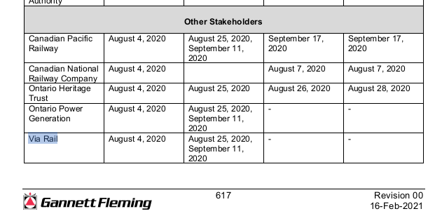

^ I didn’t see any mention of VIA other than on LSE (via Oshawa) and Kitchener (4 trains only). The report claims to be consulting VIA regularly but there is no provision for HFR in the Stouffville line, and the Kitchener number is downright pessimistic. If ML has any inside info on HFR they aren’t saying.... routing HFR via Kennedy would make a material difference to the noise/air quality data on that line.
From what I understand, the HFR is supposed to be routed through the Don Valley bridge and the CP rail corridor. The problem there then lies in the fact that with the Don Layover Facility, GO is basically planning to park trains in front of that bridge. Ultimately we don't know the route HFR will take, and it can go either way.
I don’t know either - certainly the announcement of the Don Valley layover yard is a bit of a poke in the eye to VIA - I do believe that the agencies talk more than we may give them credit for, so I’m sure they were forewarned.
Either way, an EA is supposed to rough in alternatives so these can be advanced when the time is right ML’s giving VIA no planning credit on its EAs on the Stouffville line, while taking away the Don Valley option, is not exactly leaving any doors open.
Possibly ML was giving VIA a prod, or they are sick of Ottawa dithering on the HFR decision and will let VIA do additional study at their own expense
when they are ready. Either way, this is hardly good integrated transportation planning.
There's also been speculation that HFR would use the Stouffville Line. Could have some benefits over the Don Valley option.

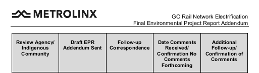

If you look in the 798-page addendum, there are references to meeting with VIA Rail.
Ah....Looks like trains turning back at Bradford will spend time in a layover track, rather than just reversing from the station platform. That layover counts as a non-revenue move in each direction.
Both the Barrie and the Stouffville charts identify both "regular" and "express" trains. I wonder how that will work.
On Barrie there are long-term plans for limited three-track sections. Perhaps those long-term plans are no longer so long-term.
With some not-so-careful planning it is not difficult to mix all-stops and limited-stops trains on the same line with no overtaking sections. Whether Metrolinx has the wherewithal to pull it off successfully, however, is another question. They can't seem to operate a mixed service with UPX and the Kitchener line on 3 tracks, and there are no overtaking moves there.
