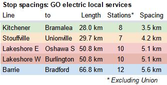

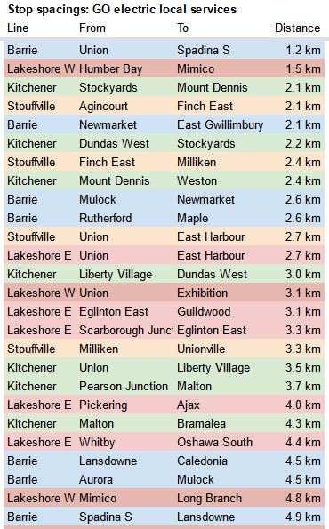

The suitability of loco-hauled BiLevel trains is heavily affected by the stop spacing, since they have fewer doors per passenger than single-level local trains.
So I decided to measure the stop spacings of the planned 15-minute local services, including the planned stations.
Of the 47 station-to-station distances, 26 are under 5 km:
The lines with the shortest average spacings are the Kitchener and Stouffville lines, which are likely going to be interlined with each other. This suggests that if DB were to purchase single-level EMUs, they would probably provide the most benefit on the Bramalea-Unionville local service.
Not tight, perhaps by the time we need emus we will also feel like adding a bunch more infill - which then won't have a huge time penalty
