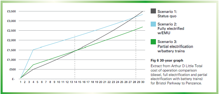

Great Western Rail released a white paper "
Fast-charge battery technology: A viable option for regional rail?" discussing their experience running this class 230 unit and research by Arthur Little. They suggest that partial overhead electrification of tracks with fast-charging of large amp-hr train batteries (at stations) would be a cost effective alternative to full electrification, for the 158 miles (255 km) UK western mainline from Bristol to Penzance. For reference, the rail-distance between Bramalea and Kitchener is ~75km.
Great read, some other highlights and a few of my thoughts below:
It looks incredibly cheaper in the upfront infra costs, although this study was done by retrofitting trains with electric motors already fitted. GO trains would need to fit batteries and electric motors, or entirely new cars.
(Note: this was tested on a 2-car train, hence 84x3x2=~500)
Obviously a lot of factors at play for power consumption but for fun if we assumed similar conditions (7km/minute charge), you could yield something like the following:
