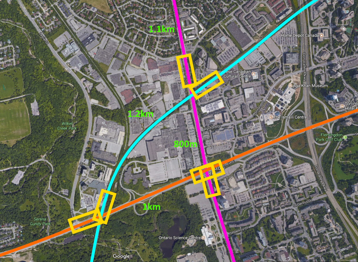

From what I have seen, it appears that the assumption is a midtown train would stop at Eglinton, where passengers could transfer to the Crosstown via steps to the Leslie stop. Is this preferable to trying to make a stop at Don Mills and making a connection to Relief Line North?
Perhaps some people will get their wish on the DRL-Long and we will receive a station at Barber Greene Rd on the Relief Line.
I wouldn't be opposed to that idea, as by then I imagine Barber Greene area will be receiving development pressure, it would be 1km north to Lawrence and 800m south to Eglinton - adequate stop spacing, and an interchange with the Midtown Corridor would warrant the station.
The question is, if a stop at Barber Greene and at Leslie (1km) be too narrow stop-spacing for the Midtown Corridor.

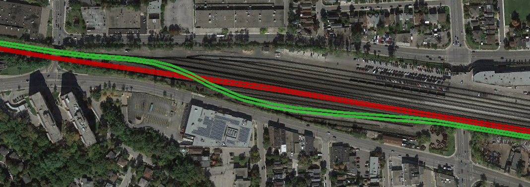

As it stands today, GO trains will run on the south side of the current CP tracks from Lambton Yards to the west of CP Agincourt Yard.
I stand to be corrected, but didn't Metrolinx buy tracks on the north side of CP Agincourt Yard a few years ago. If so, a fly-under will have to be built west of the yard to get to those track.
A fair number of current crossing would have to be close or grade separated to meet the plan 15 minute service on the line. A lot of noise walls will also have to be built.
When I did my fantasy track map for the west half of the Midtown line, I showed the flyover/under being around the Humber River, but the west end of Lambton Yard is an even better location, with lots of underutilized wasteland:
Well I highly doubt both stops will be justified on the Midtown corridor, when making the transfer can be done. That's why I framed it as one or the other. I don't dream up SmartTrack fantasies.

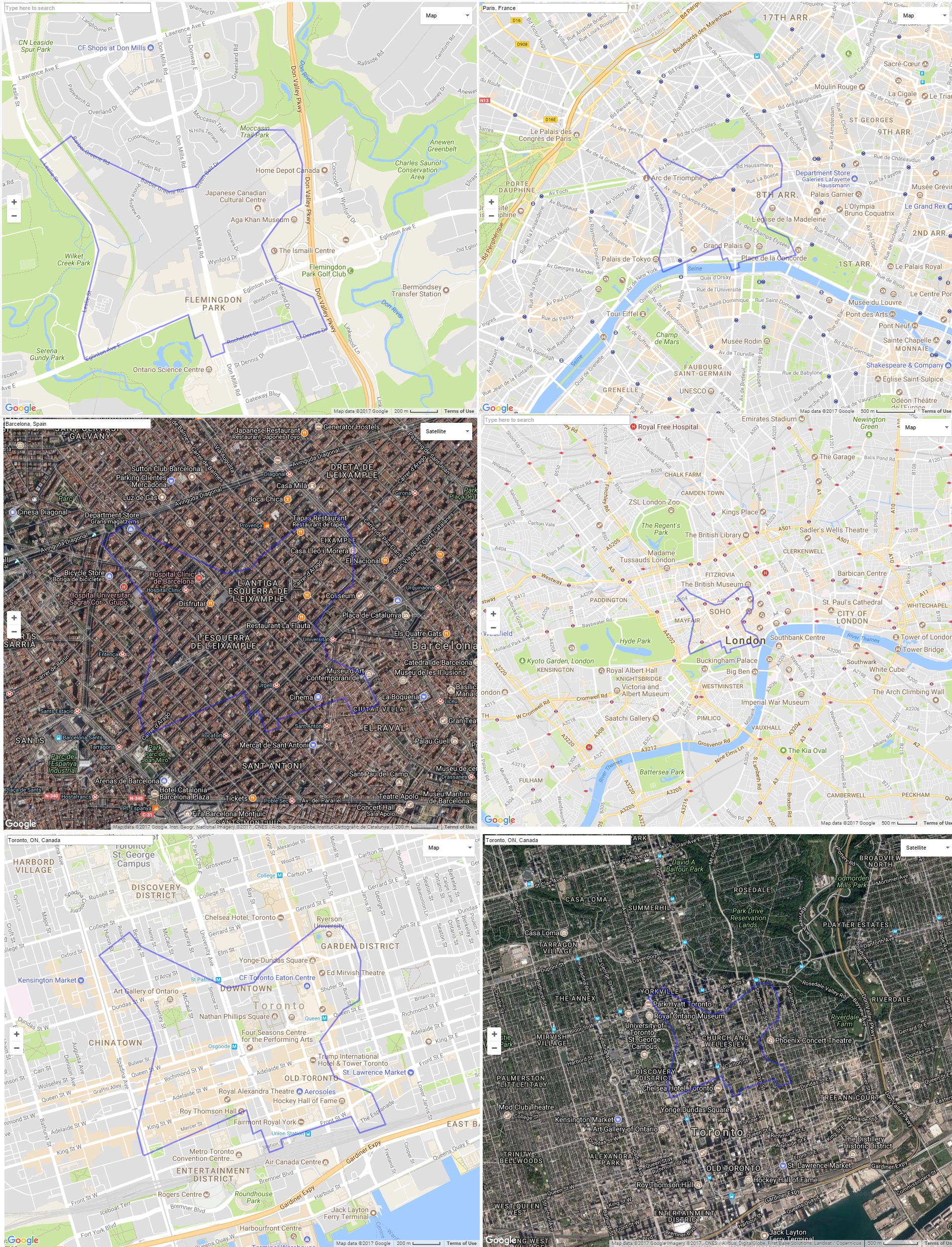

In a transit plan like that, we really should be thinking of how to build optimal levels of urban employment and population densities. This is not a tiny piece of land we are looking at here. Consider:
If there is anywhere in the city to consider creating a regional sub-centre from scratch, it would be at Eglinton and Don Mills. Especially if the Midtown Corridor is activated, and the Relief Line North is built (thus connecting here with the Unilever site and Downtown).
Maybe we do not need two stops at both Leslie and Barber Greene. I think if someone is heading to Yonge on Eglinton, a one-stop transfer from Barber Greene to Don Mills while not optimal, is not a deal-breaker.
Wow, that is some serious context, thanks for that overlay!

As for Humber River crossing CP, it was proposed as a fly-under which is more costly and time consuming than a fly-over. A fly-over would work there fine and done a lot faster.
