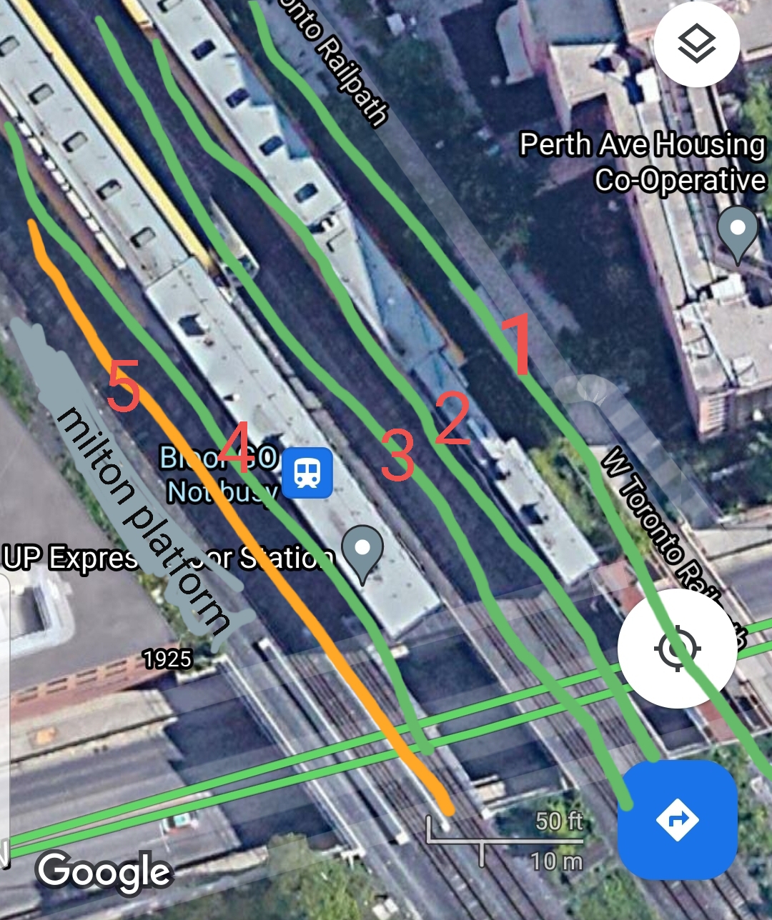

Isn't the speed limit through the curve from the Weston Sub to Galt sub at 30 mph? There is already a Crossover there but it's for track 6 to track 5. The only viable option I see is to put a side platform on the west end of track 5. However I don't think metrolinx thinks it's worth the cost and I think they probably want to double track the milton line track through bloor station, making it 6 tracks
Isn't the speed limit through the curve from the Weston Sub to Galt sub at 30 mph? There is already a Crossover there but it's for track 6 to track 5. The only viable option I see is to put a side platform on the west end of track 5. However I don't think metrolinx thinks it's worth the cost and I think they probably want to double track the milton line track through bloor station, making it 6 tracksView attachment 357816
There are two curves on the connection to the CP trackage - I don't have track maps for them, but I seem to recall that the inner curve is good for 20mph, while the outer is allowed 45 or 50mph. Yes, they currently combine back into one track around the Wallace pedestrian bridge.
The long-term goals for the GO-owned stretch of that track are to have it 2 tracks all the way down from The Junction to Strachan/USRC. This would allow for the largest amount of flexibility in scheduling and hopefully help prevent delays on the CP-owned track for when the time comes to start runnning bidirectionally. And doing so would preclude the installation of a platform at Bloor unless a not-inconsequential amount of land is purchased on the west side of the corridor.

If they really wanted a Milton platform at Bloor GO they could rebuild the westernmost rail bridge over Bloor to have space between track 5 & future track 6 so an island platform could be built directly south of Bloor with an overhead connection.
