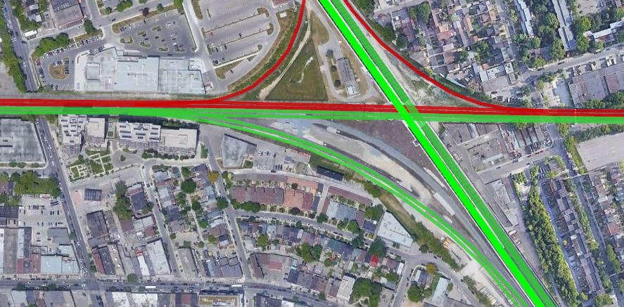

In any case, I think it would be fairly straightforward to implement all-day two-way service on the Milton line, since the corridor seems to be future-proofed for 4 tracks. Many of the bridges are even built for 4 tracks already. The main challenge is that there will likely need to be a rail-to-rail grade separation to bring GO across the CP tracks somewhere between Kipling and the West Toronto Diamond. At West Toronto Diamond, GO splits off to the south, but the Milton yard and all of the station platforms are located on the north side of the corridor.

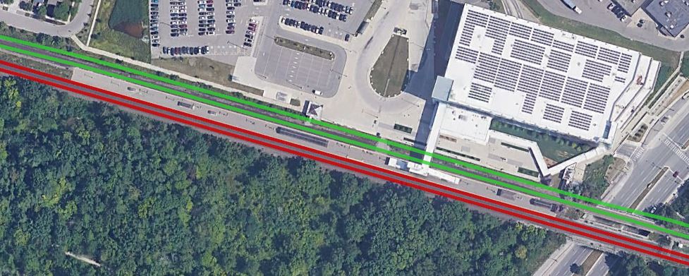

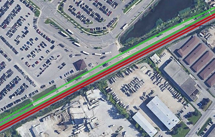

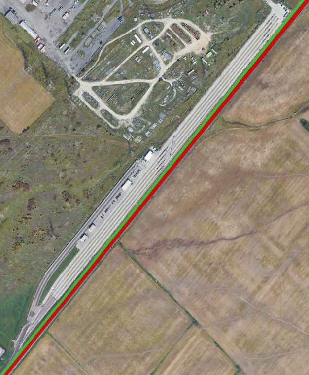

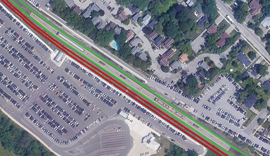

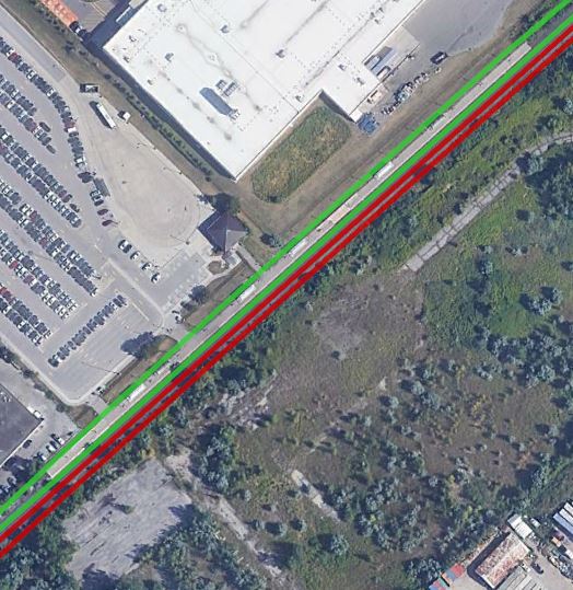

Here are some overhead views where I've sketched in where I think the 4 tracks would most easily fit. Note how all the platforms are on the northern pair of tracks.
Kipling Station (all of these tracks are existing)
Dixie Station (new track on the north side)
Cooksville Station (new track on the north side and south side)
Erindale Station (new track on the north side; new side platform)

Milton station (new track on the north side)

Yeah, I just showed a full 4-track configuration as a full build-out scenario. Certainly a phased approach could start with only the segments required for whatever the initial two-way service is. Another idea is to double-track as far as Cooksville (including the grade separation east of Kipling) and run 15-minute service that far (possibly with hourly service continuing to Milton), and gradually extend the dedicated pair of GO tracks further west, bringing the 15-minute service with it.
For hourly you only need to do this at Milton, Erindale and Cooksvile.
You’d still need the flyover. The challenge is the underpasses at Keele, Runnymede, Jane and Scarlett. And the yard ladder at the west end of Lambton Yard. And the Humber River.
It will have to be a flyover, Davenport style.
